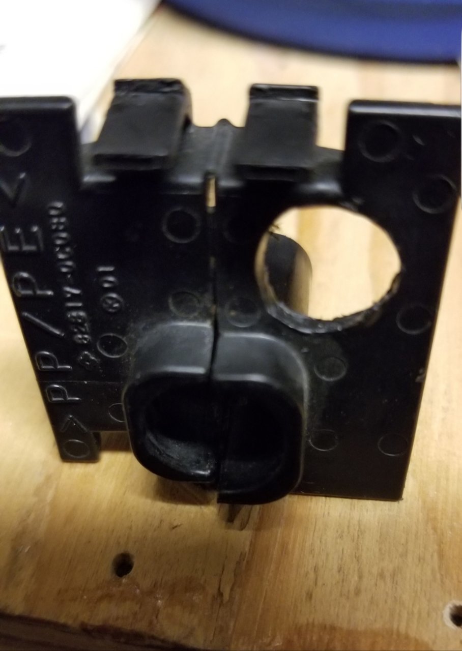

    I drilled an extra hole in both grommets. I think they are made with 2 holes also but I'm not sure how to get them.20190302_001552.jpg

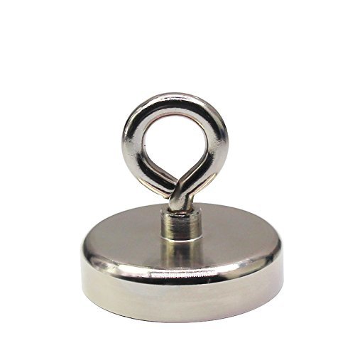

    I guess instead of drilling into the sheetmetal, you could bolt it to a rare earth fishing magnet. Unscrew the eye bolt and replace with a regular bolt holding a plate to screw the actuator to. 400lbs of force so it ain't gonna move on you.

    That's 400# in tension, Not shear, plus the diameter on a magnet that big must be huge. Look, I'm not worried at all about drilling / cutting my truck. I just had the wrong impression in my mind when ordering, that's all.

    So I ran the wiring through the camera loom. I had to cut the loom open to get the wire in it. There is a double loom used. A small loom with the wire in it and a larger loom that the small one goes through. The larger one is mostly where the loom goes through the brackets on the tailgate and body. I added a connector near the camera connector too.
    I also soldered a ring on the actuator rod and slipped that over the plastic part that the lock mechanism attaches to. I removed the lock so that I could put the ring below it. That way the lock will hold it in place.
