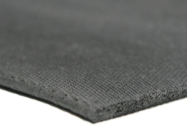

    The rubber that I used looks like this and is 3/16 thick. I used a piece that I had laying around.
    I did not buy it from this site but it looks exactly the same. http://www.rubbercal.com/industrial-rubber/foam-sponge-rubber/open-cell-rubber-blend.htmlquare tu
    The square tubing came from a steel supply. Usually easy to find. I think Lowes and Home Depot carry it too. Its a lot cheaper at the steel supply.

    In my opinion the open cell is better because closed cell will be too solid and may not be as quiet. I am no expert but it seems to work.
    I lined both sides of the tubing above and below.

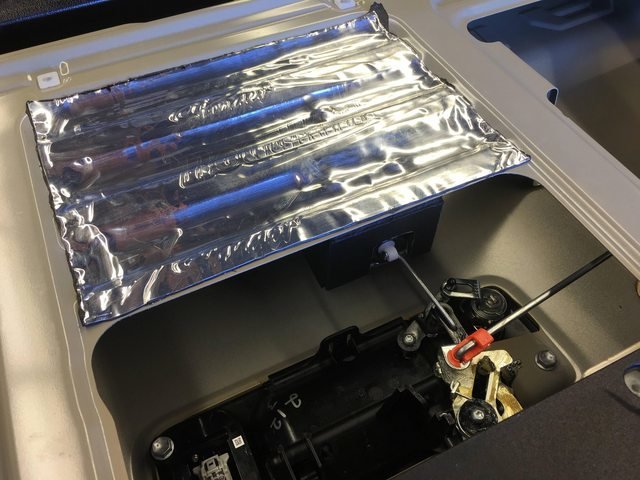

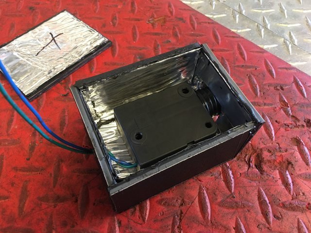

    I did a write up ages ago. Built an encloser for mine, layered it with dynamat. Also the tailgate skin as well.
    Not noisy at all. Without it.. it just sounded cheap. CLUNK
    Works flawless to this day ~3 Years

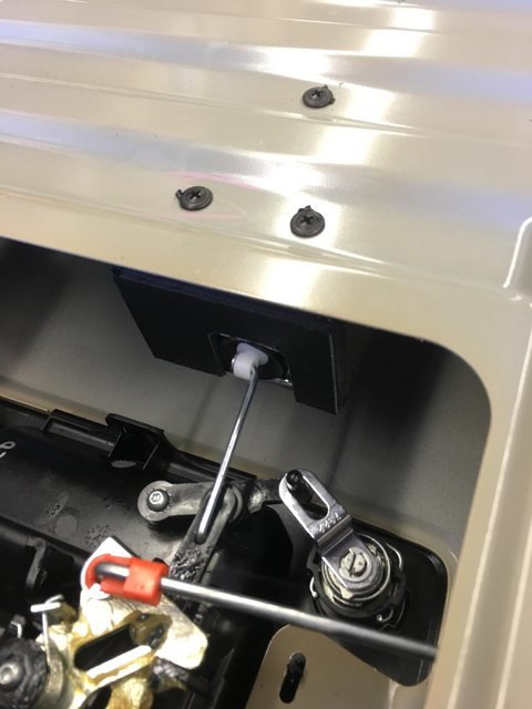

    that's a very clean install......i like the fact that the distance between the actuator loop and the locking mechanism is very short....make more less stress and more direct force towards the lock and less movement from side-to-side......does the aluminum sheet go over the opening above the lock?......and last question, why did you not solder a ¼" ring tab on and connect to the black nipple instead of drilling hole where you did......cont criticizing, just trying to get an idea of installations before i get my kit
