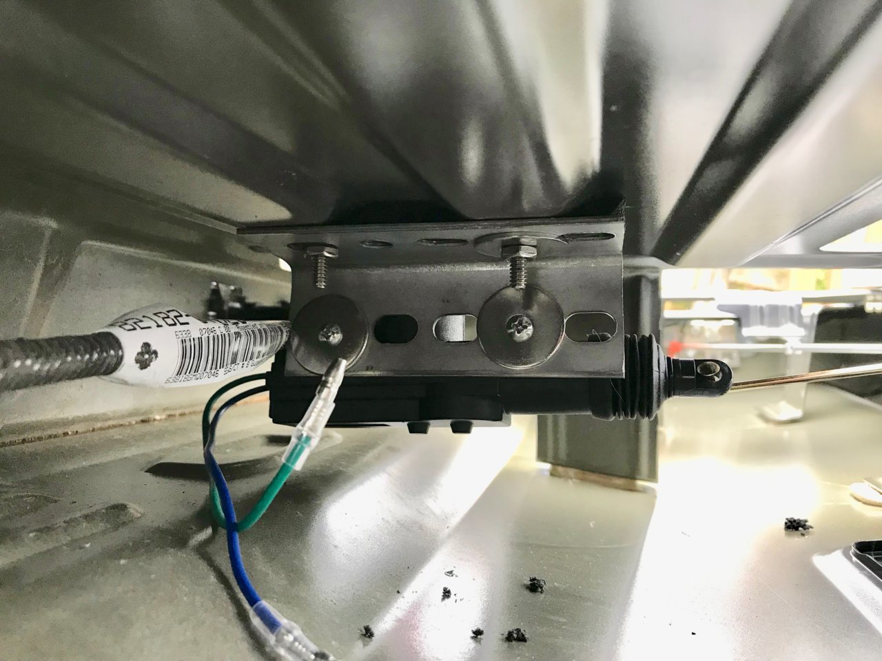

    Just a few of notes from my install that others might find useful.
    Mounting the actuator: I mounted my actuator with 1 inch piece of angled steel with a 1/4 inch piece of weathering stripping between it and the tailgate (photo below). This seemed to work out pretty well and it allowed me to adjust the how far the actuator sat above the tailgate without taking everything apart. There are also some nice alternatives that others have mentioned in this thread as well.

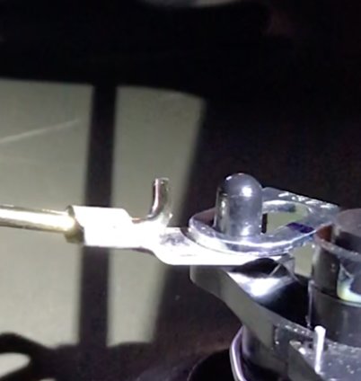

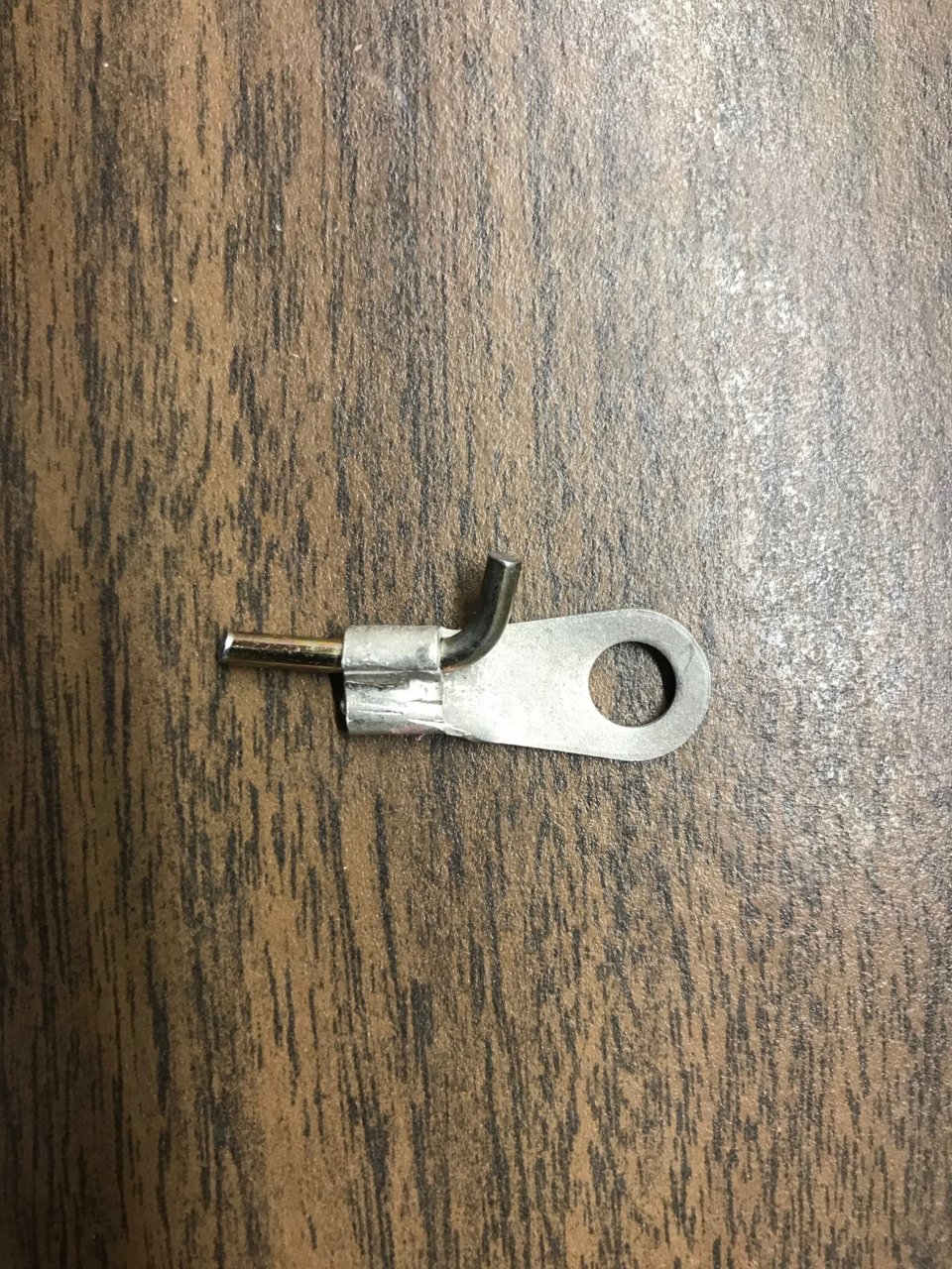

    I made a right angle bend in the actuator rod, crimped and soldered the terminal connection to the rod.
    Unfortunately I didn't take a great picture of it installed (the first photo below is a blown up image from the video in the post above). However here's a second photo of the piece I practiced on before doing it for the final install (Since the rod in the kit is much longer than what you need, I practiced making the attachment with the extra length I had).
