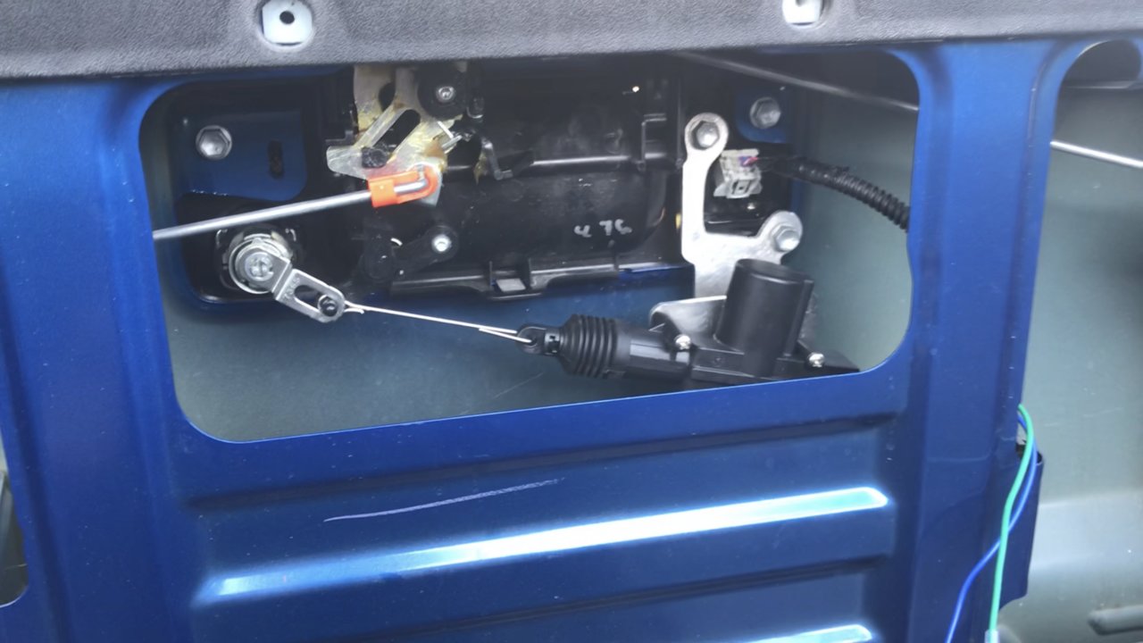

    I designed a custom bracket to mount 100 percent bolt on and no drilling holes in my truck . Using 1/8 aluminum for extra strength .I used the bolts that hold the rear camera as my mounting points . Made a stainless steel rod cut and bent to the right size to make it all work flawless .Plan on painting it black to make it look like a factory part . Might make a few more brackets If people are interested .04828C20-89E4-4261-BF4D-BE99B08616D5.jpg

    I'm also interested! Always prefer options that don't require any permanent modification of the truck.

    That was my thinking about making something that can be removed or modified if you have to . This first of all wouldn’t be possible with out the start of the full kit I ordered .

    With the actuator coming from the side it pushes the lock up and down?
    I would never have thought to mount it like that.
    Nice engineering.
