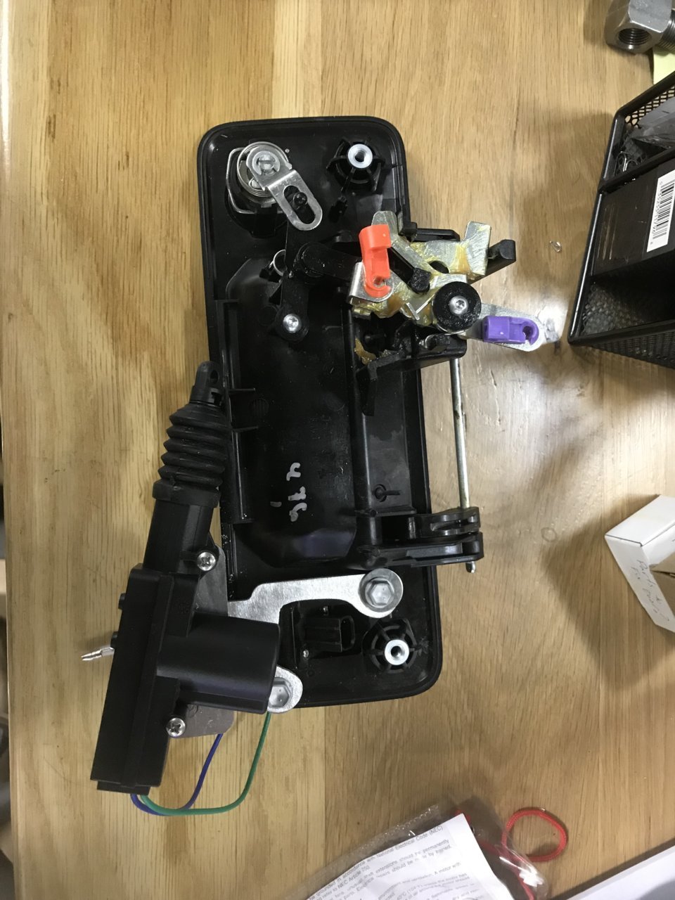

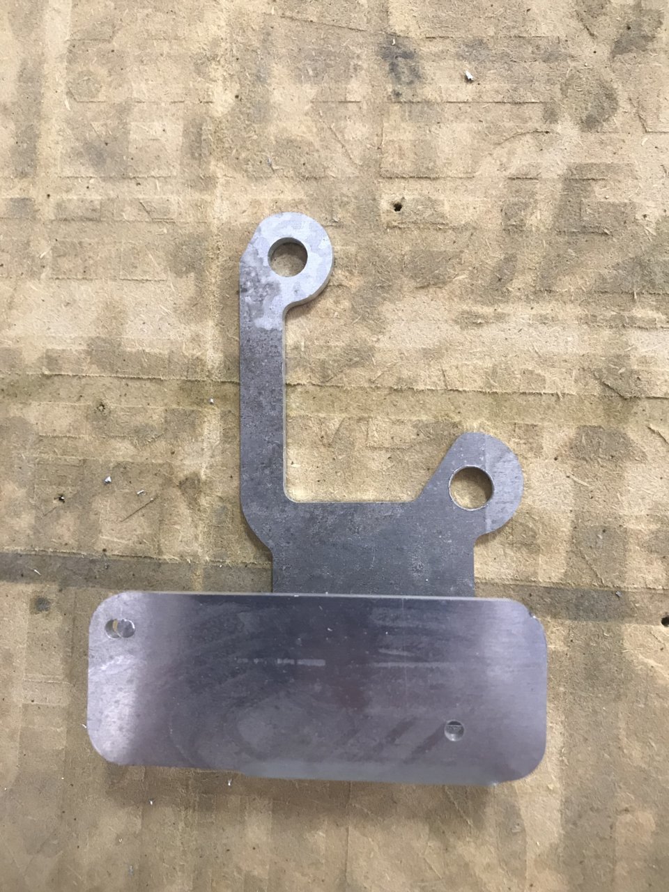

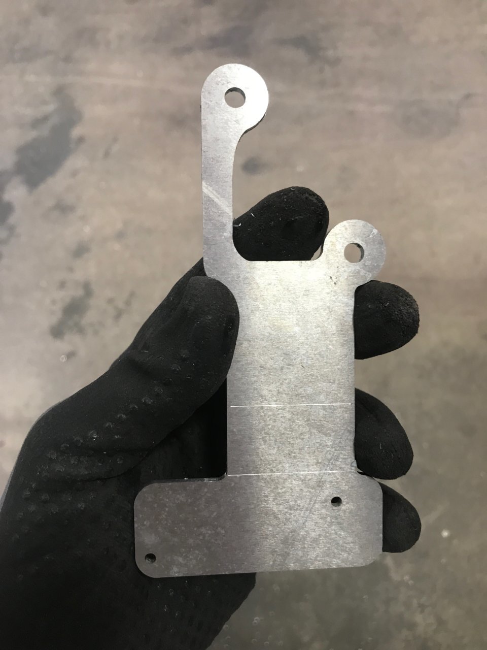

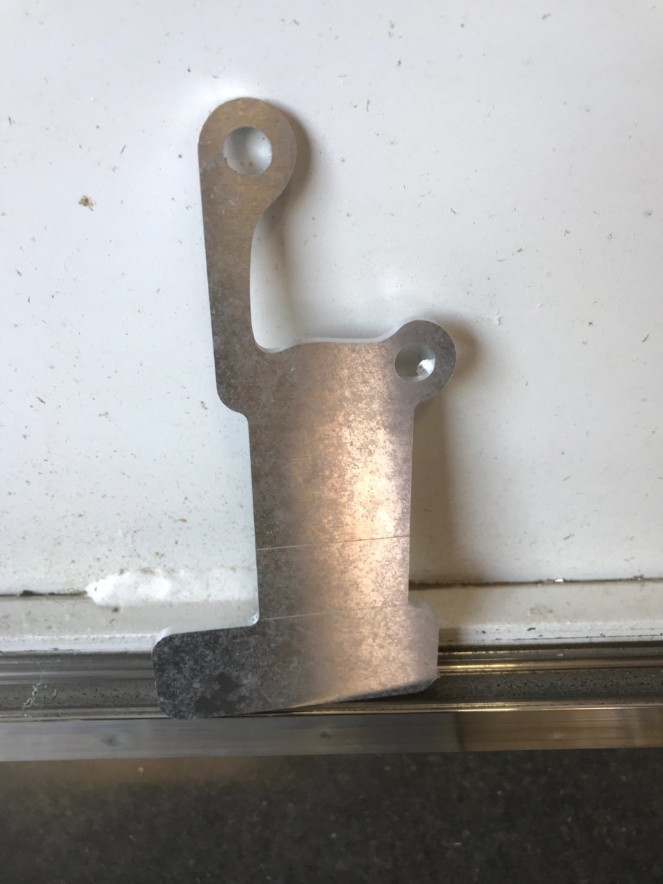

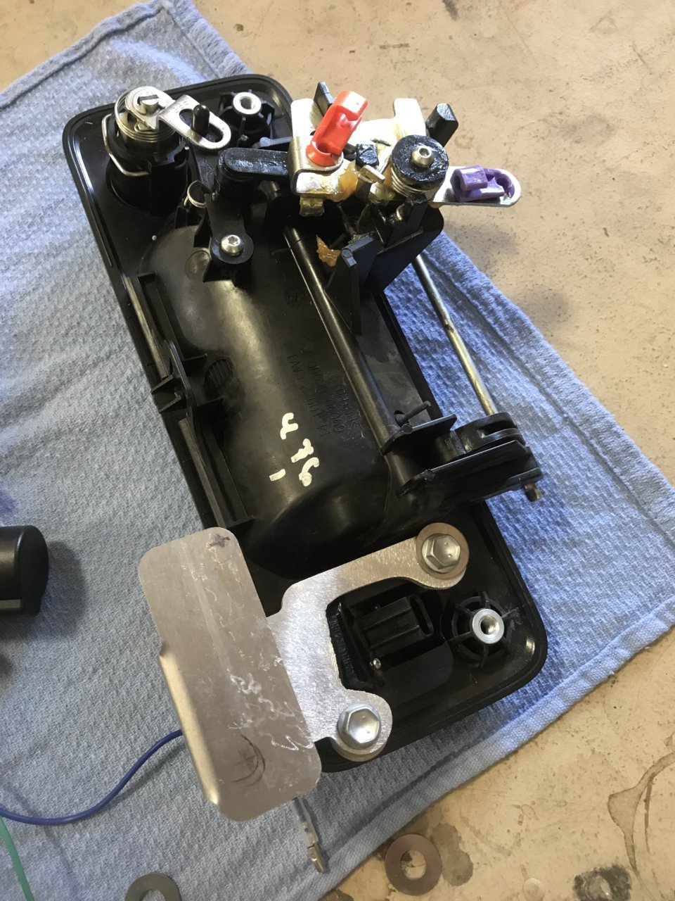

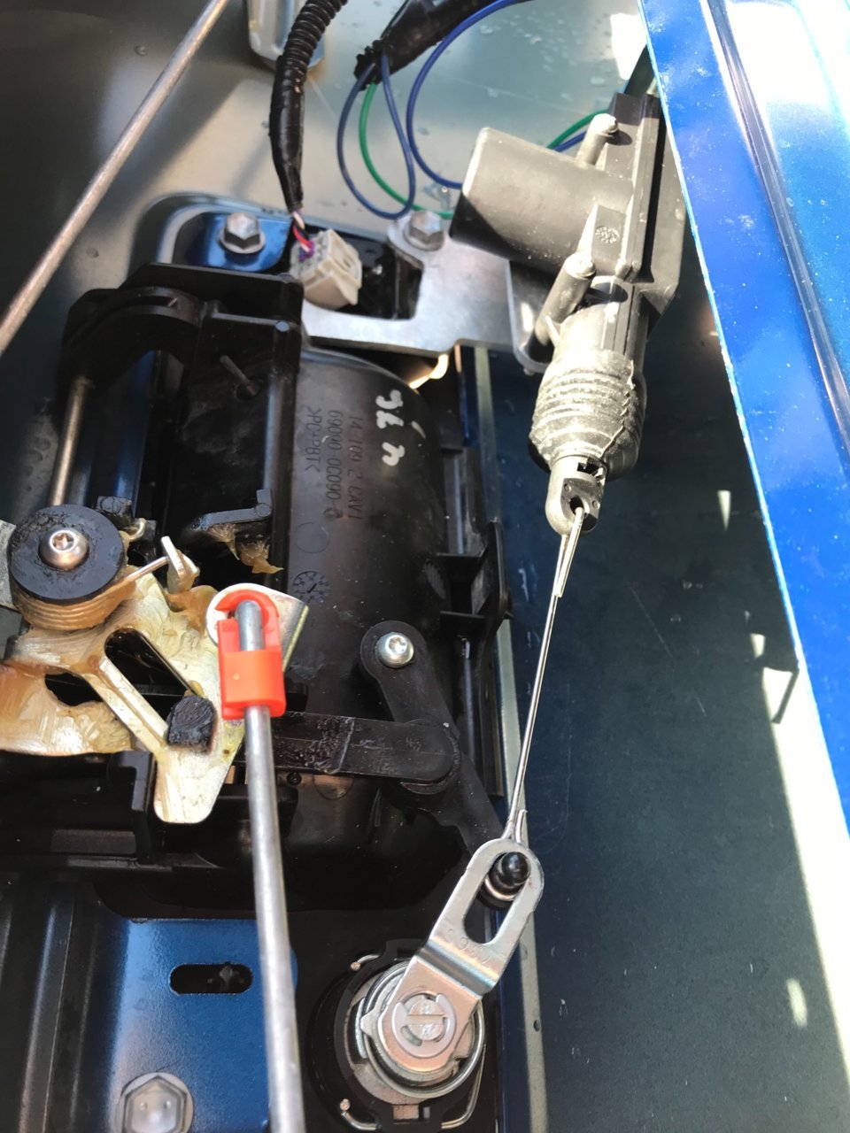

    UPDATE:
    Just as I promised, here is the New Release for the Bolt-N-Lock Bracket & Rod!
    This community is GREAT! What one doesn’t think of, another does; and, what another does, the other doesn’t. This Kit I can say is NOW 100% COMPLETE - Thanks to @tacodnr!
    PURPOSE:
    The purpose of this Bolt-N-Lock Bracket & Rod is to bring more functionality and conveniency to your 3rd Gen Toyota Tacoma Full Tailgate Pop-N-Lock Harness Kit. This is accomplished by a specifically designed bracket and rod that bolts on directly to your OEM Rear Camera with No Drilling. Yes. No Drilling!
    PRODUCT DETAIL:
    Custom bracket is made out of 1/8” aluminum for extra strength. Bolts are the OEM Bolts that Toyota provides for you :D As for the custom rod, it is made out of stainless steel and hand bent to the right size to make it all function flawlessly.

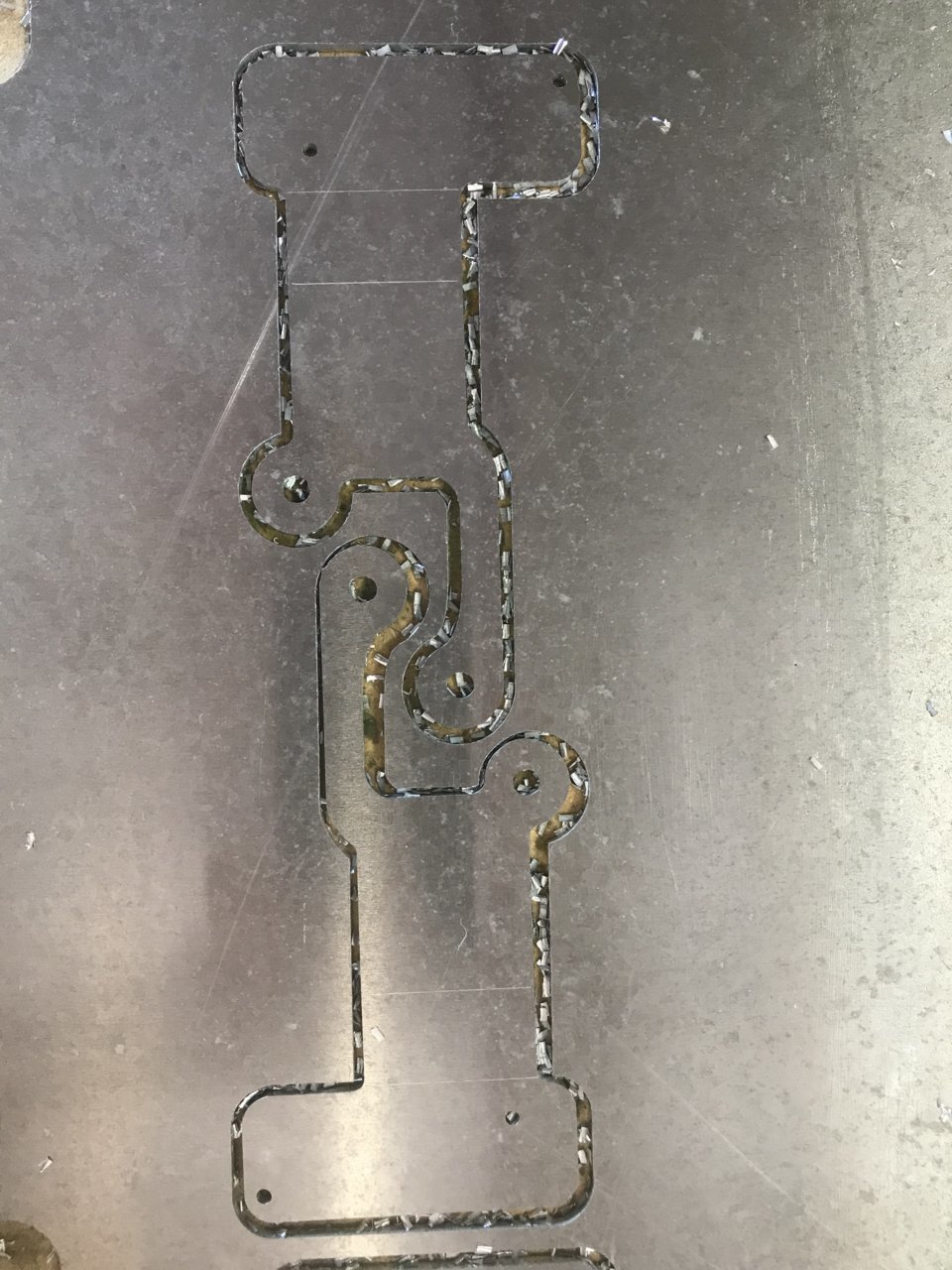

    That forth pic concerns me.
    I know from experience that 1/8" aluminum doesn't bend to a 90* angle well without stress cracking.
    Looks like that what you have there.
    I realize that there's not a lot of stress 9n the actuator but id be worried that that's a failure waiting to happen.

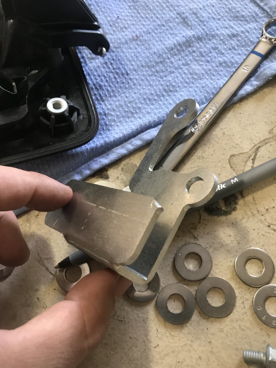

    I am using a softer alloy of aluminum that’s more bendable at 5052 and not 6062 . Bending it on a turbo bender one by one set for 1/8 . The production bracket has more room around the camera and less material on the bend line points .B020FBFD-D71E-44A1-83FA-EAB43DB6D1BA.jpg FFA13888-DEEB-4ECE-88A7-2723F53A2EE3.jpg

    That right there, is a thing of beauty!
    Glad to see that you thought of this potential issue beforehand.
