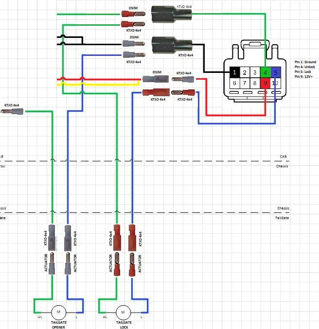

  17. May 5, 2019 at 8:10 AM
    #1457
    KTJO 4x4
    KTJO 4x4 [OP] Well-Known Member
    Oct 10, 2016
    #199424
    3,884
    Katie
    Oregon
    2017 TRD OFF-ROAD 4x4 DCSB BARCELONA RED
    Nitro 4.88 Gears OVTune 1.05 91Oct DirtyDeeds Exhaust
    Yeah. There will be ways. Here’s an idea of what I’m looking at for the new Tailgate Lock / Tailgate Opener Package Wiring Diagram
    The (2) Twin Bullet Connectors at the top that you see do not come on the PNP Harness as of right now because the PNP Harnesses were already being assembled at the time. That is something that I’m looking into purchasing to make it easier for everyone to make these connections. Don’t get misled by the wires being different lengths and going different directions. It’s a drawing. All of the wires will be going the same place, the Passenger Kick Panel.
    Changes Made:
    • You need 2 Actuators
    • You need 2 BNL - Bracket & Rods (Release of the 2nd BNL Coming Soon)
    Sneak Peak
    • Integrated Harness Pre-made Hopefully for Faster Shipping w/ some sort of distinction between Lock/Opener Mods because there will be 4 wires, not 2.
    • PNP Harness w/ GND, 12V+, LOCK, UNLOCK.
