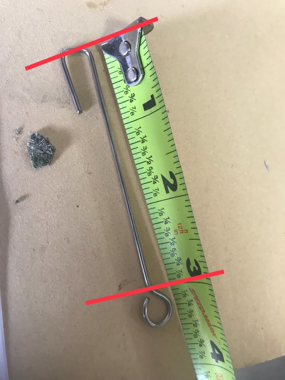

    Yes. I can go ahead and send you a new one if you do not have needle nose pliers where you can adjust it. Would you like me to send you a return label for the rod or would you prefer to just send me a picture of the receipt from the post off when you return the rod and I can send you a refund through PayPal?

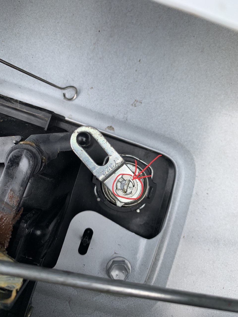

    Agh, this little crew broke while trying to unscrew it, anyone had this problem? Where can I purchase new one...? searched up but could not find anything.

    Which part broke? Sorry to hear this man. Easiest way on this section is to unscrew that little hex Screw and then pop off the black plastic section piece so you can slide it out of the locking mechanism and then slide the little rod over the top. Then you can put it back and then re-tighten the hex screw.

    Stupid me was trying to remove this one haha 6052CBF3-27CF-4641-86AB-AD75142860D2.jpg

    Oh man...:boink:I have no idea. Hopefully someone on here will be able to offer some assistance.

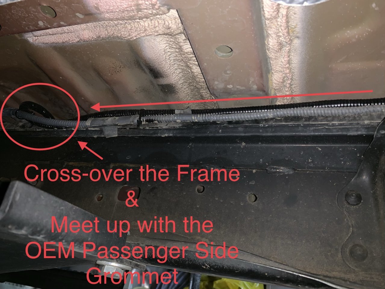

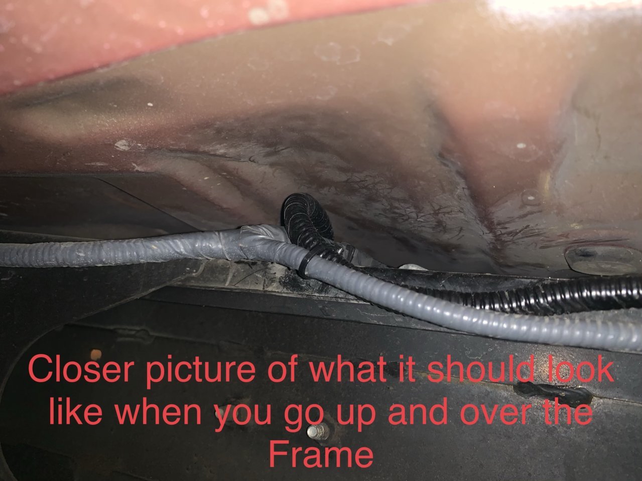

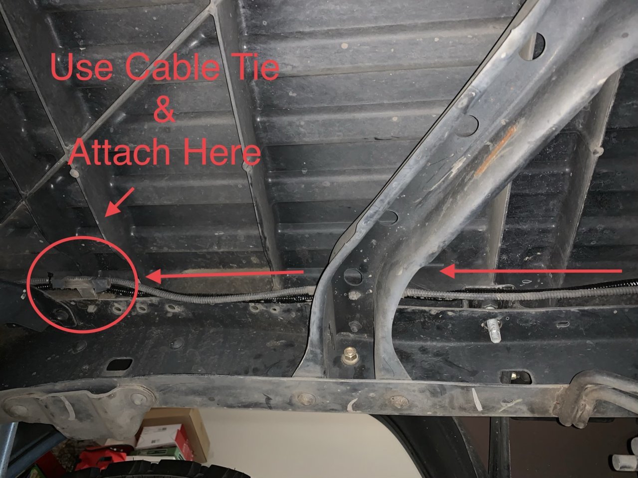

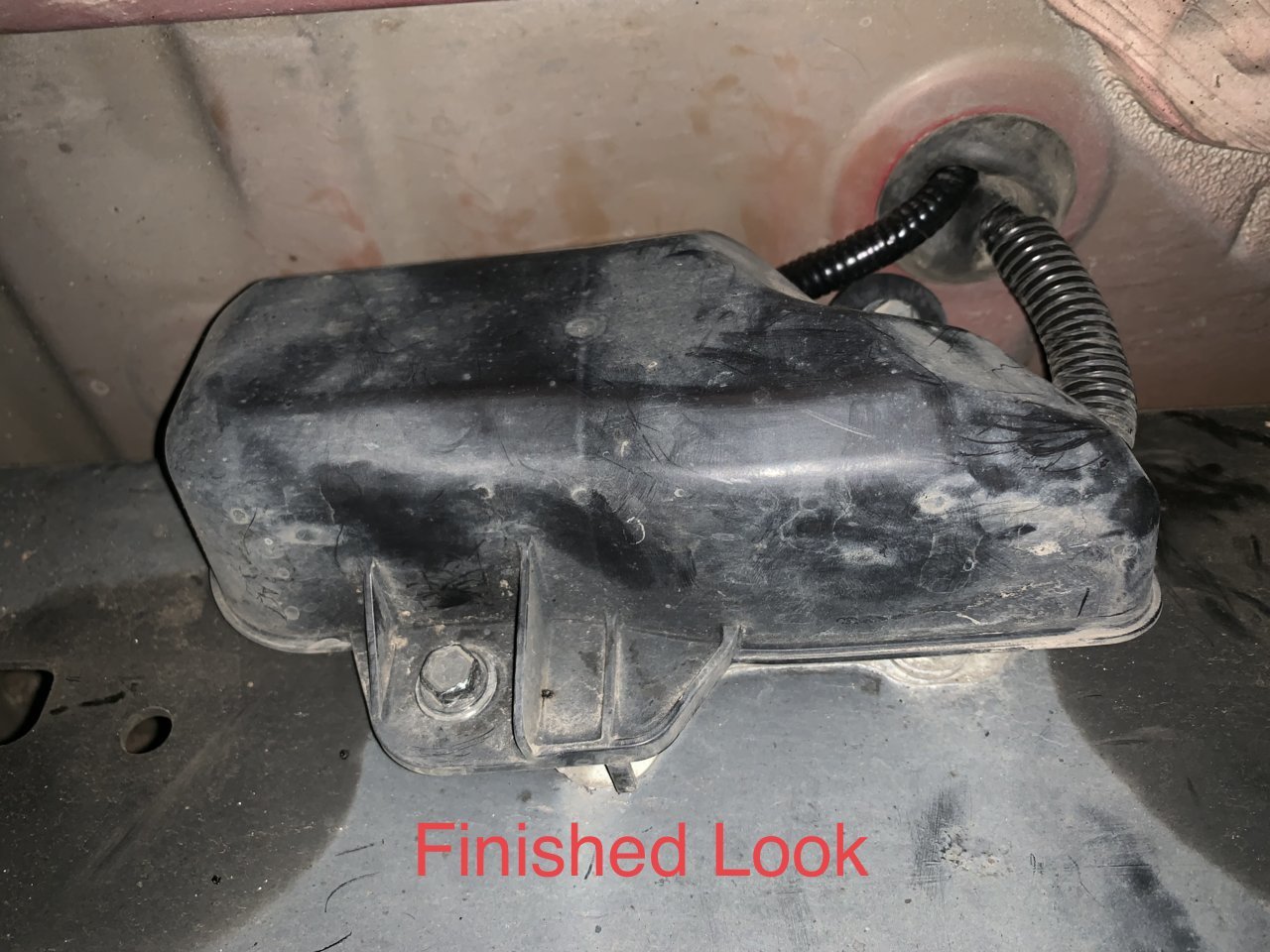

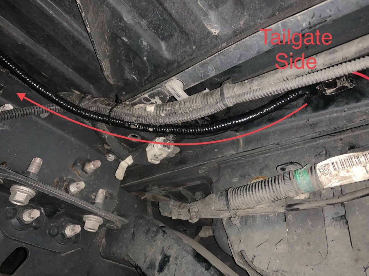

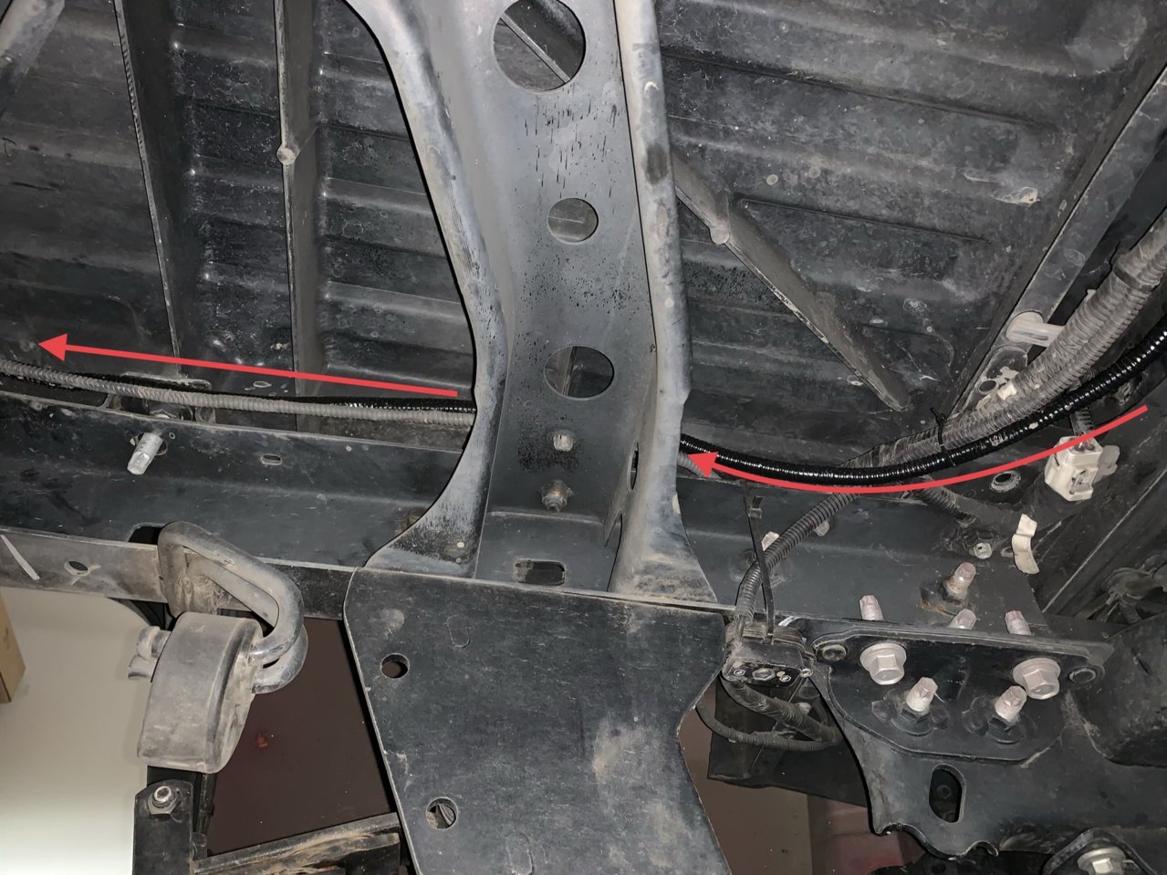

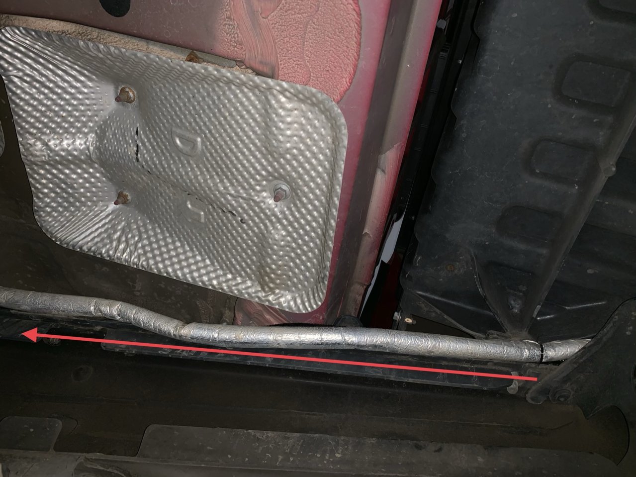

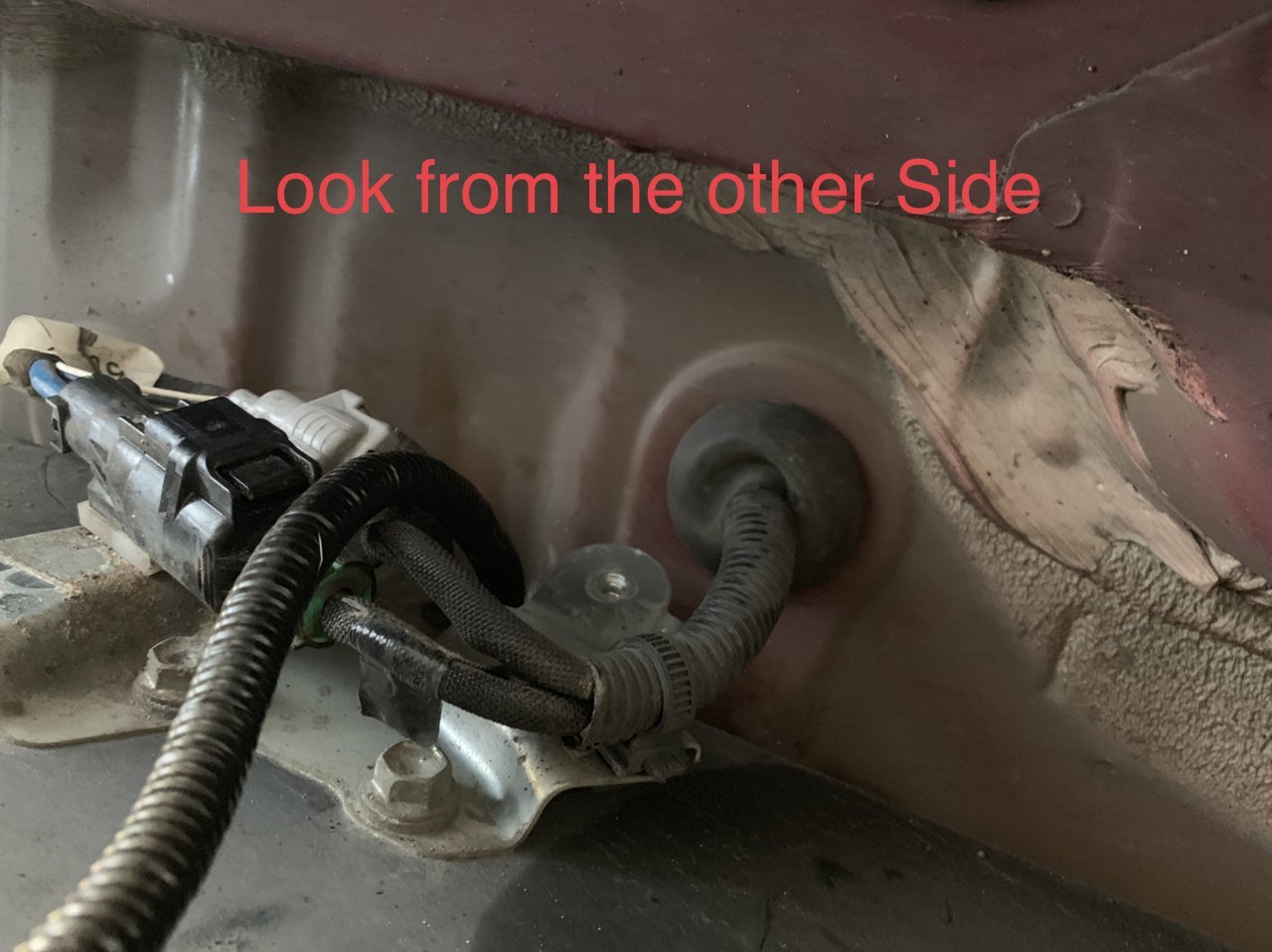

    Finally got around to installing but unfortunately the wire is about 8-12” too short? I pulled it as much as possible and the end of the wire barely reaches the bottom of the boot under the passenger side. I have a DCLB if that matters.

    2ft short???? If that is the case, I say take it off and send it back because that’s not right at all!!!!!
    You should be able to install the cable following the below path:

    Maybe its 8”-10” short? I don’t know. I will check again and take pics of how i routed and compare with your pictures

    Sounds good. Yeah this is the route you should have taken. Let me know
