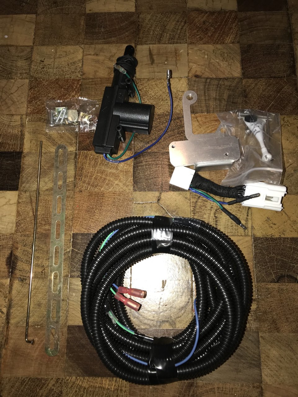

    Recieved mine and installed it Went in pretty well Had to tweak the bar on the actuator a bit, but other than that went well Didnt have a bunch of excess wire left over but had enough to make it and use the extension. Thanks again.

    Installed mine yesterday and ran into the actuator arm issue as well. Appears that the actuator end may sometimes leave too much play for the lock to move all the way to the lock position (mine made it about halfway). After bending it a few different ways, looks like the fix is to bend the “L” end of the rod around the hole where it attaches to the actuator, thereby minimizing play. My rod isn’t straight anymore and may be a little weaker due to the bending, but it does seem to work. This mod is a nice solution to what should have been standard from Toyota.

    I've finally installed my full kit but ran into a couple of issues--the length of wire from the actuator to the backup camera harness on the tailgate is a little short (based on the heat shrink spots to fit through the harnesses). I was able to get them plugged in but it was a stretch. Not that big of a deal but there is quite a bit of slack on the plug-and-play passenger side door end.
    I'm also running into the issue of the actuator bar not locking the gate. It will unlock every time but the angle or length is off. Does anyone have pictures of how they bent the bar to correct this?
