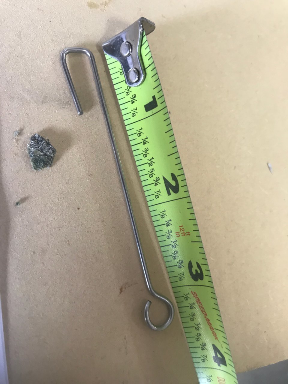

    Also interested to see what you did. My actuator bar was also too short and won’t lock the tailgate. Seems to be a common problem.

    I know it's been uploaded on here before but with this thread growing I have no issues posting it again. With the rod being made of stainless, you are able to bend it back and forth a few times without any issues. Here are the exact measurements you need for your rod to work...
    Hopefully you enjoy the Kit. Thank you!
