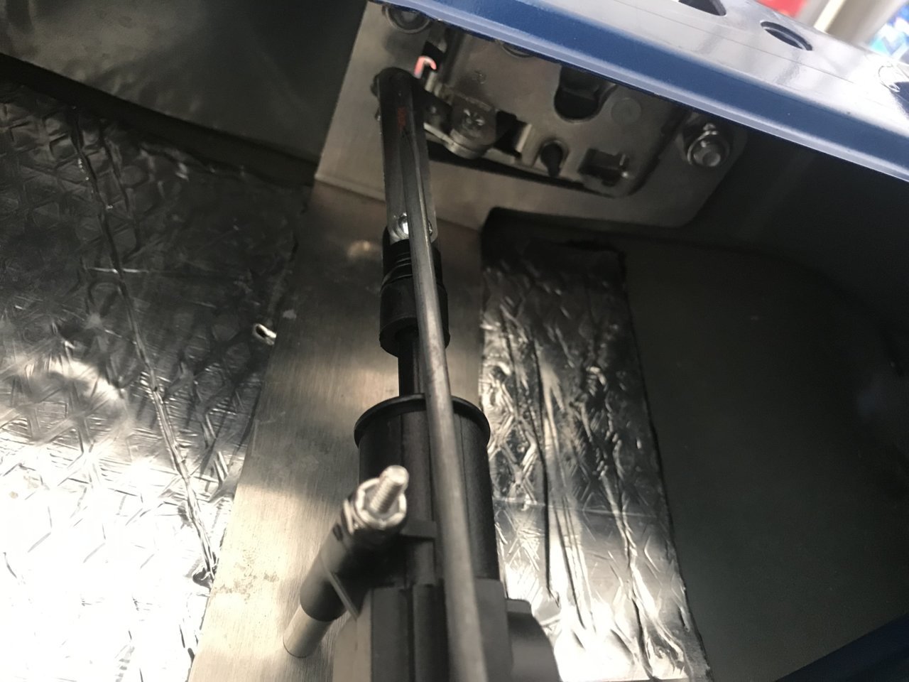

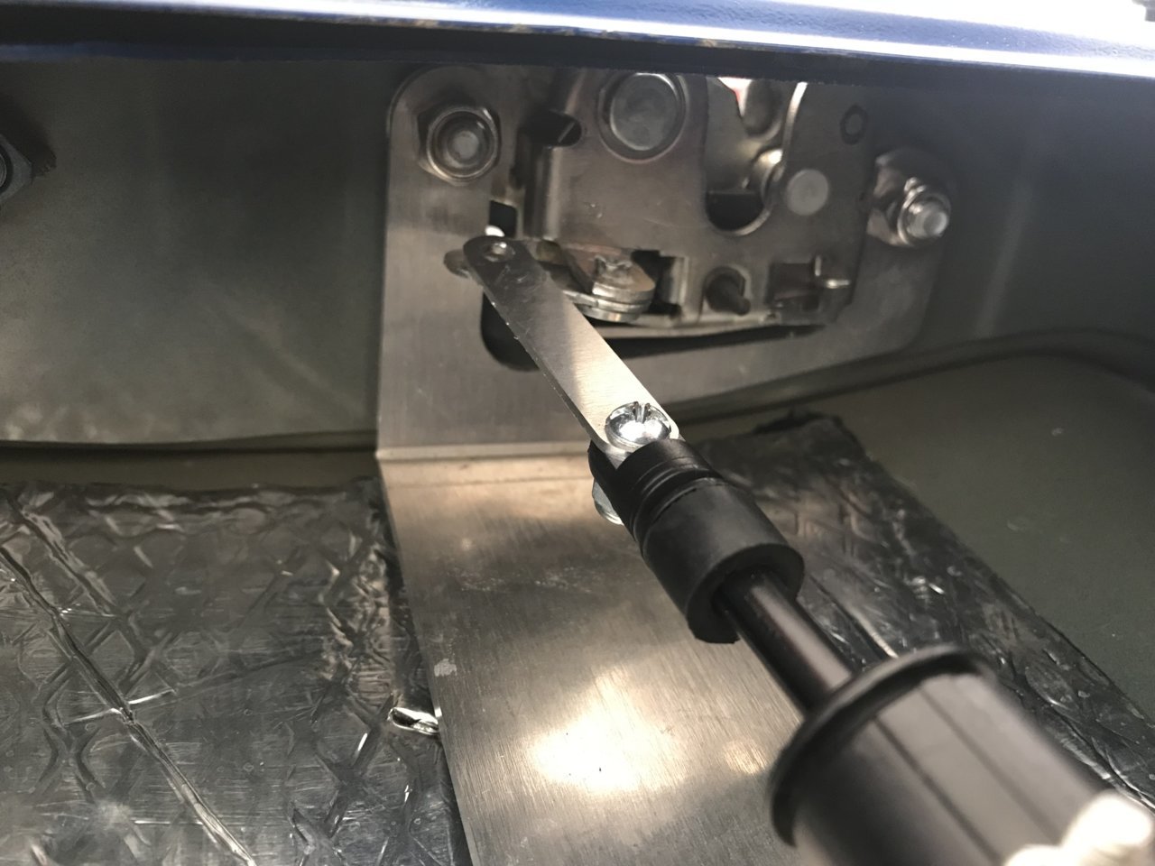

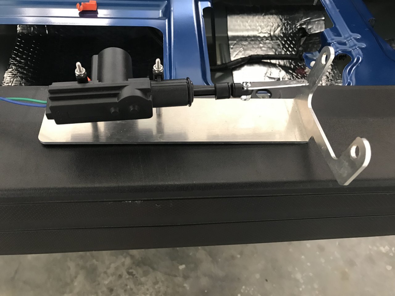

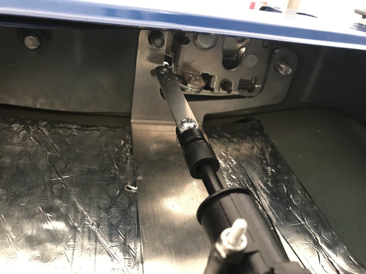

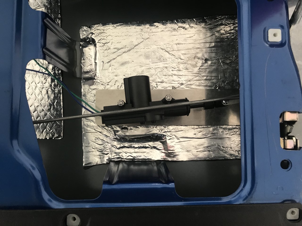

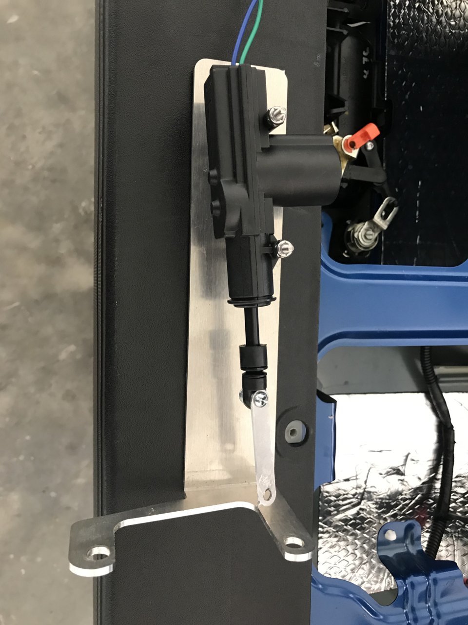

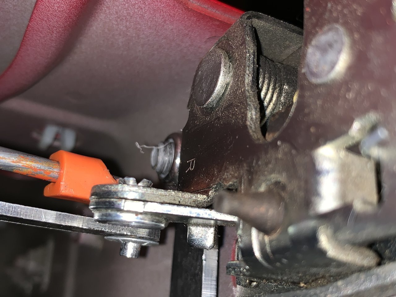

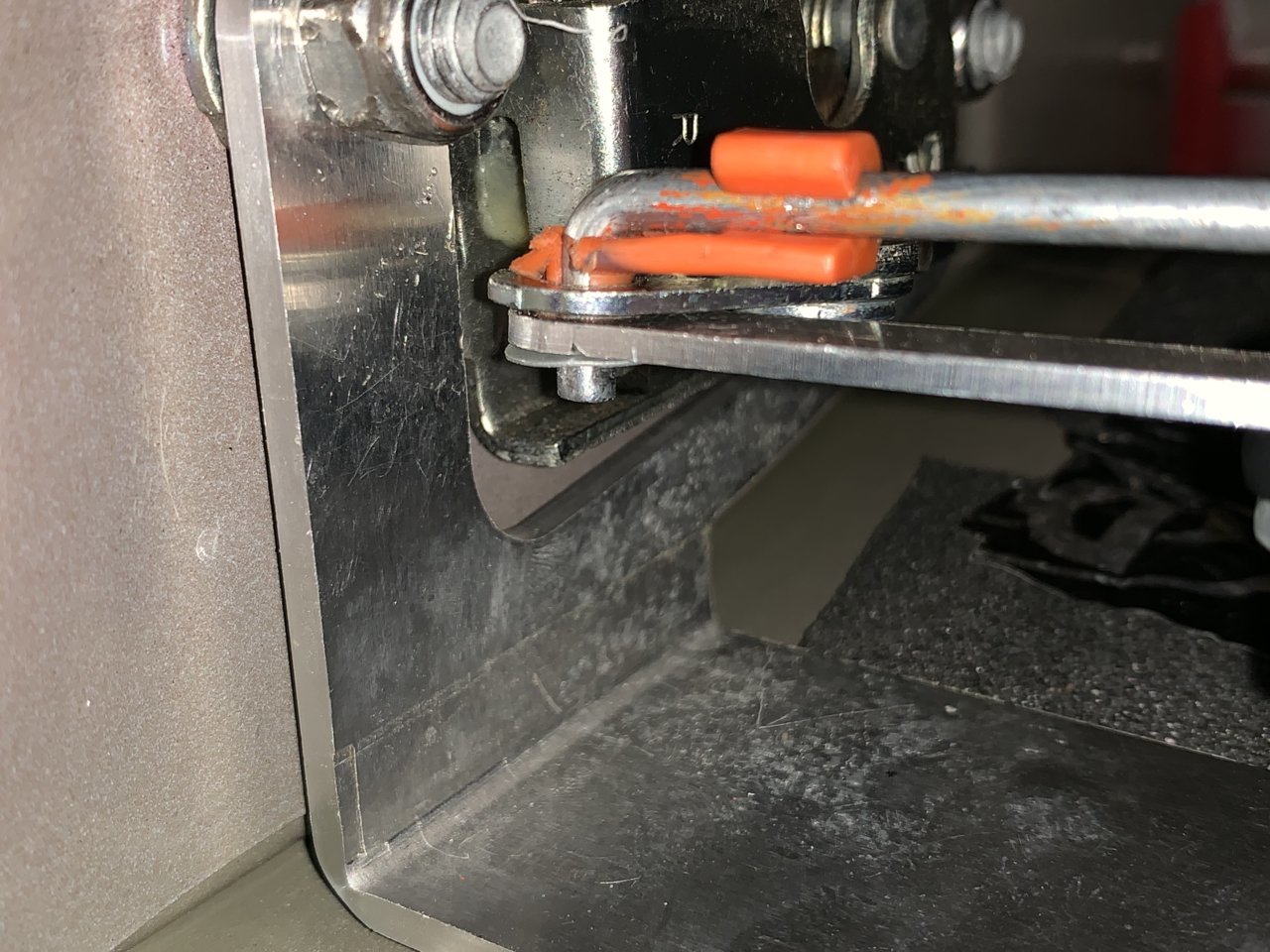

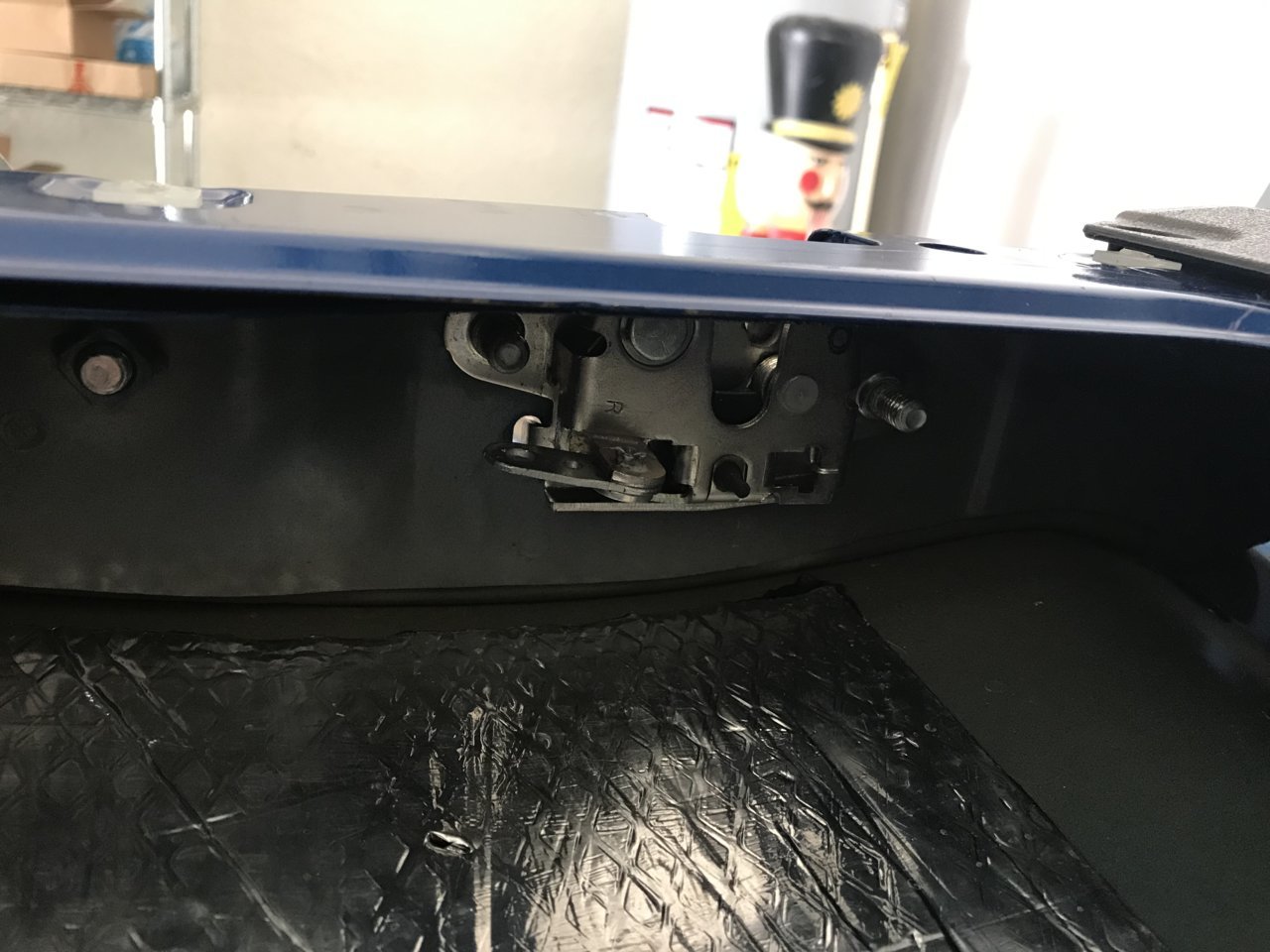

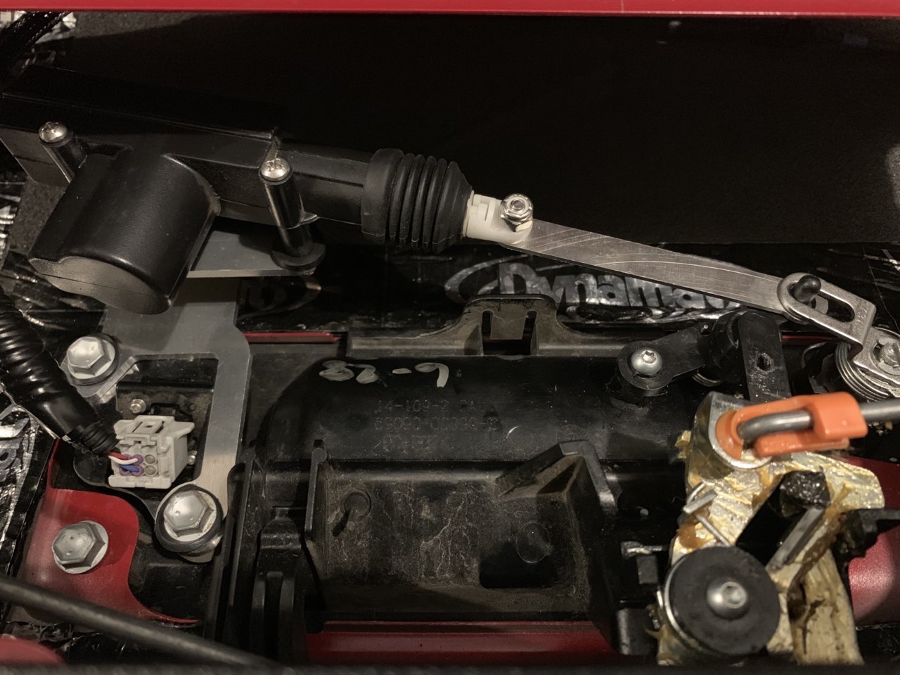

    For the those that purchased the these kits with the bolt n open bracket along with the DSIM Solutions Opener Module , Here are some helpful pointers for installing the actuator and bracket kit .
    1 - Once your inside the gate start off by removing the passenger side tailgate rod and the orange clip on the passenger side latch . Make sure you install the tailgate rod the same way you removed it .
    2- Have the bolt n open assembly as shown with the actuator in the current position .
    38172B0F-B09A-4E8C-9143-5CABA4BB534C.jpg 2FE4CA02-FCDC-4E3C-82A8-582A10FF7209.jpg

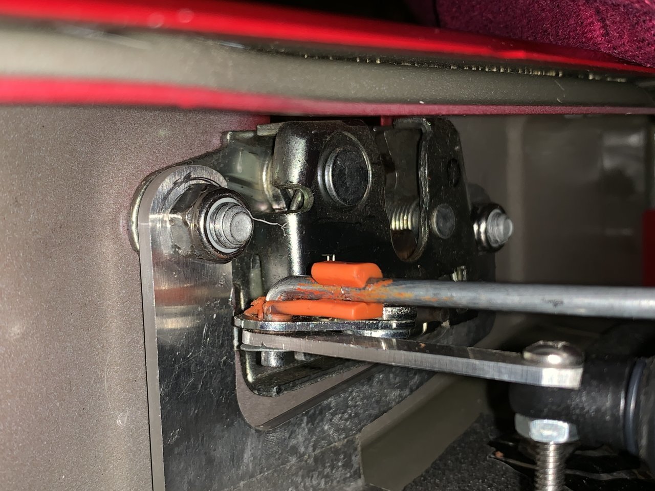

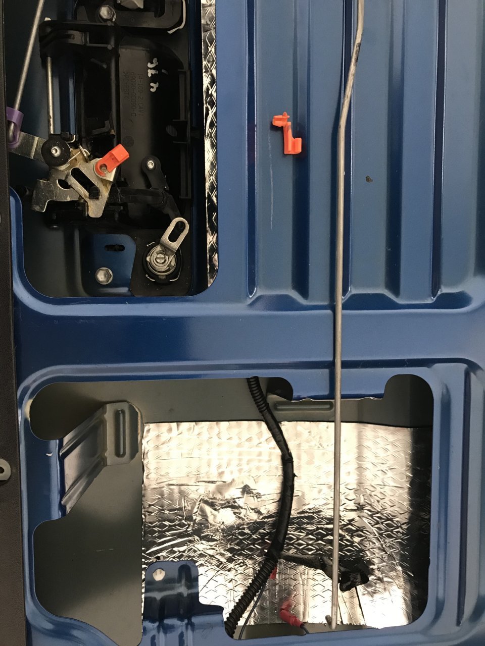

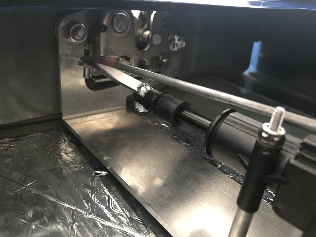

    3-Slide in the complete assembly with the actuator connector rod on top of the passenger side latch . Use the supplied lock nuts to bolt on the bracket to the passenger side latch . You need to use a t-30 to hold the latch bolt while tightening the 13 mm lock nut on the inside .
    1AE47993-FAB3-43E5-9C0F-853D79BEF724.jpg 1E6B4E2F-47C3-4575-AECE-F3E385700ECA.jpg BA8DAF87-82F8-43F5-A9F0-91A42D06C07B.jpg 9A87746E-221E-4204-B48E-E93416284AA0.jpg
    4- Reinstall the tailgate rod in the same position as removed , making sure it’s clipped in the handle and the center support .

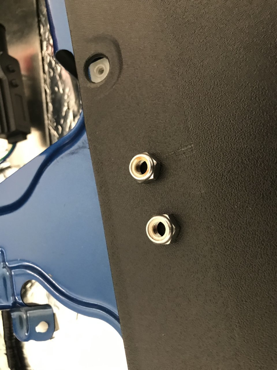

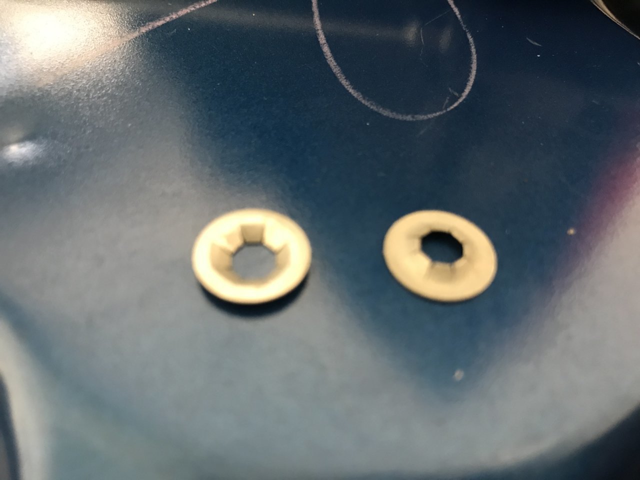

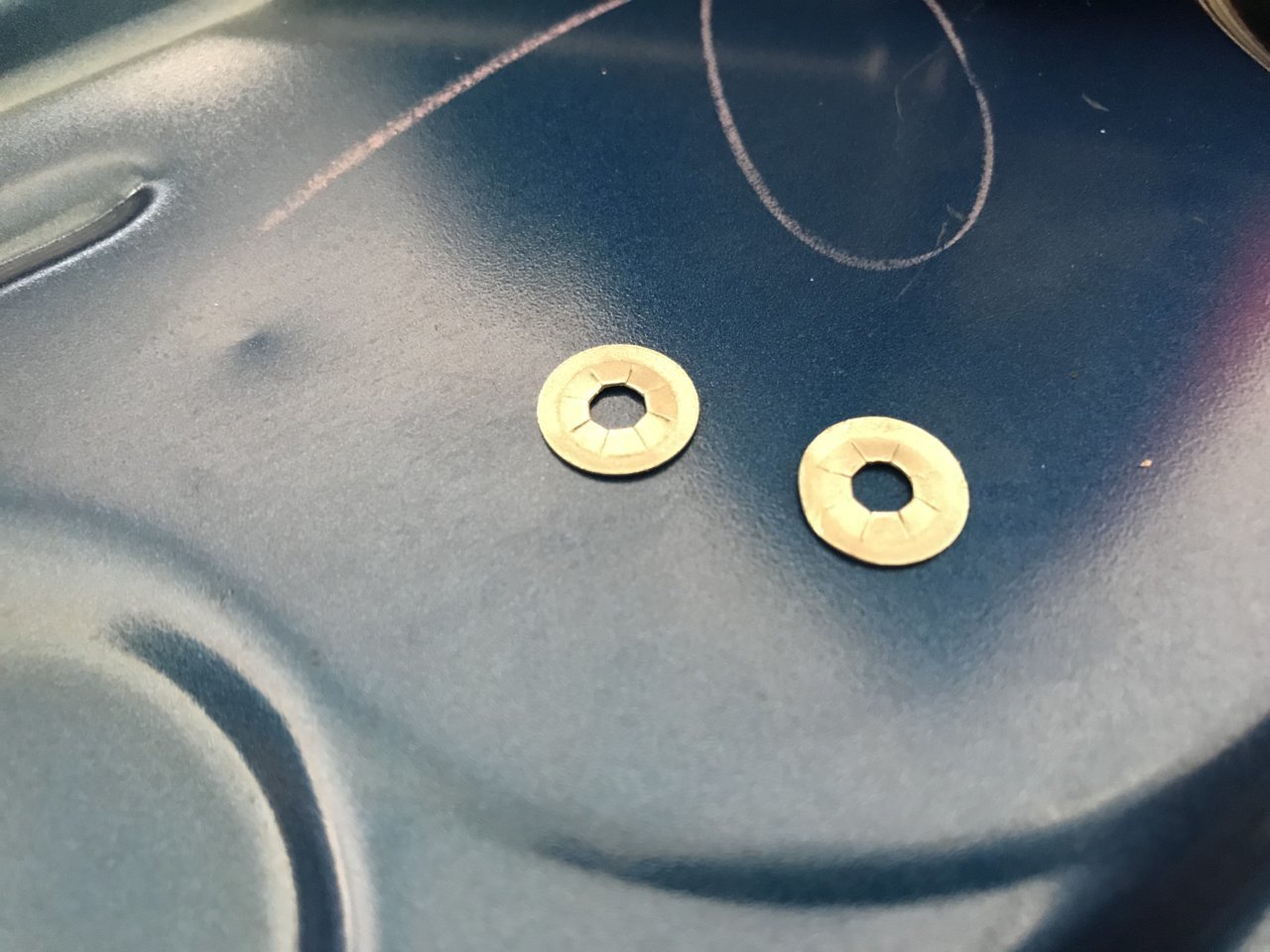

    5- Step 5 is the most important . In the hardware bag you will find two flat plush on nuts . You only need one but there is a extra Incase you lose one or really screw one up . These two nuts should look like so right out of the bag .
    To currently use these nuts you need to use a good pair of pliers and flatten the teeth down just enough where it’s hard to push on the end of the tailgate rod . When your done they should look like this .
    Make sure you test that it is on tight and won’t come off .
    https://youtu.be/3U7Orfa1VdQ
    It might seem strange to use this on the end of the rod but from testing once it’s installed right it holds and doesn’t back off after multiple uses .

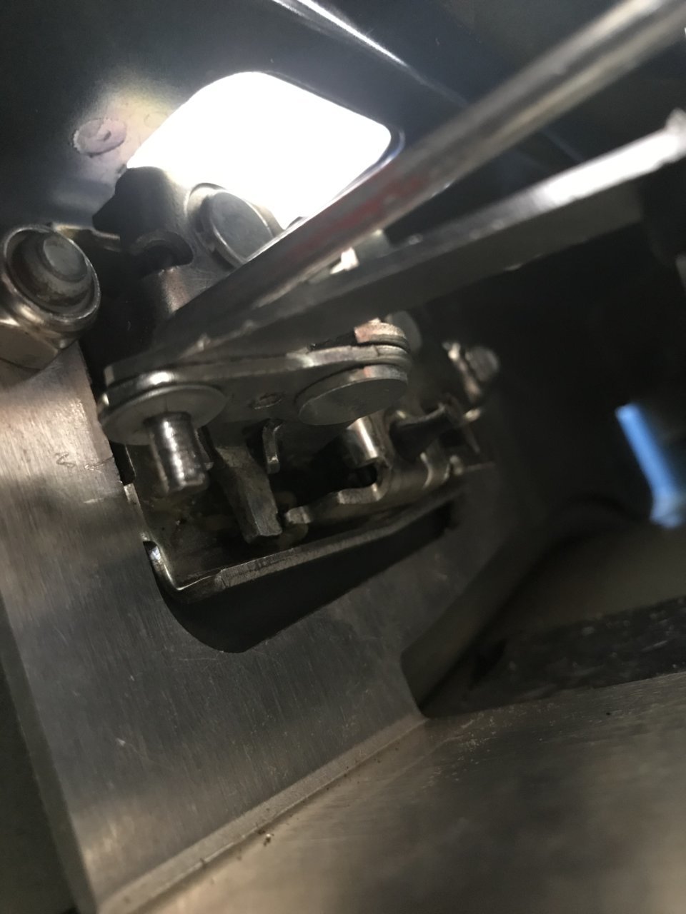

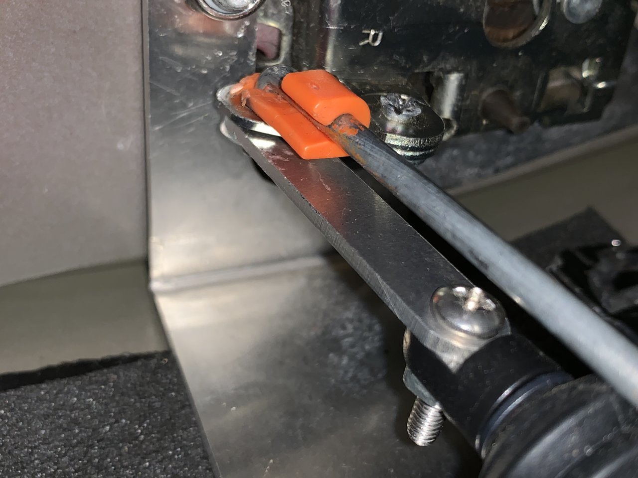

    6- You are now 100 percent done with the bolt n open bracket kit . It should look like this when finished .
