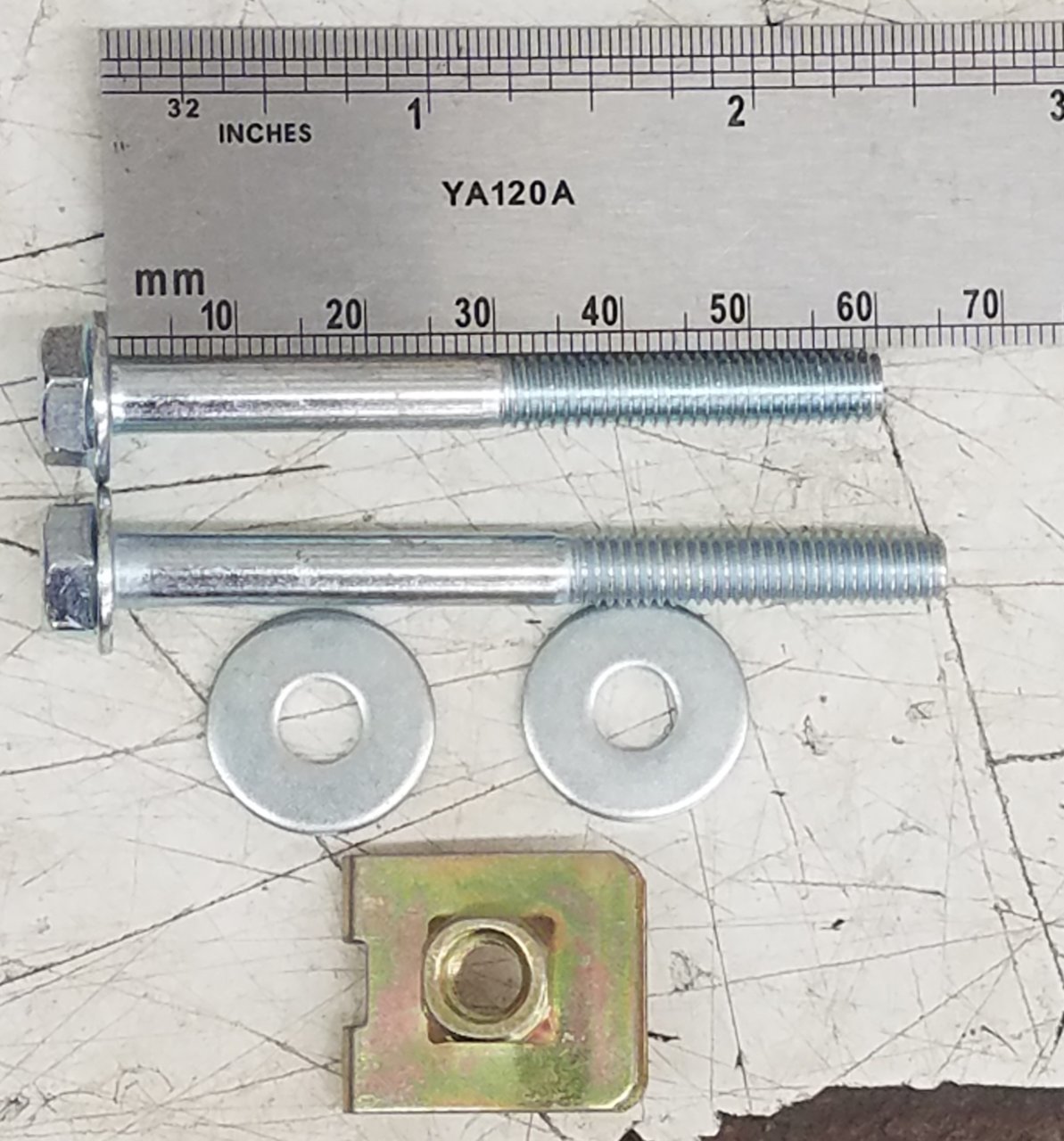

    01/05/21 Received via USPS. Label was created on 12/21

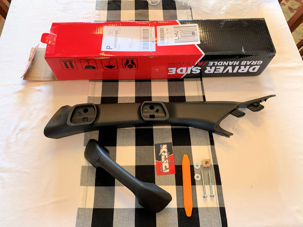

    Upon opening the dented up box, looks like it's all there. The clip nut is correct M6. Measured the bolt lengths as 60 & 65mm. Also noticed the KTJO tape around the handle, so figured the caps are correct. They were already mounted.
    Will try to get it mounted tomorrow & update on fit & finish.

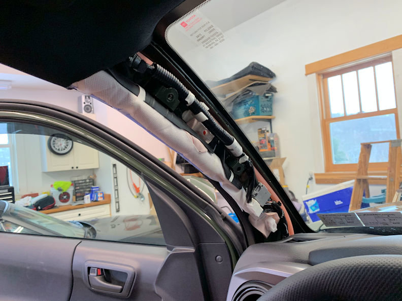

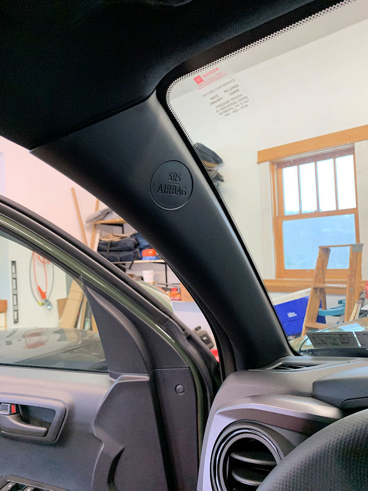

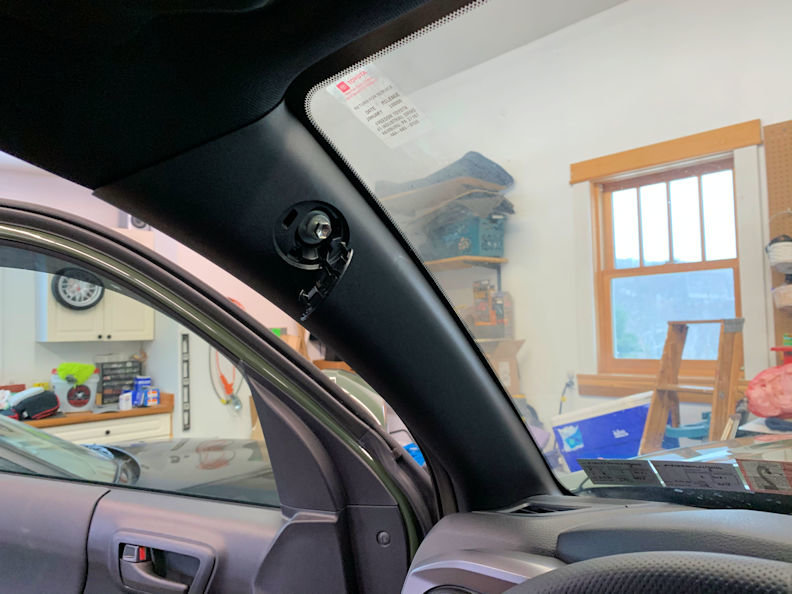

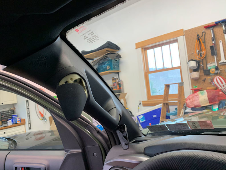

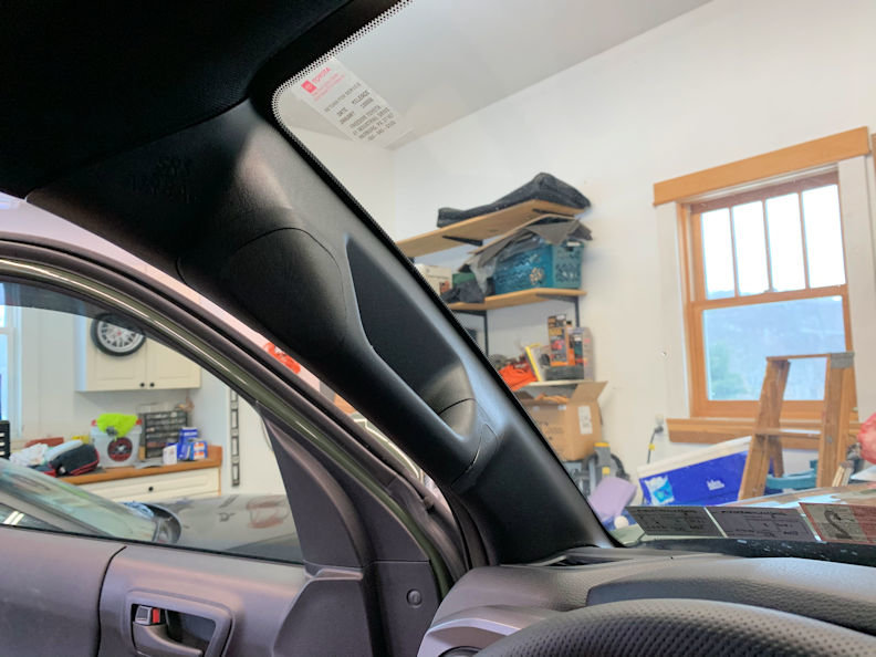

    ok, so I admit that I don't have a ton of patience...so I decided just to go for it with the existing M6 clip. Of course, it started off badly when I struggled to get the cover off the original A Pillar...trying not to scratch anything and I just couldn't get an edge. Finally got it, though.
    The original came off easily after that. It took me a bit to get the new A Pillar in - finally pulled out the tweeter cover and that did make it easier. Next came the bolts. I bent the M6 clip to hold on a bit better and popped it on from the top. Popped the handle in and then went through the inevitable struggle to get the bolts to line up. I got the lower bolt seated after maybe 5 minutes of trying - the upper bolt took maybe 10 to finally find the sweet spot - no bending necessary. Phew!!
    I'm actually pretty pleased with how it looks. The edge on the lower cover has a high spot that I'll probably end up taking down a bit but all in all it looks great and feels very sturdy.

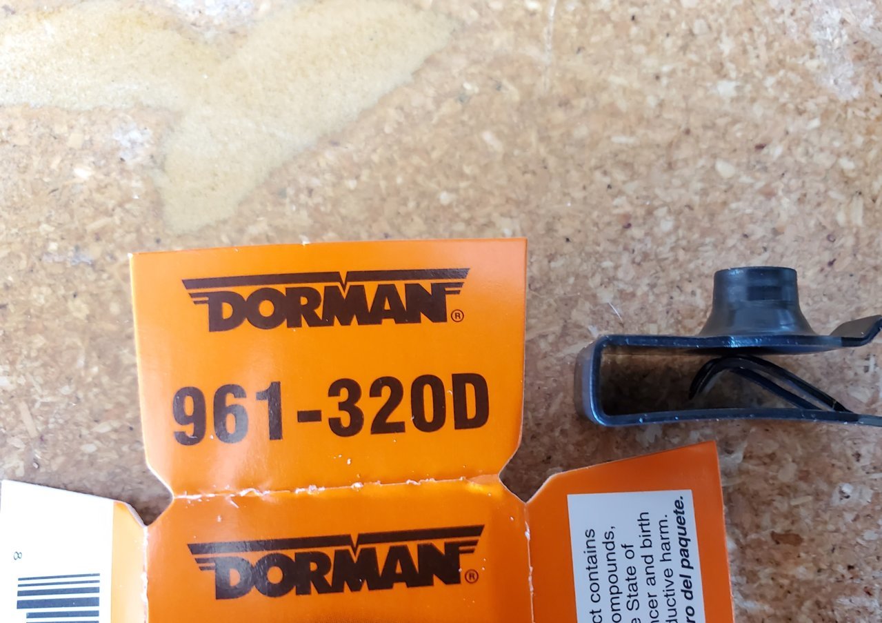

    And it’s such a shame one must buy a package of six clips, three of which are the same size as the wrong one sent, and have two spares. Anyone needing a clip?
    I wouldn’t go so far as saying magically perfect because it took some finagling to get shit lined up. Lucky is more appropriate...
