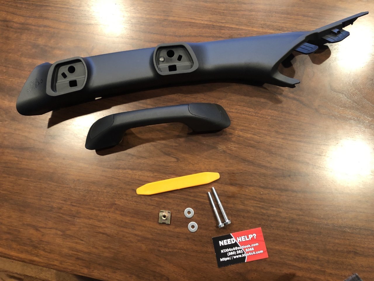

    Received mine today - a day earlier than expected! All the right parts. No damage. Will post the installed picture.IMG_4367.jpg
    Shipping took 5 days. USPS did OK in my book.
