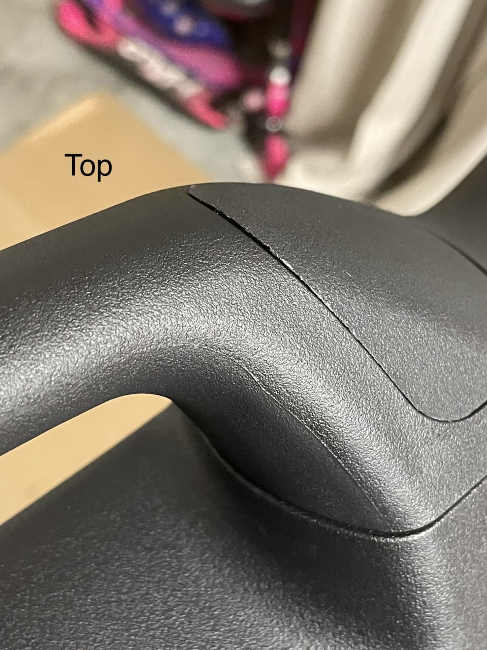

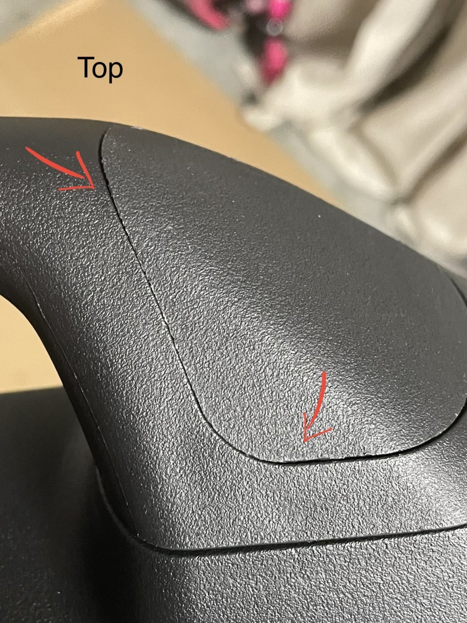

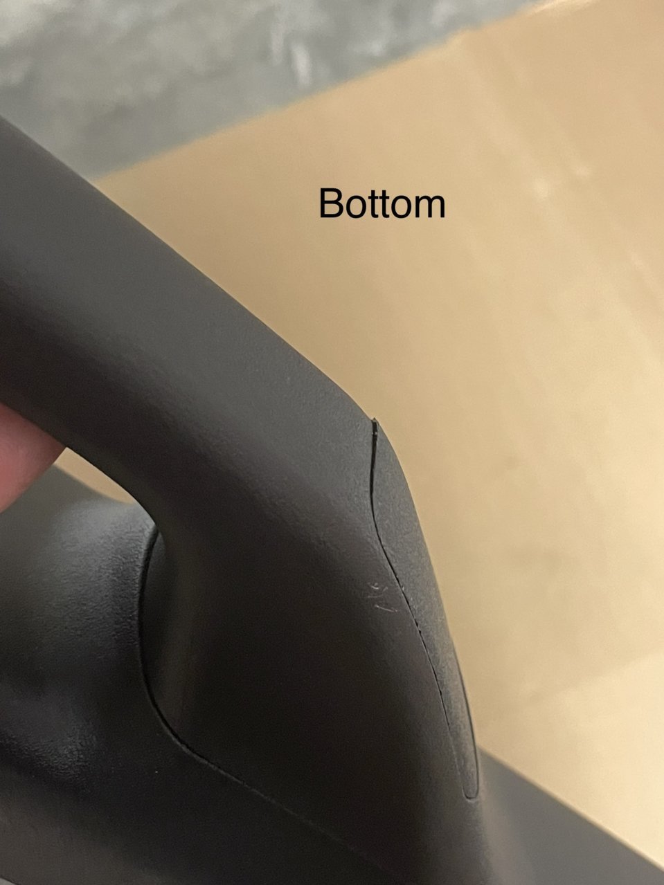

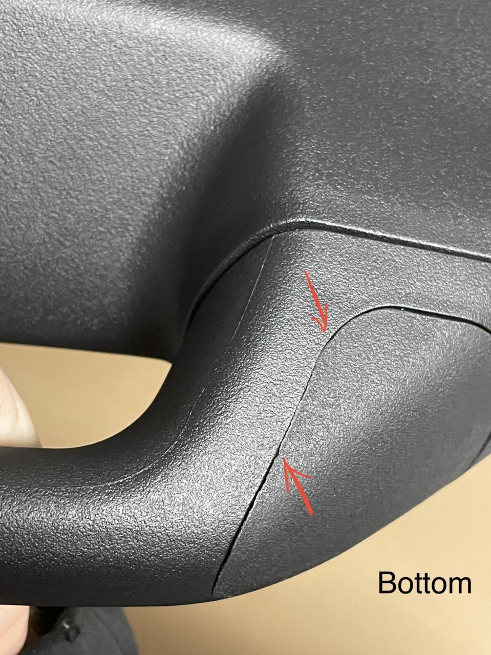

    Not odd at all considering at minimum half have mentioned 1 issue or another from quality to hardware
    The bottom is worse
    If you look closely you can see a ridge with extra material (between arrows) which is why it’s tight and keeping it from seating further down/in. Really it’s all the way to the corner but if I can sand it flat/even maybe
    the top is not as bad but same issue

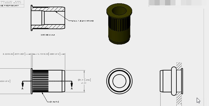

    Hindsight is 2020, but this is why normally don't recommend rivnuts unless you consider carefully what happens if they spin.

    Also not every riv nut is the same… it can lead down a small rabbit hole. Some are designed to prevent spinning w/ ribs and the like, the material thickness matters etc
    edit: in this case I guess the only thing is to drill out the head of the bolt and try to stop before the metal spacer. Then drill out the rivnet
    edit2: suggest not getting what’s available at the store or Amazon/eBay. Go to McMaster and look at all options specs etc then decide

    Like so
    When drilling out, use a good drill bit and be careful not to make the holes larger than the threaded insert used.
