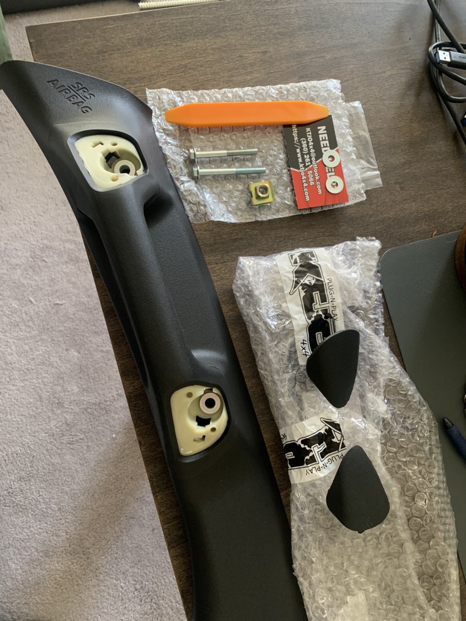

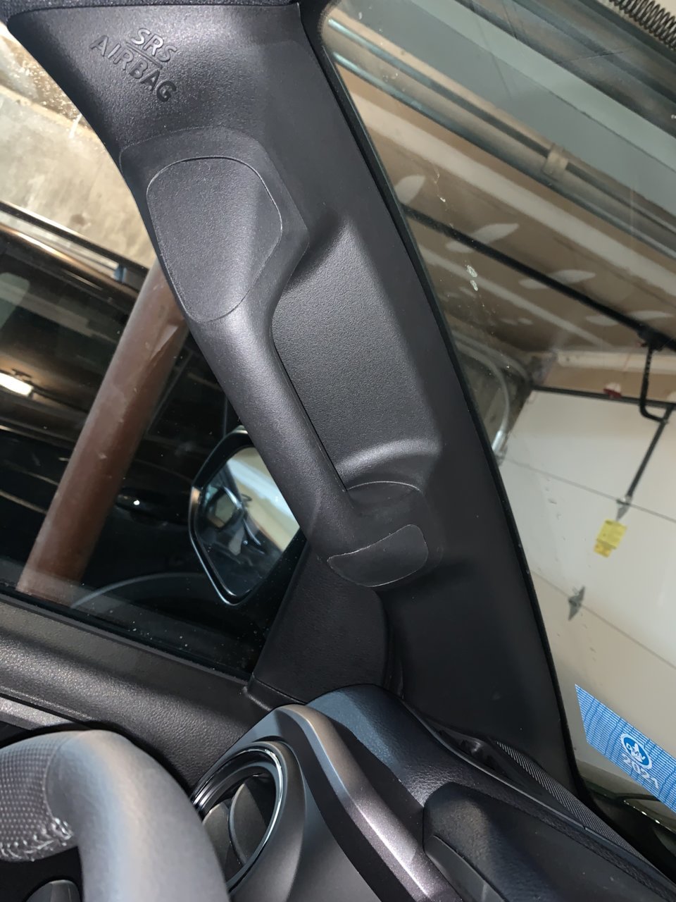

    Delivered today, only issue was the m8 nut which I was prepared for and had already bought an m6. Got the correct covers which was a nice surprise (but sad that it’s a surprise to get the correct parts).
    Aligning the bolts is a real pain in the ass, pulling the metal collars back helped, but made tightening everything up nerve wracking.
    Got the covers to fit almost flush, but as others have said they need trimming or sanding.
    Also heated up the A-pillar trim to fix the gap left between the KTJO trim and the weatherstripping, worked pretty well.
    Definitely got one of the “Magically Lucky” ones, shipping issues and wrong hardware are nothing considering I ordered and had installed in less than a month. Not OEM by any means but feels solid, and following this thread has been gold.

    Just curious. Did the covers come pre-installed on the handle? If not (like in your pic), then you got really lucky. Although, I think the designer tape on the bubble wrap means that it was checked?
