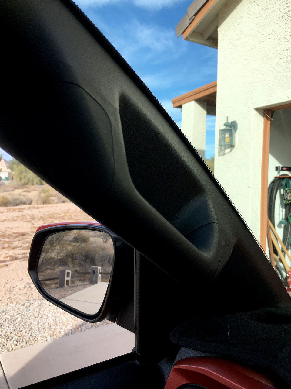

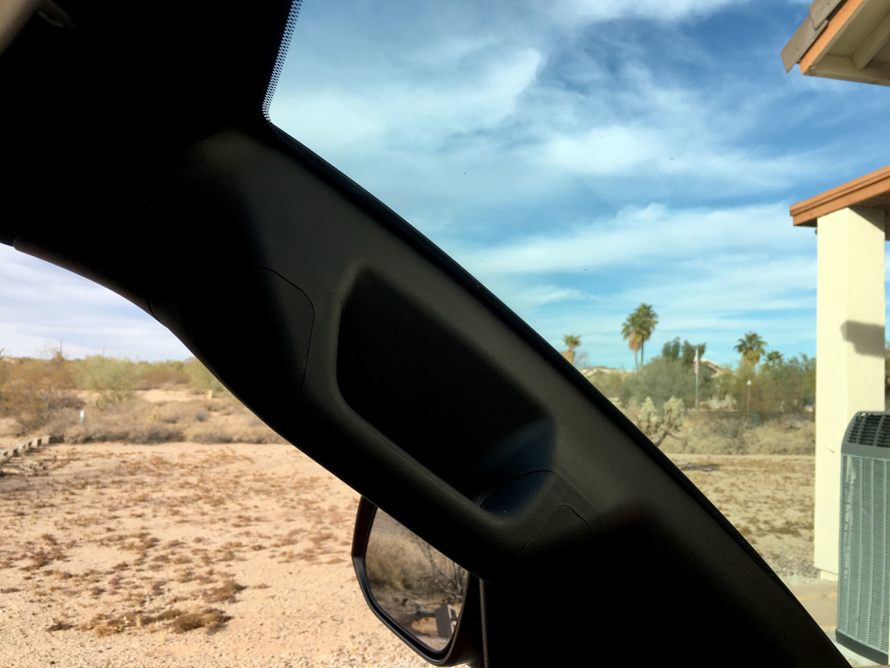

    I must have been lucky .... my grab iron installed just fine with no problems :). No bending of tabs or any other problems, other than having to get the correct M6 clip. I think that clip is better than what would have been supplied account it is self centering and stayed in place.
    I had no problem starting the bolts and it was all done in about 30 minutes. I did note that there was a strip of foam along the leading (windshield) inside edge of the original garnish, which was not mentioned in Rob's video. I simply peeled it off and stuck it onto the new piece.
    It feels good and solid and should be fine. Account I am a smaller guy with short legs I have the seat fairly far forward so there is no problem with it sticking out into my field of vision. Of course I notice that it is there, but I'll get used to it soon enough.
