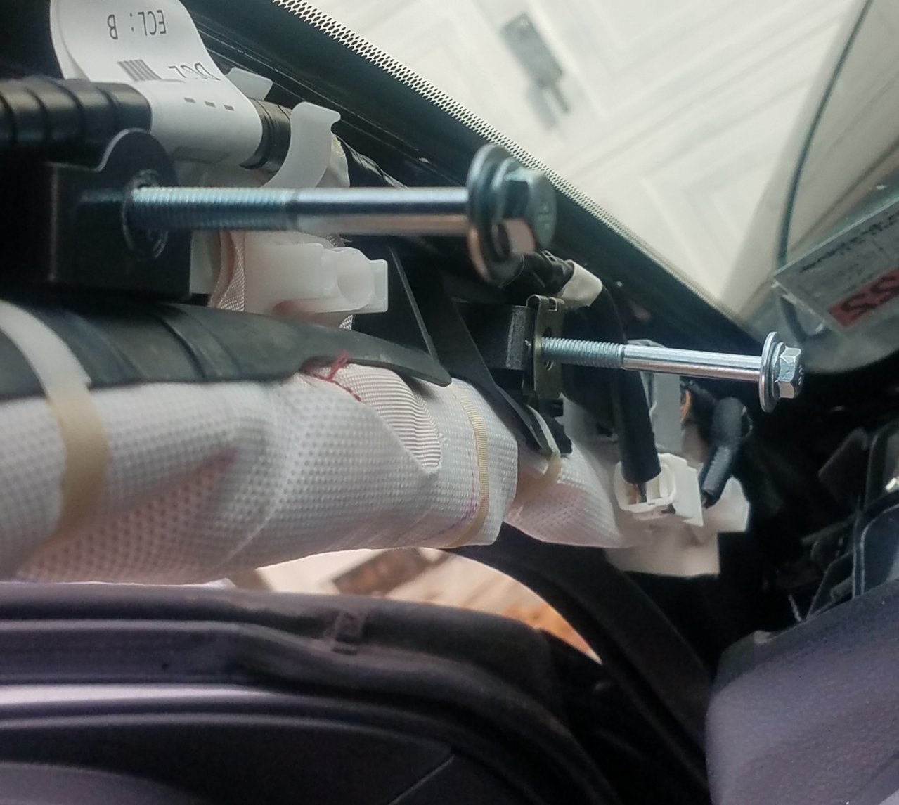

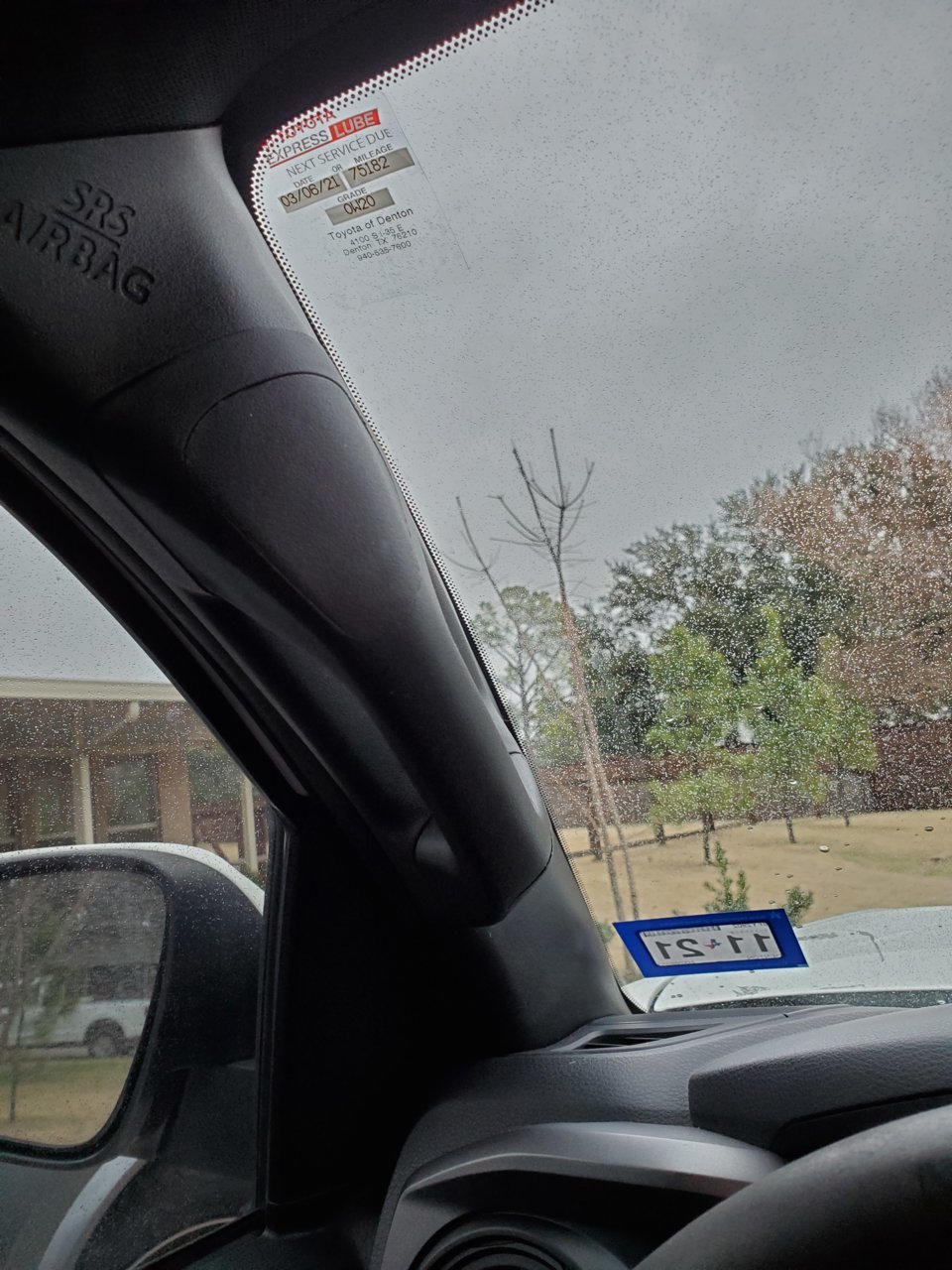

    So I got mine installed yesterday.

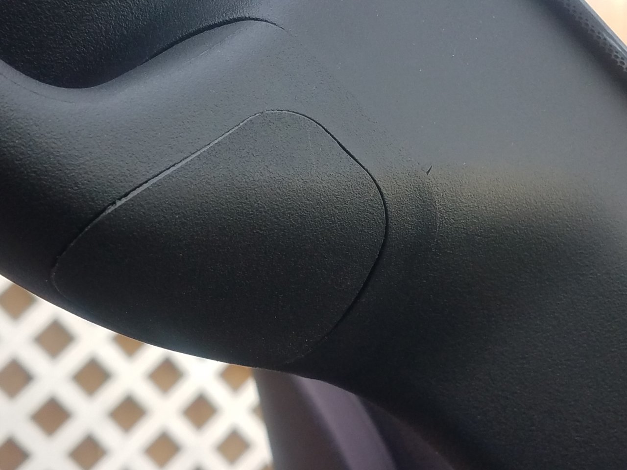

    I put the bolts in first, just to see their angles. I left the lower bolt real loose, and took maybe 5 minutes to get the top bolt in. I also stuck a flashlight between the headliner & top of the trim piece, so I could see the top bolt hitting the threads. Everything tightened up clean. Covers fit well, but do have the rough edges like most have mentioned.
    I did also remove the tweeter cover first, and that made R&R of the trim piece easy.

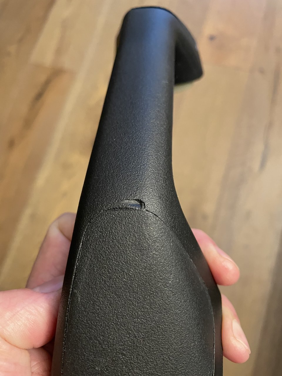

    I guess there is hope... but I've yet to hear anything back for my damaged handle. I forwarded the original email to Brian, maybe he'll get it resolved. I'm just hoping they resolve this before she runs out of stock...
