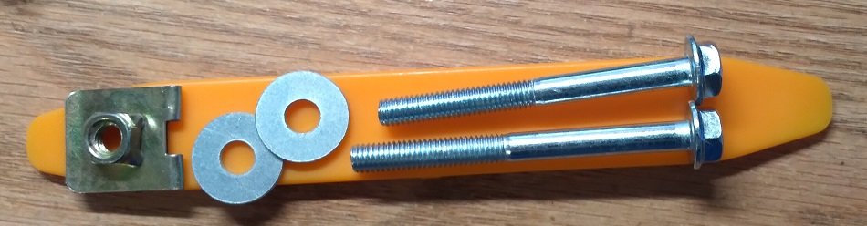

    Thank you to all the member here that gained and shared the knowledge of how to get this think installed! I was able to install my handle in about 15 minutes today.
    Used some tape to keep the u-nut from wobbling around. I also had the issue with the metal sleeve in the handle that didn't fit in it's hole and kept falling out, a little tape around that to keep it in place.
    I put in the main trim piece, then had to give the handle and trim some pretty good pressure to bend it to the point where the top bolt would go in. After the top bolt was in 3-4 turns, went to work on the bottom bolt. Had to give it some pressure, and jiggle it around a bit, but eventually got the bolt in. Took turns tightening the top and bottom bolts 3-4 turns until it was pretty snug.
    OEM? uuuuhhm, sorta, but not in a good way? Comparing it to the right side, the fitment isn't as good, but it's actually not a lot worse. I used a razor blade and some sandpaper to finish the edge of the covers. There are irregular gaps around the covers and between the handle and the A-pillar trim. The A-pillar trim does fit well against the weather stripping. I Haven't spent much time in the passenger seat, so wasn't aware of how lame the OEM part fits. The gaps on the OEM part aren't a whole lot better. The texture of the new part is a pretty good match. The color is not a match, seems just a tiny bit lighter, but it's close enough.
    Plug and Play? Oh, pu-leeeease. The only reason I was able to do this so quickly was because of the hours spent by others here figuring it out, thanks again.

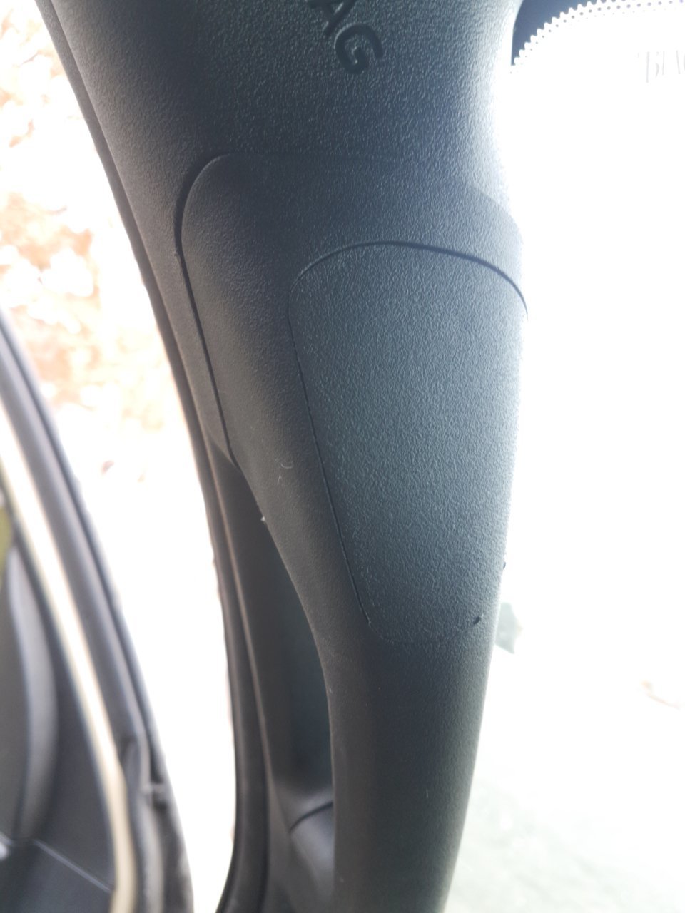

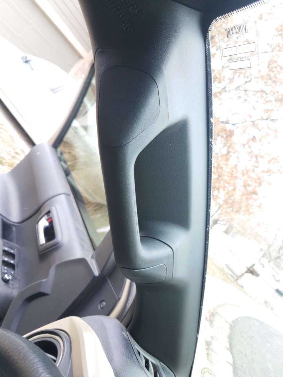

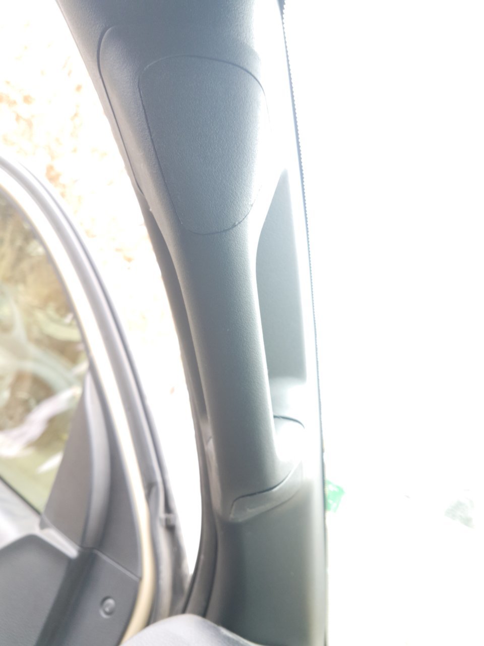

    USPS delivered today, JUST before 5:0. The carton was worse for wear, but the area was one of the leader pins that goes behind the tweeter cover and didn't show any signs of shipping damage. The hardware seems in order. I pre-pinched the spring section of the clip to help hold in position. But the handle has pitting and blemishing by the upper cover. Right in the line of sight. I will try to get ahold of Brian, and see about getting a replacement handle.

    Yeah. That handle look bad.
