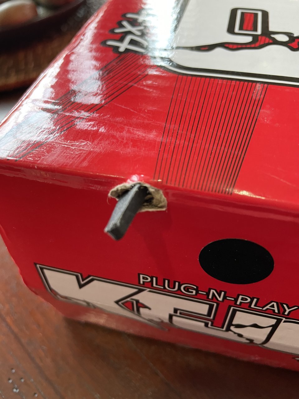

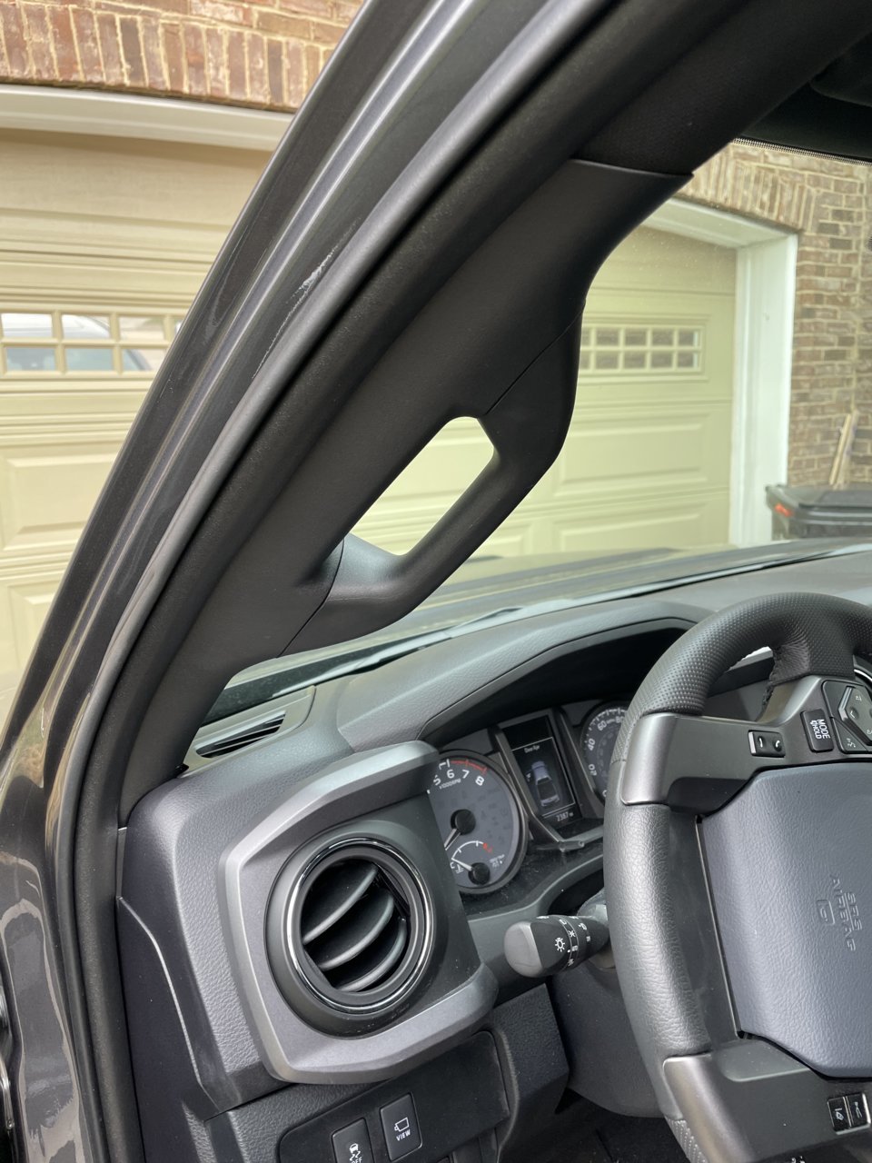

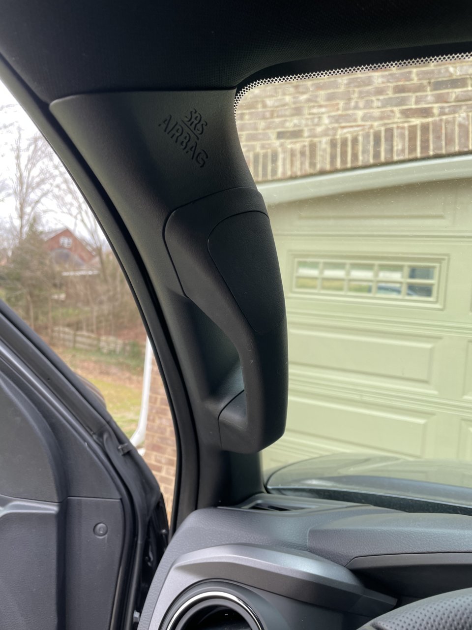

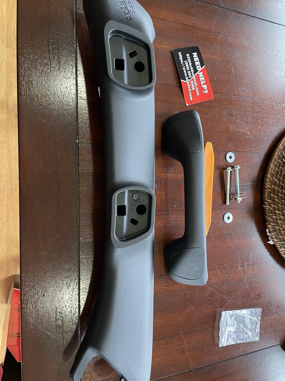

    Well mine came in this morning. Same size bolts but correct speed but. Correct covers. No marring or anything to handle of pillar cover- even with that piece poking out of the box.
    Install took 15 minutes with no bending required. Pulled the tweeter cover, angled the handle/cover and started threading the top bolt. No issues. Bottom bolt caught thread immediately. Ease of MY install was a 9/10 (10 bearing very easy). I docked a point because the damned bushing fell out of the handle on me twice.
    Overall fit and finish: I did have to wet sand some minimal flashing from the bolt covers but that only too about 5 minutes. I would rate fit/finish 7.5/10 do to alignment of handle/pillar cover/bolt covers not having clean/matching lines.
    Functionality 10/10. It is solid and does what it is supposed to.
    Disclosure and ready for flame spray: I ordered from TCMBST because I didn’t want to deal directly with KTJO.
    ETA: I changed my vote to magically delicious...I mean magically perfect.

    So I have the mishmash of installation pieces. My clipnut is the wrong size, will be replaced.
    The M6 bolts are two different lengths. Which one goes where or should they both be the same length?
    If it doesn't go in properly, I'm not going to be bending anything to make it fit. If bending is necessary, this is a flawed product design and is unacceptable.
    Some people have had no issues, some people have had problems with the installation and fitment.
    I won't know my answer until I'm into it and frankly am undecided if I even want to mess with it now.

    The short bolt goes up top.

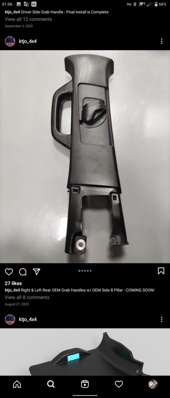

    This is the only thing that I want. My kids are short and my mother has a bad hip, we need the rear handles more than anything else at my house.
