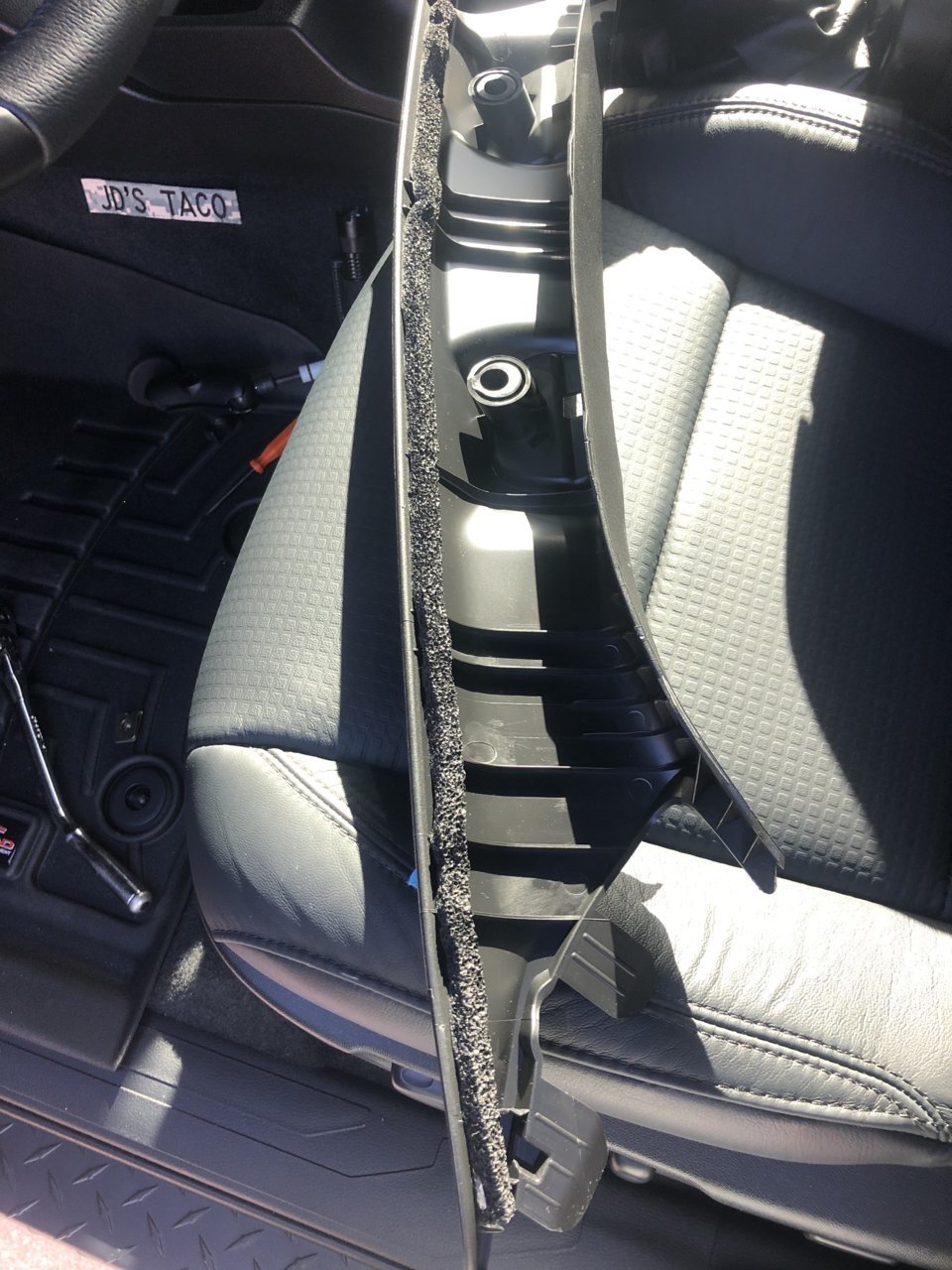

    My exchange Handle is in Town at the Post Office, but with the Holiday it’ll be too the door tomorrow. I switched out the foam piece on the new Pillar trim and have it installed. Will hopefully be able to button things up tomorrow.
