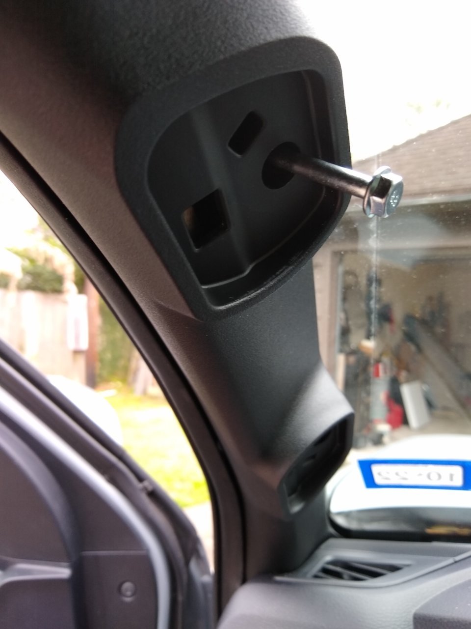

    I found that I had to slightly bend the top mount with the bolt screwed in. It wasn't rocket science. :notsure: I can only imagine if some of these guys tried to install an aftermarket skid package. Only minor "gentle-persuasion-with-a-hammer" required. :rofl:

    I briefly considered bending the A pillar tabs but nope. That's why I did the partial install to see what the angle was before going any further.
    Wrong parts, lied to, zero response on repeated contact = not something I want to mess with any further.
    I'm used to precision engineering and expect it from anyone I deal with, professionally or in a hobby.

    For this install, I bent both of the tabs to get the angles "right". I figure I'm never going to take it off anyway, so no risk of having to bend them back and whatever issues that might create later. Now it looks pretty good, the plastic isn't under "stress" from being tweaked, and I know I've got a good clamp load that I don't know you would get for sure without lining up the angles.

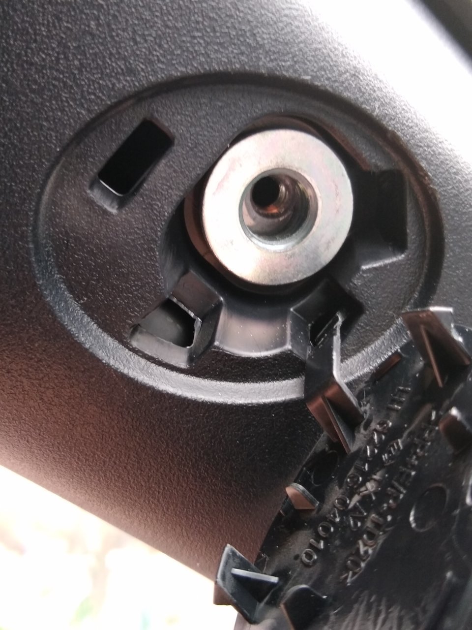

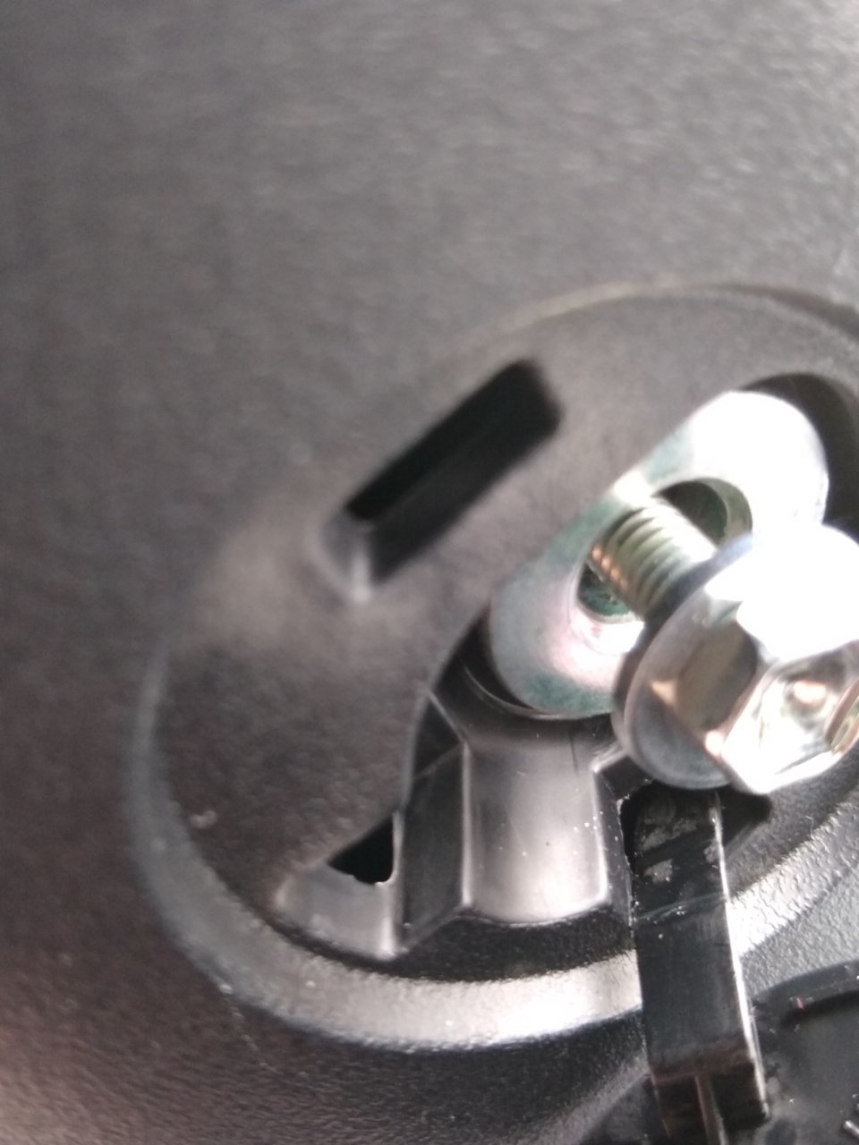

    So I didn't read the whole thread,
    But this is happening
    Any suggestions to keep it from popping off.

    2 choices. Glue it in place permanently or return it.

    Get a little bit of butyl rubber, put it on the tabs and push it in. You can get free butyl rubber from your doors, just pop off the door panels and steal a little bit from the vapor barriers (its the black sticky good)

    Mine does it as well. Quality OEM stuff we scored here. I choose to let it dangle so when friends point it out I can refer to Katie's most excellent operation. I feel like it's a $200 conversation piece. I can't wait for her "Passenger side steering wheel mod"....it'll be great to have a poorly designed, ill-fitting steering wheel on the passenger airbag cover!!
