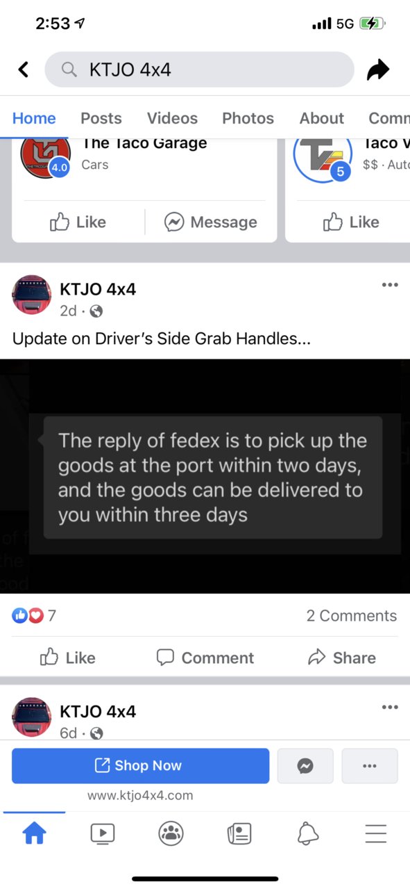

    Looks like she's getting them Monday or Tuesday and we get them a few days after that.

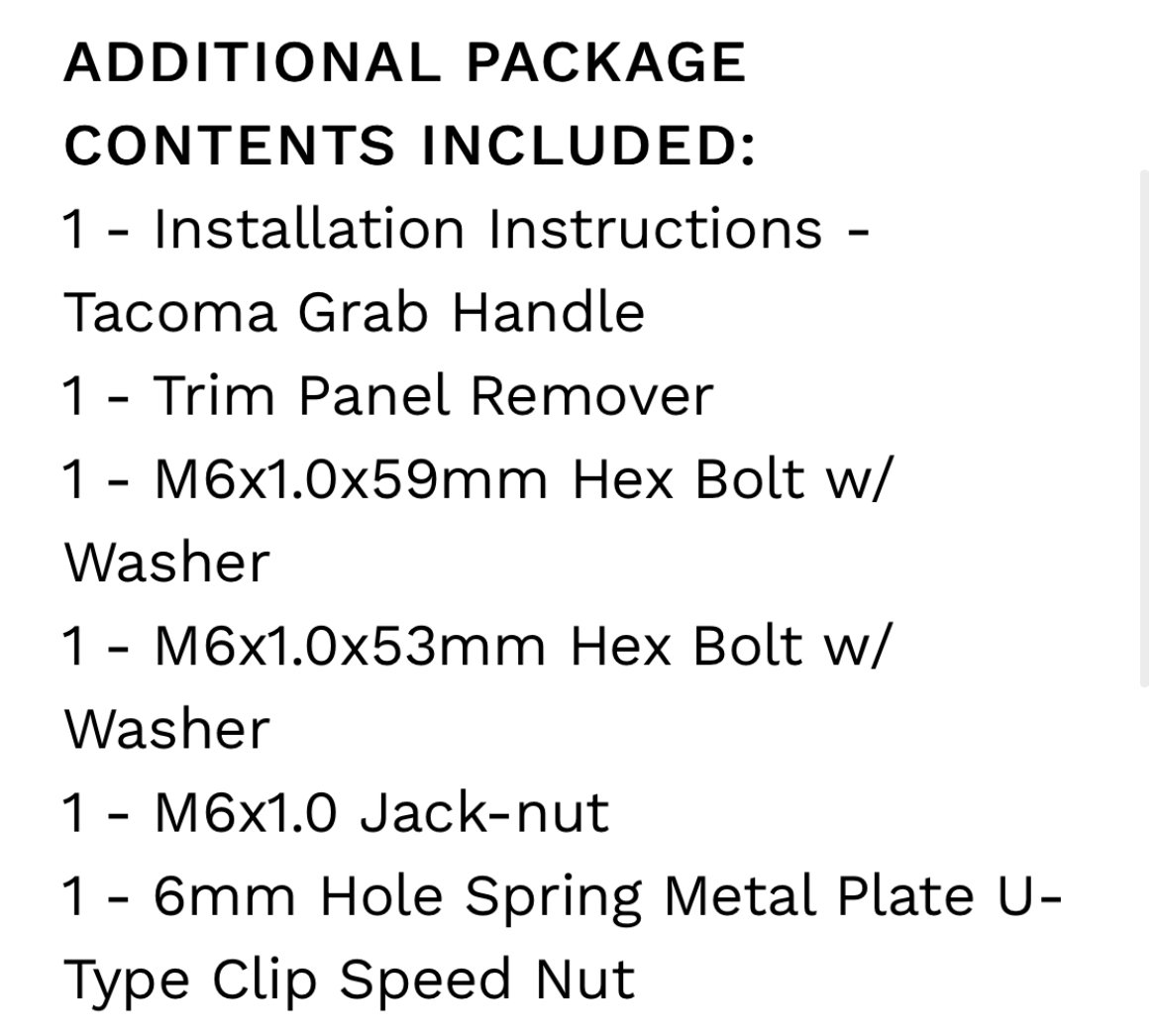

    If it makes any difference the kit says that it comes with a jack nut, not a rivnut.

    Valid point there, jack nuts have wider bases, which may address any load bearing area concerns compared to a rivnut/nutsert.

    According to the Fedex tracking, they’re still sitting in the warehouse. Monday or Tuesday is optimistic.

    A jack nut would definitely drive me toward a backing washer, just for long term pull through worries. I'd prefer the hole filling of a rivnut, but that appears to be an understandably oversized hole.

    Would using a well nut be completely ridiculous? Nice that it wouldn't be permanent, no sharp edges and may offer some dampening (no rattling)

    They are also called “crossNUTS”, at least according to my UpTop Overland install instructions on my under hood light. It is definitely more descriptive than “Jack”. I’ve also seen “plus nuts”.

    I love wellnuts. But, a lot of folks seem to hate them. Low quality ones exposed to heat tend to rot.
    The bearing surface / tension issue would be worse there than a rivnut, IMHO.

    Yeah, I've never used them. I could see that if you pulled on the handle, it would expose a gap, as the well nut would compress the rubber even more... Not sure how solid they are when installed.

    I don't recall anything about the 2nd Gens. That doesn't mean that it wasn't posted. My guess is that it used a second welded nut, just like the upper. That would be optimal for my minor worry, but . . .
    They are used on my bike's fairings. The OE ones sucked due to the rot problem. The replacements have been good for a much longer span of time. IMO, they're great for quick installation, replacement, vibration / isolation, and shear. Just not tension.

    I don’t dispute what’s on F#%^book but according to Fedex tracking any movement of the goods is pending. Check it out: tracking # 398748347420
