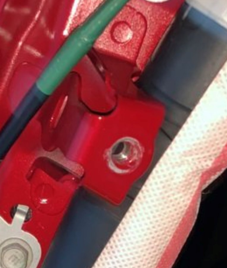

    I don't disagree that the area is sort of similar to the 2nd Gens. It would take a comparison to know how close the internal structure is. Given the overall changes noted, I would guess the internal stuff is somewhat different. It could be either shape or strength for the crash structure.
    Zoomed here on the right side is probably our best current view. It appears to be a welded on nut. My assumption is that they removed that manufacturing step when the canceled the left side handle late in development.
    My only concern here is long term strength under tension for both the clip and the newly installed threaded part. I think a backing washer would be the simplest answer?

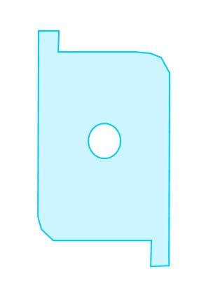

    What we need is a plate of .25" steel that we can thread. Just put little ears on it, so it doesn't spin in the bracket...

  3. Dec 4, 2020 at 12:23 PM
    #423
    tonered
    tonered [OP] bartheloni
    Sep 25, 2017
    #231055
    31,264
    tony
    Lynnwood, WA
    You win!
    I know a guy that could whip those out.
    Paging @7r41lbr34k3r . :yes:

  4. Dec 4, 2020 at 12:23 PM
    #424
    Bertw192
    Bertw192 Well-Known Member
    Aug 3, 2017
    #225852
    14,456
    Bert
    Seattle, WA
    2017 TRD OR DCSB
    All the things!
    Or better yet, so it doesn't spin while backing off either...

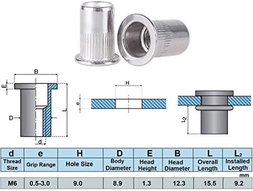

    WaitingOnMyR1T
    WaitingOnMyR1T No longer waiting…
    Aug 5, 2020
    #336687
    3,396
    Josh
    Portland, Oregon
    2020 White TRD Pro - Magnuson S/C & Rivian R1S
    Is that hole in the center 9mm so that you can use an M6 rivnut?
    tonered[OP] likes this.
  6. Dec 4, 2020 at 12:34 PM
    #426
    Bertw192
    Aug 3, 2017
    #225852
    14,456
    Bert
    Seattle, WA
    2017 TRD OR DCSB
    All the things!
    No, if the material is thick enough, I'd just tap the hole. If .25" it will be more than enough. Hell, 1/8" would probably work.
  7. Dec 4, 2020 at 12:38 PM
    #427
    Bertw192
    Aug 3, 2017
    #225852
    14,456
    Bert
    Seattle, WA
    2017 TRD OR DCSB
    All the things!
    If we were to mock it up and get a drawing of it, I can get a quote from a local laser cutting company in Puyallup (my dad owns it). Just don't expect any discounts... it's a business after all.
    pochoboy and tonered[QUOTED][OP] like this.
  8. Dec 4, 2020 at 12:40 PM
    #428
    tonered
    Sep 25, 2017
    #231055
    31,264
    tony
    Lynnwood, WA
    Sounds good to me.
  9. Dec 4, 2020 at 12:41 PM
    #429
    dilbert
    dilbert AI Member
    Mar 14, 2016
    #181276
    2,861
    PNW
    2019 DCLB TRD Off-Road
    How would it stay in place during assembly?
    Why am I following this when I don't even have one of these on order? It feels like a work meeting.
    Malvolio likes this.
  10. Dec 4, 2020 at 12:42 PM
    #430
    Bertw192
    Aug 3, 2017
    #225852
    14,456
    Bert
    Seattle, WA
    2017 TRD OR DCSB
    All the things!
    Tape :D
  11. Dec 4, 2020 at 12:43 PM
    #431
    dilbert
    dilbert AI Member
    Mar 14, 2016
    #181276
    2,861
    PNW
    Yeah, I was thinking tape too. Only needs to hold in in place for a short time.

  13. Dec 4, 2020 at 12:44 PM
    #433
    Bertw192
    Aug 3, 2017
    #225852
    14,456
    Bert
    Seattle, WA
    2017 TRD OR DCSB
    All the things!
    One wrap of electrical or friction tape ought to do it. As long as you don't jab it with the screw while you attempt to start the fastener.

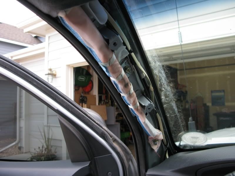

  14. Dec 4, 2020 at 12:49 PM
    #434
    shakerhood
    shakerhood Well-Known Member
    Aug 9, 2015
    #161370
    37,097
    Southern Ohio
    2017 MGM DCSB Off Road, 6 Speed MT, P&T
    I had that area apart on my old 2015, l will see if l can locate the pics if that would be of any help with anything
    Bertw192 and tonered[QUOTED][OP] like this.

  16. Dec 4, 2020 at 12:52 PM
    #436
    Bertw192
    Aug 3, 2017
    #225852
    14,456
    Bert
    Seattle, WA
    2017 TRD OR DCSB
    All the things!
    Is this a 2nd gen? Looks like it has the 3rd leg
    tonered[QUOTED][OP] likes this.
  17. Dec 4, 2020 at 12:58 PM
    #437
    tonered
    Sep 25, 2017
    #231055
    31,264
    tony
    Lynnwood, WA
    It seems to look like a 2nd Gen.
    Dang though. That third leg has me thinking that reinforcing where possible might be a good idea?
    shakerhood and Tacospike like this.

  19. Dec 4, 2020 at 5:08 PM
    #439
    shakerhood
    Aug 9, 2015
    #161370
    37,097
    Southern Ohio
    I'm glad that pic popped up on here because I don't know where those pics went that l had.

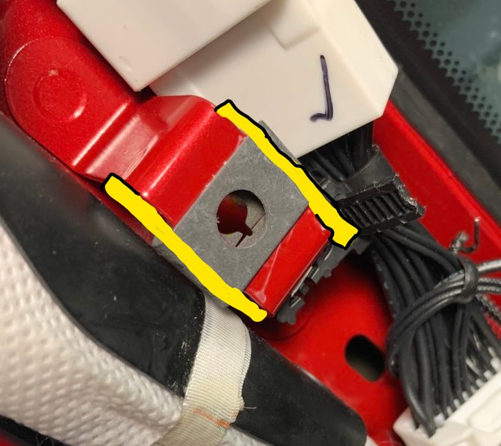

  20. Dec 4, 2020 at 9:21 PM
    #440
    jimmerheck
    jimmerheck Well-Known Member
    Mar 21, 2018
    #248007
    660
    Vancouver, WA
    2019 Tacoma Limited in white
    all this got me thinking, they sell M6 rectangular nuts through McMaster Carr, like what was mentioned.A pillar rectangular nut.jpg
