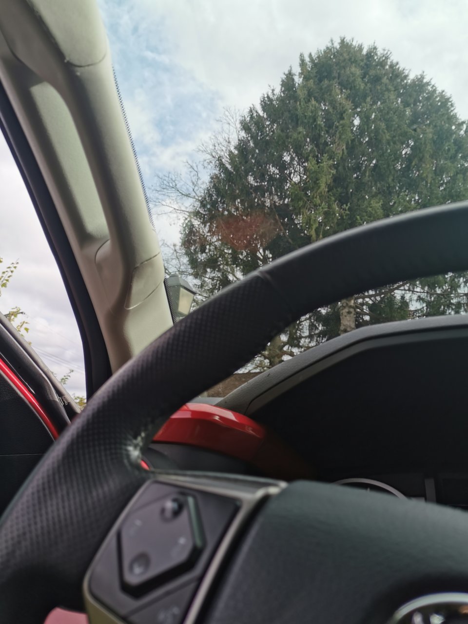

    Yeah!
    Just don't look at that bottom bolt cover too often.
    But, you are all set now. Good on the dealer for fixing it.

    Honestly as far as I'm concerned it is perfect (In that it is there and it also works). The slight flaws seem to be either from KTJO/the hired manufacturer, a privious install with some or all of this handle kit, or both. Really I could not care less about the KTJO probs as there is not much left unsaid. She has been metaphorically eviscerated repeatedly in several toyota themed corners of the internet. Also my issue was only ever with the dealer for sending me home with a mystery factory pillar cover without consulting me. They made it right and the only reason for the long wait seems to be KTJO.
    "Could not care less about the KTJO probs" is a poor way to phrase that. I don't mean to make light of what others experienced and expressed within this discussion. Just trying to keep my focus.

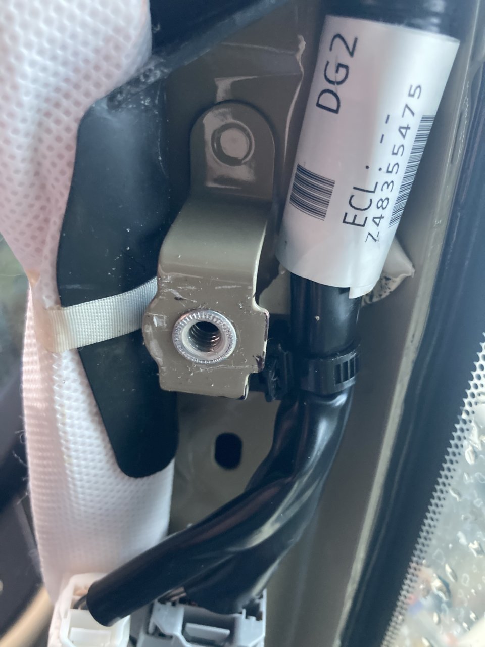

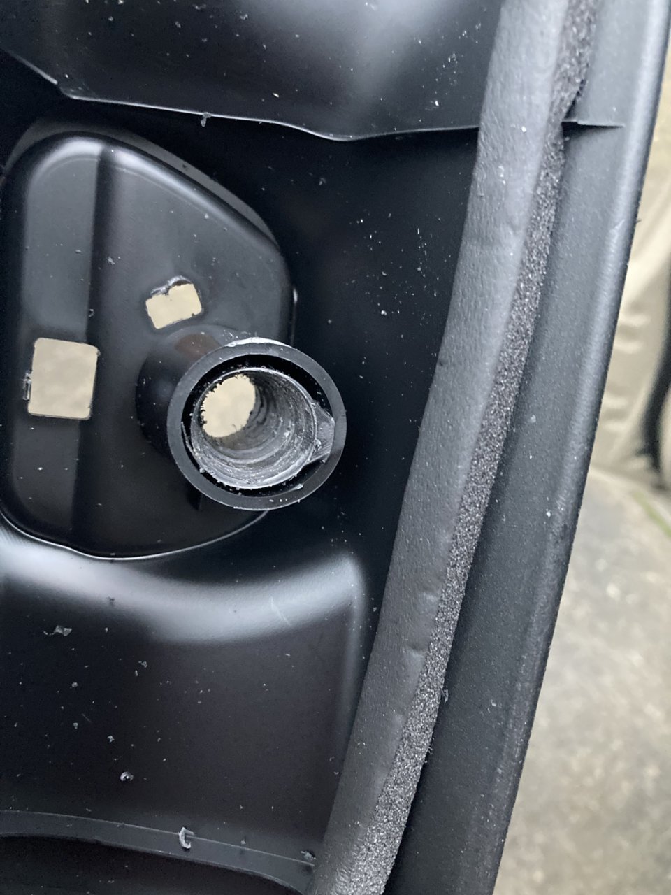

    This install required modification.
    Lower clip was garbage, after several failed engagement attempts I installed a nut-cert. After that, bolt went in first try.
    The alignment on the lower hole was about 1/2 inch too low. I used a step bit to bore out the hole and ditched the insert .
    after all that finagling…

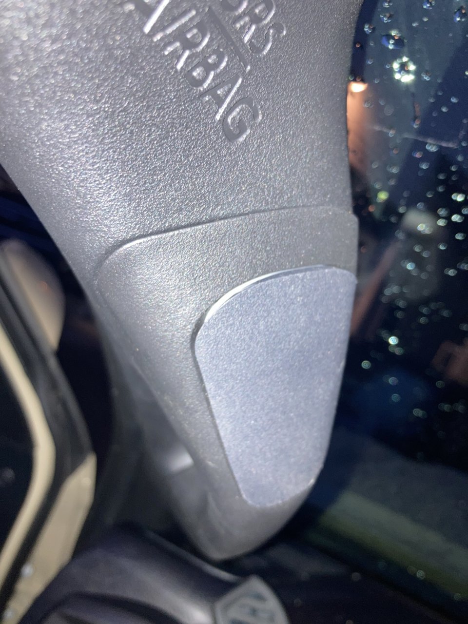

    Issue with both caps not having positive engagement. Emailed ktjo 12/11/21 with explanation, pictures, and receipt.
    Also note the caps are a lighter color.
    * I did read everyone’s nightmare experience and against better judgement still purchased the handle. I was hoping the handle would help with my bad back.
