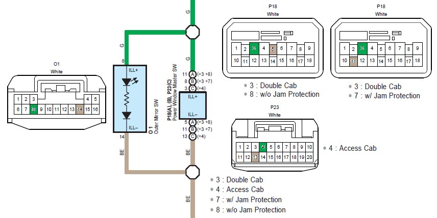

    Do you know the wires would you need to tap in to to archive this? I have been looking at some small chipset leds on Amazon that I think might work. It may be a bit of pain on my end but the peace of mind might be worth it.

    @caribe makaira sent me the pins for the rear seat window switches. Finding the parking light positive with a meter is pretty easy. PWM ground is maybe a little trickier.

    Yeah this pwm is a bit confusing for me. I guess I will probably have to order from her if I want them.

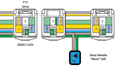

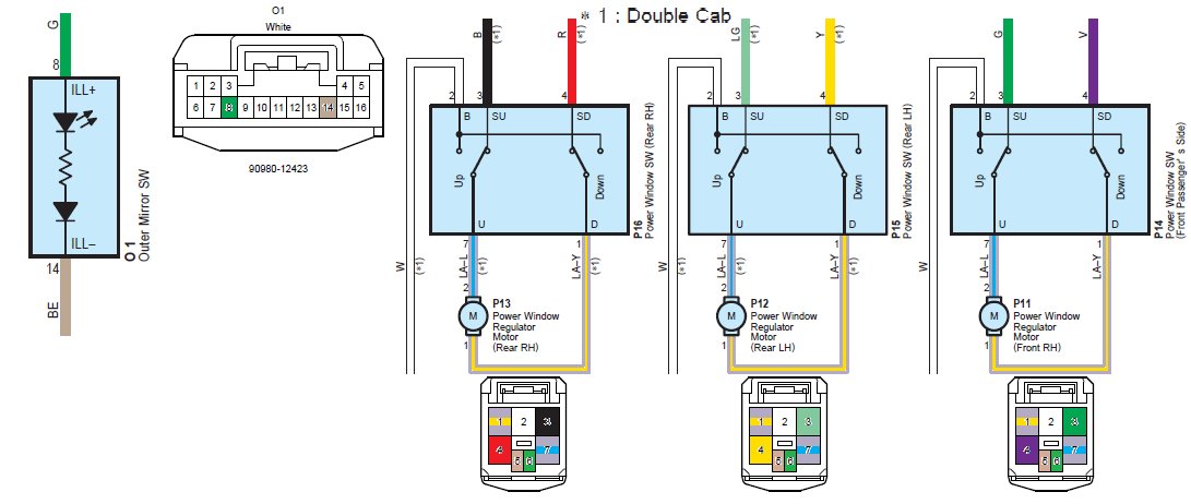

    It's just the beige wire for the PWM ground. Green for (+). No trick there.
    Power Window Master Switch Connector & Outer Mirror Switch connector.

    So bare with me. It has been years since I messed with automotive electrics. All I need to do is connect the led to the green and beige wires?

    Yes (5 & 6)

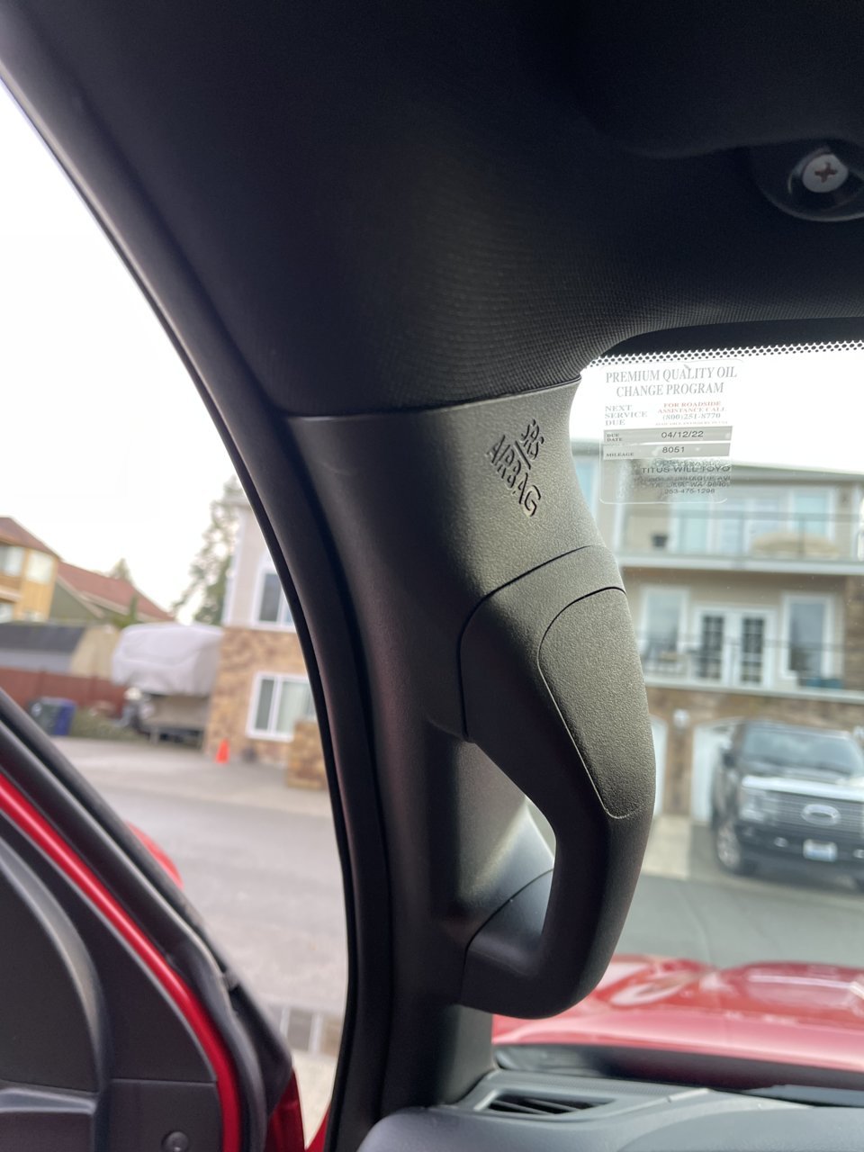

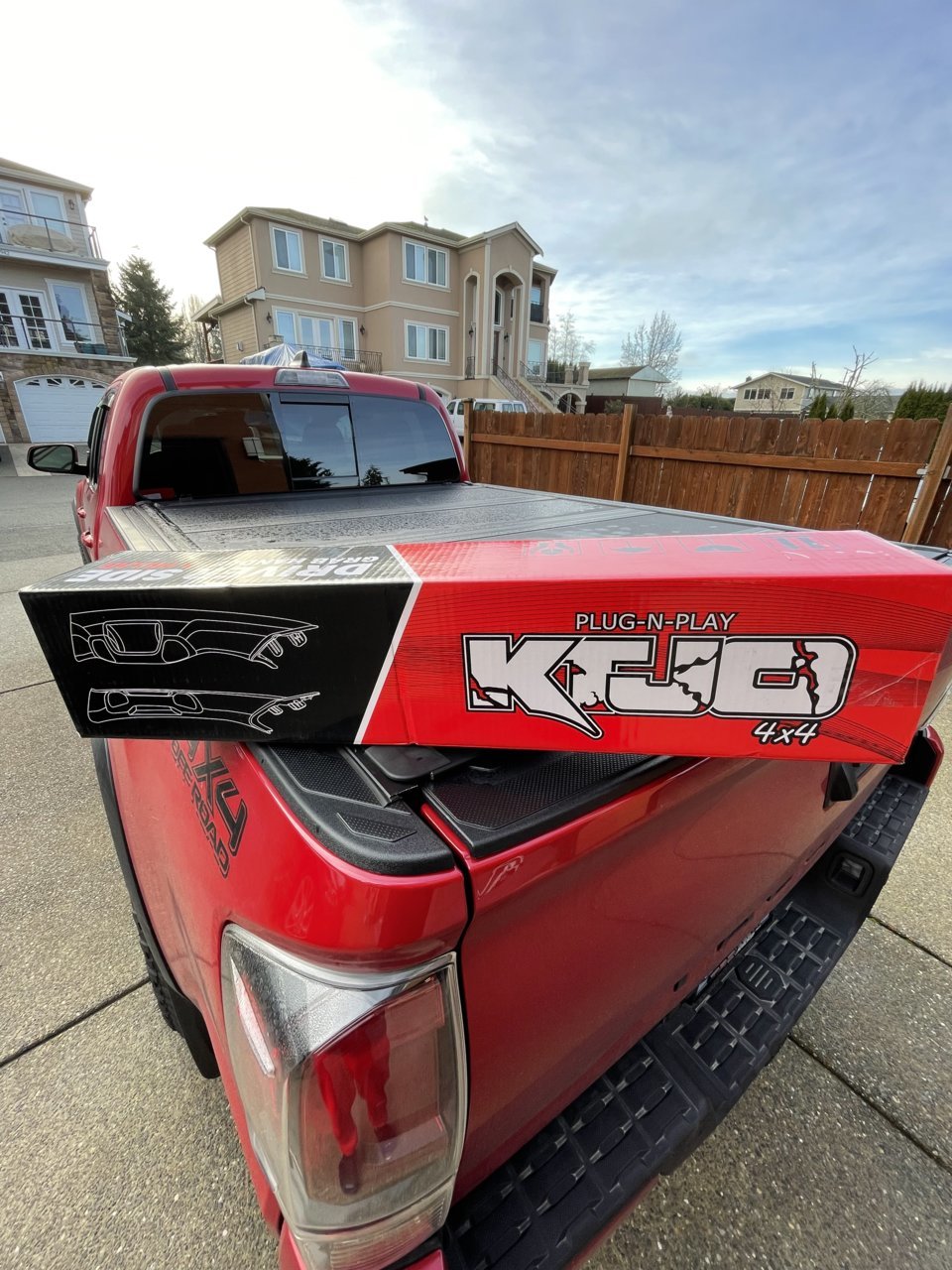

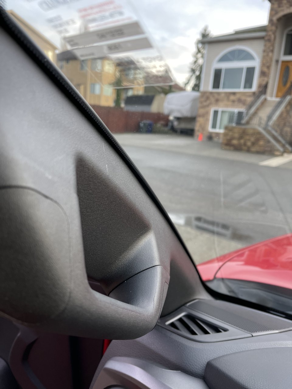

    Look what we have here
    No free pen. All hardware included.
    Install was ~15min. Had to use exacto knife to cut some of the white, inside top portion of the handle bar due to having enough clearance for the washer and bolt to pass while tightening. Otherwise it would knock the grab bar off alignment. Product was brand new wrapped in packaging :anonymous:

    15 mins install. Impressive!

    I had time to watch every install video on youtube and listened to some pointers. Overall not too bad. :cheers:
