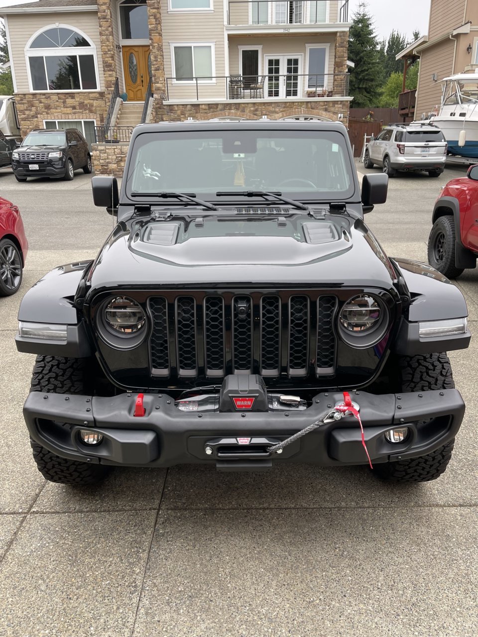

    I have both of best worlds! 2021 2dr Rubicon 6speed with all options custom ordered ;)E81ABFD7-B56C-4D0E-B263-9124FF8A9394.jpg

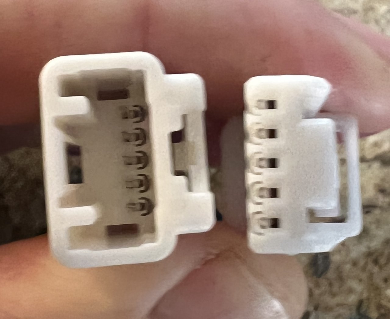

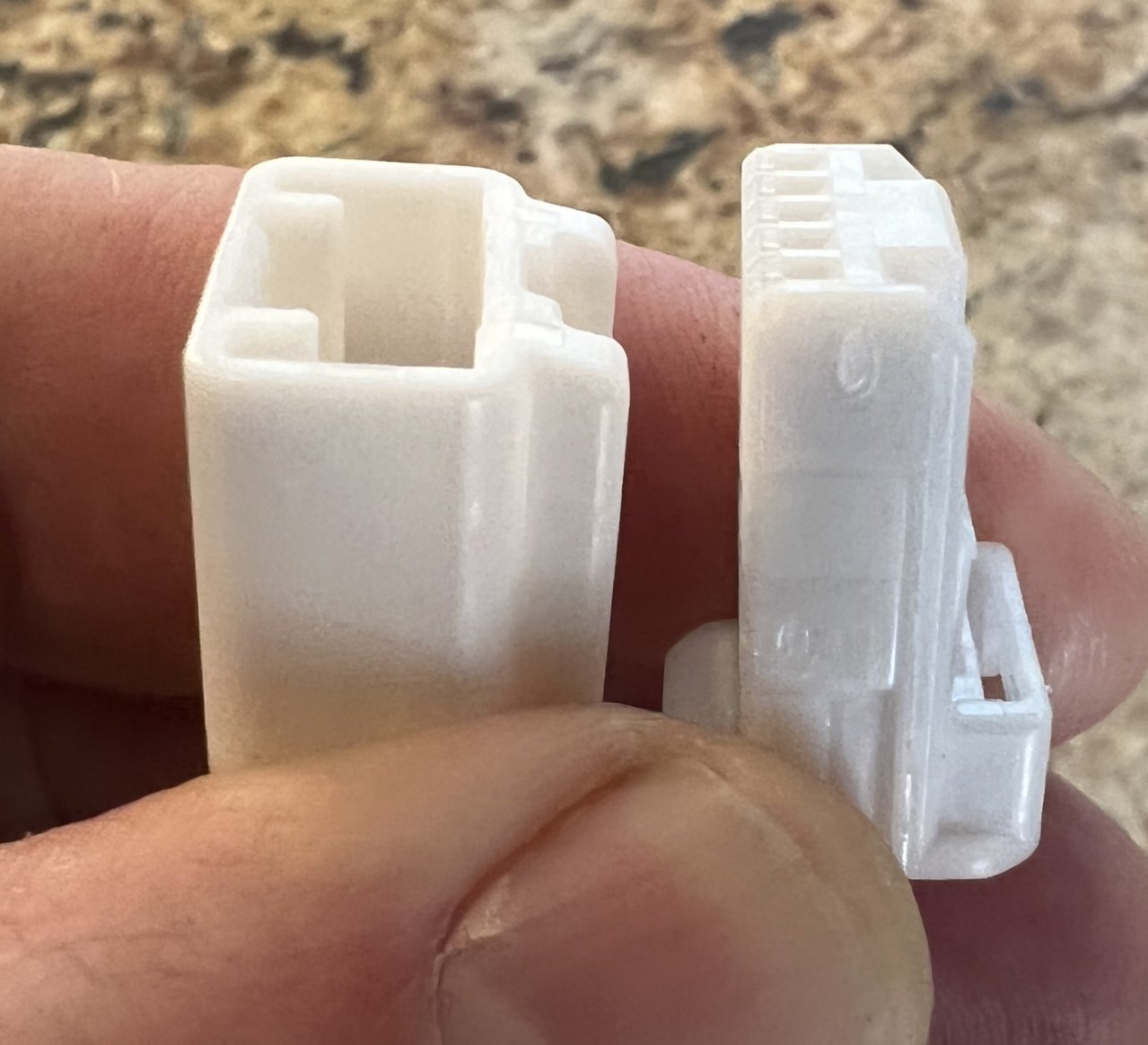

    Anybody try the new instructions on the HUD yes, to see if it works. Awaiting on answer on the adapt a fuse from vendor, that was included in new harness kit.

    What instructions?

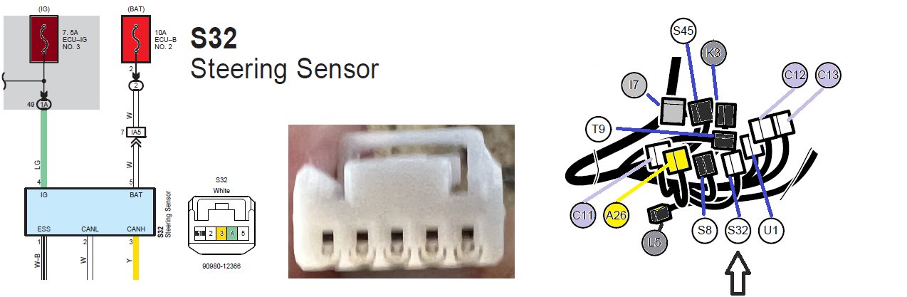

    Would you post a pic of them:
    They seem to be to the steering sensor.

    The Rav 4 connector from the last video posted might be a different style? :notsure:

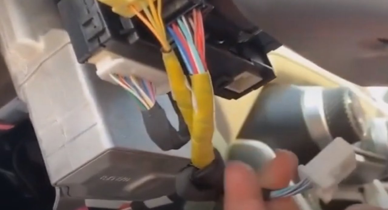

    This is what was sent in an email.
    • We have asked our vendor for the second install but it's really easy. If you turn your steering wheel sideways you will see two screws that go to your steering column cover panel. Remove those screws. That will allow you to remove the two piece covers. Under the steering wheel you will see a oem connector that looks like the new harness we just sent out. Disconnect that from underneath. Plus the new harness in and then the oem one into the new harness. Then just follow the rest of the other install guide that is on the HUD product page.

    The new wire harness seems to be working fine on my 2019. The settings in the picture are still on in kilometers (that's why the speed does not match), but easily changed to MPH after hitting center button/right arrow.
    The install was easy enough to test the unit. I followed the instructions in the Rav4 video.
    It's quite possible the add-a-fuse is a consolation prize for playing. :notsure: Although, the unit does take a few seconds to power down after ignition is cut, which is actually nice to check if doors are closed, etc
    This HUD is almost becoming my new favorite mod! :rocket:
