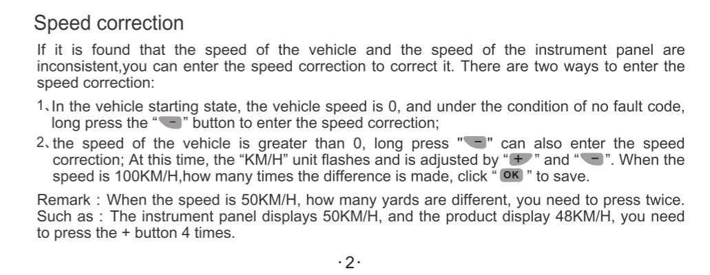

    Okay, I have about 200ish miles on the HUD. So fair enough time to clear up anything or let me know if it's an ongoing issue.
    1. The RPM on the unit will just go in and out for no apparent reason. It could stay up for 30 seconds or 30 minutes before it just blinks off/out. It can then come back up in a few seconds or not at all. Annoying.
    2. The MPH is always 2-4 higher. Even when I set cruise control at 63 and I may dip down to 62 the HUD will display 65-67 MPH. It will also take awhile to catch up when breaking - i.e. when doing a full stop at a stop sign, it takes a bit for it to actually show 0 MPH. If I'm not behind anyone and there isn't anyone else at a 4-way stop the HUD never reaches 0. Again, annoying.
    Anyone else experiencing these issues?

    A delay is something I thought of at first too. But the fact that it's constantly higher than what I'm going doesn't seem like a delay to me. On my way home there is a long stretch of highway that I get up to 63 and put it on cruise control. No reason why the HUD should display that I'm going 67.

    I was going 7 mph while parked in my driveway the other day. :notsure:
    And, yes, the RPM had disappeared, but welcomed back with a push of the center button. I'm always 1-2 MPH off, but it's lower, which is good because my speedo healer for my 285's is 2-3 MPH over my GPS. Go figure.

    From the installation pdf....
    tacoshell88 and tonered[OP] like this.

    I knew it! Chinese calibration, clear as mud. :rasta:

    Just need to add up the 'yards.'
