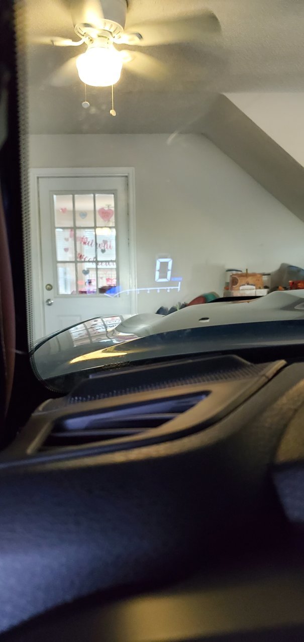

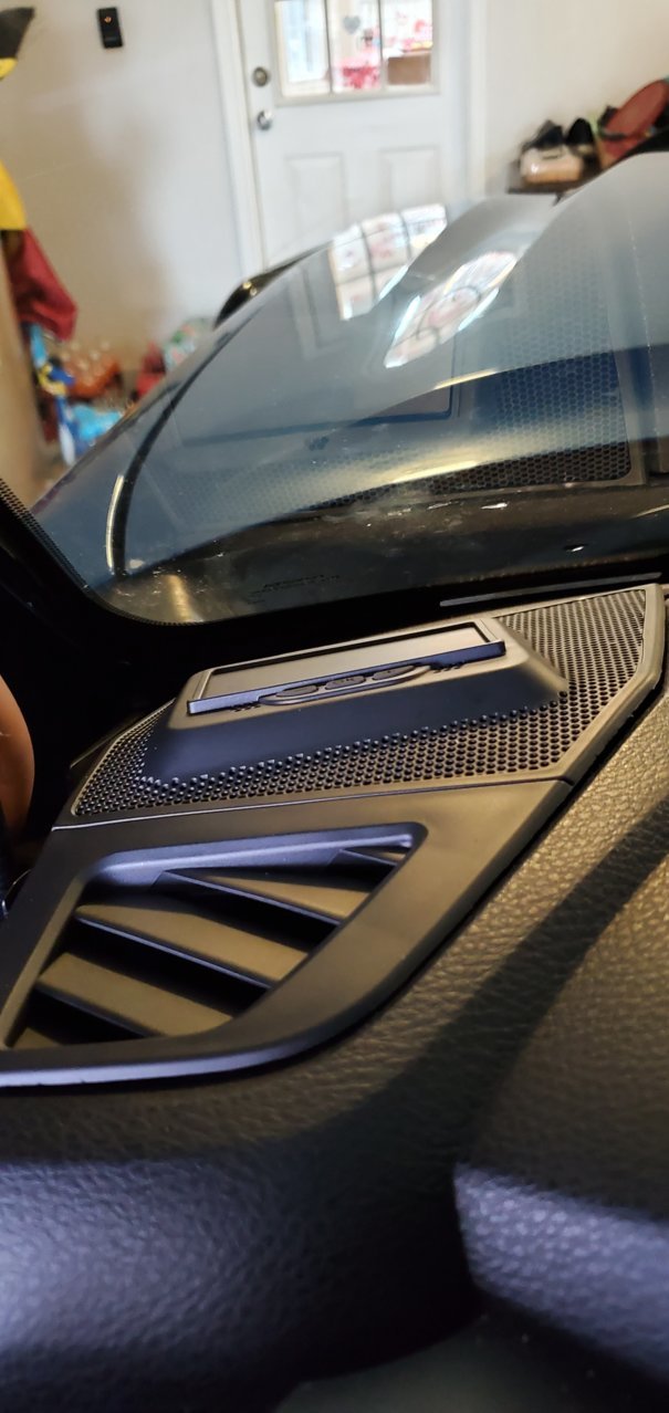

    I FINALLY got around to getting my HUD installed. It's not perfect, but it's not terrible little item. After getting it installed, I was expecting a round 2 with re-installing the grab handle (as in giving me fits). But the bolts went in with no issues. :bananadance:
    I can confirm that there is about a 2-3 MPH difference between the dash vs. HUD. The interstate driving seems to be a bit more difference too. At least for mine, I was pushing between 70-85 MPH. If I was around 80, it would read 74 or 75. So this require some more testing on longer drives to see any real differences.
    My only real legit complaint is the housing wasn't 100% flush against the dash. Doesn't keep it from working, but small irritation of mine.

    Could it be your speaker causing the issue with the fit? You had mentioned something about non-OEM tweeters a few pages back.

    i have subaru tweeter upgrade and HUD fit very well

    What @poroto said. I have same Suburu tweeters. And bolts are tightened down as much as I can. Like I said, more an irritation of mine that it's not flush. :notsure:

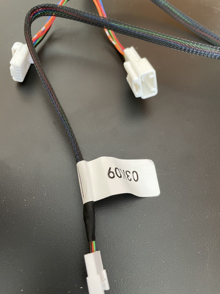

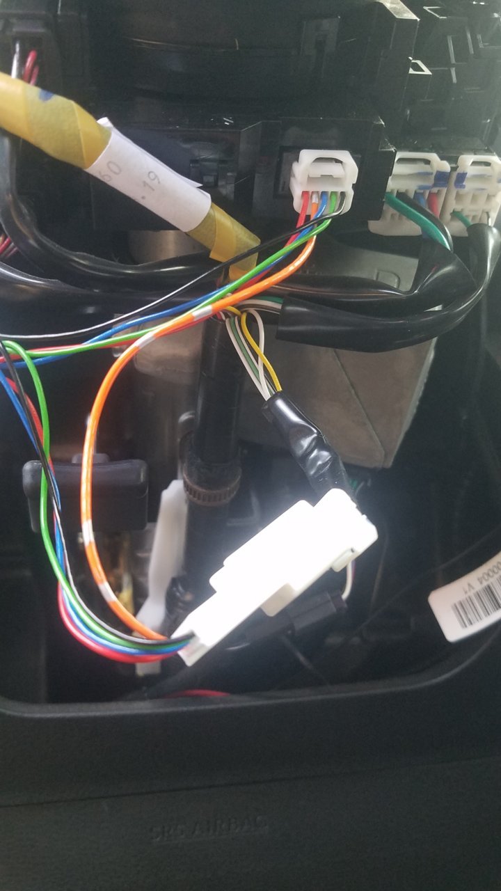

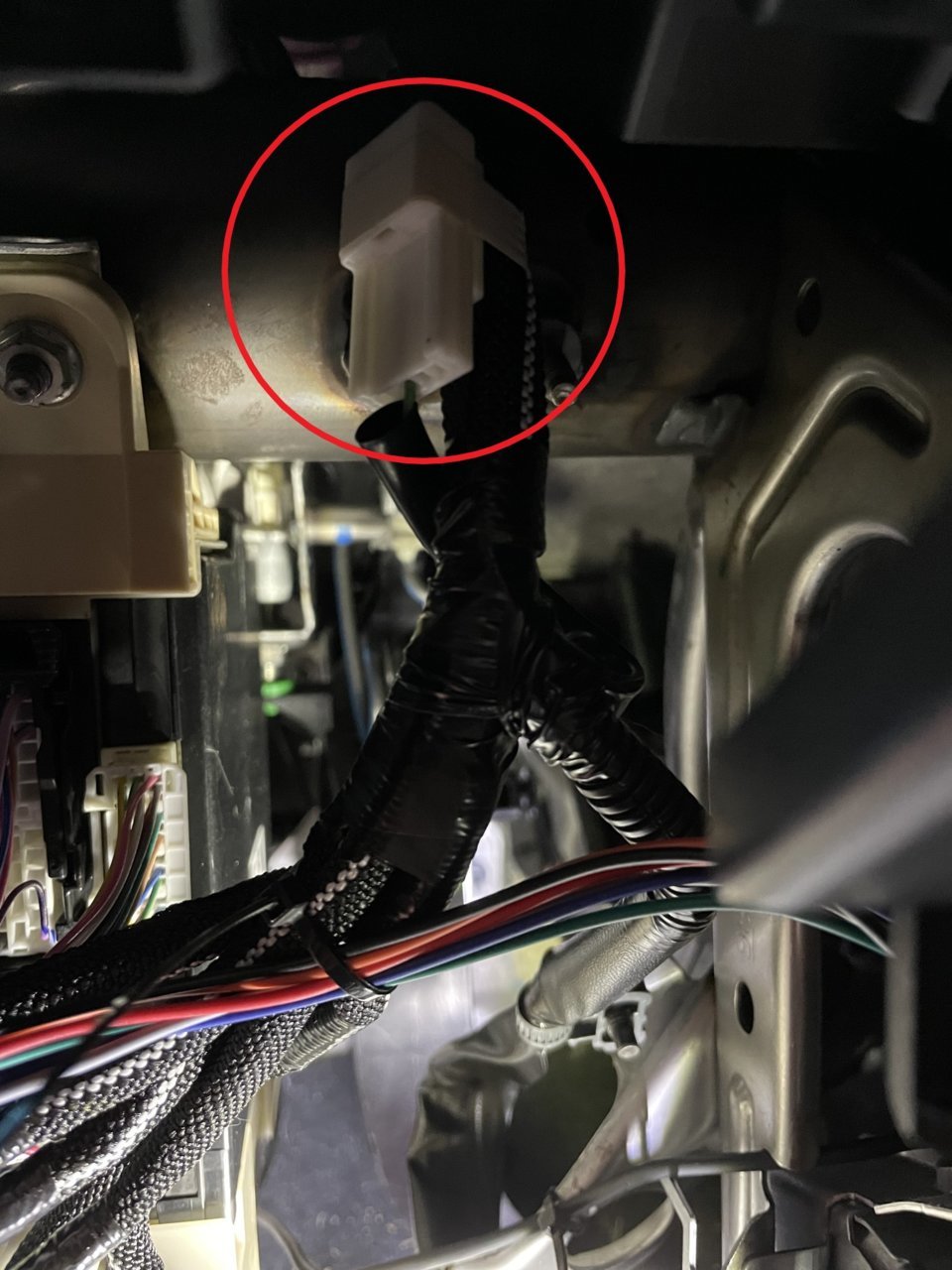

    Has anyone installed the HUD on a 2020? The OBD port directly just gives me voltages until I start up the truck then its a blank screen. I took the dash apart to find the connection for the extra cable and there is no connections I can find with enough cables to make it work (there is one with a single wire going to it that has nothing attached to it so I don't think that is the one).

    Doesn't the 2020 need the new cable she has been sending out that connects just behind the steering wheel?

    I'm fairly sure. That's what I *think* I have (labeled 03K09) that came with mine (delivered last week).
    Unfortunately, it's all a guessing game since the installation instructions are lacking. I just cannot find where it is supposed to connect.
    EIDT: took the dash out and there isn't anything back there that matches this either. :/

    The plug is located under the steering wheel. You need to turn the steering wheel to access the two screws.
