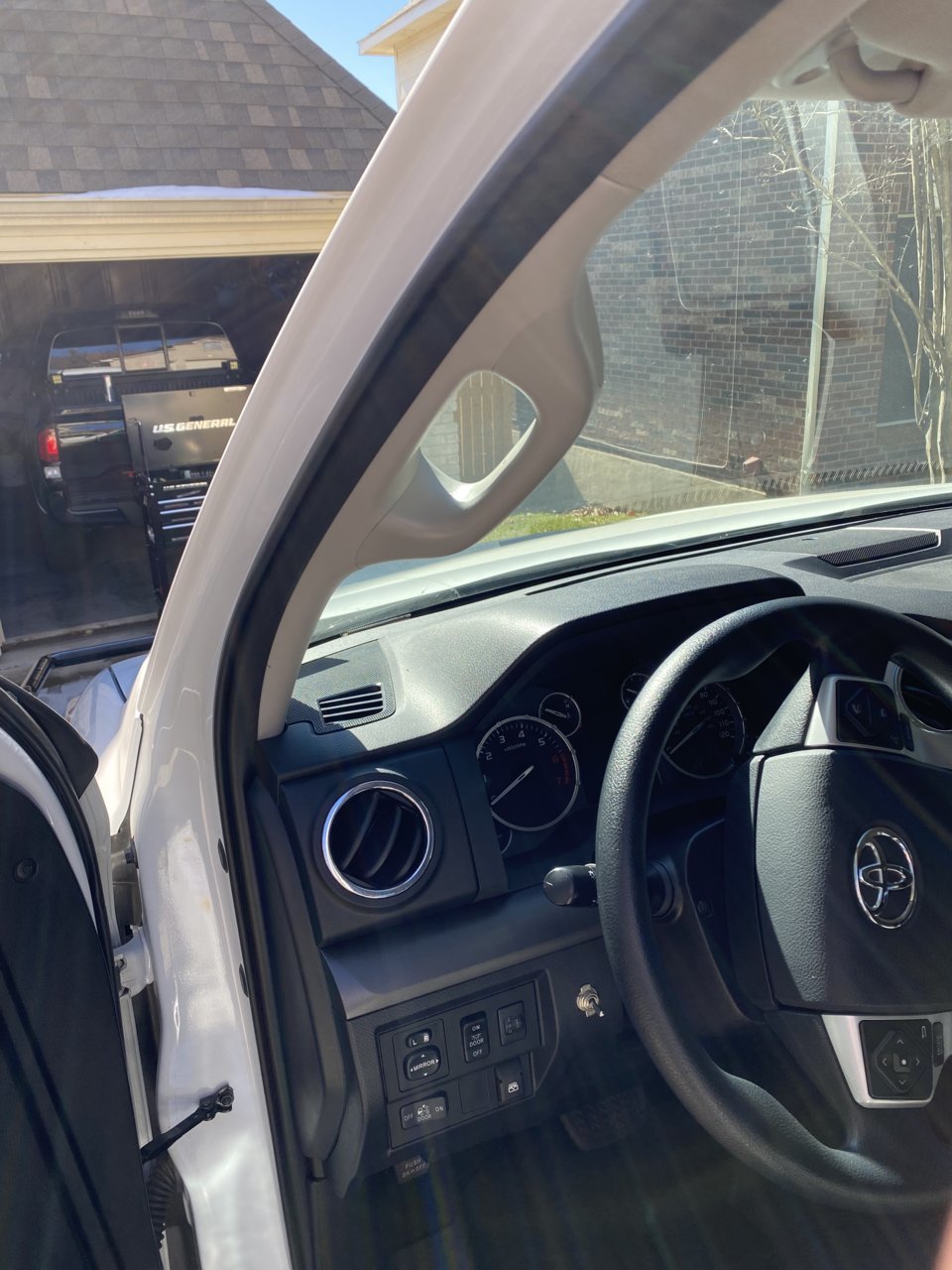

  9. Feb 7, 2022 at 8:55 AM
    #5849
    spadoodle
    spadoodle Well-Known Member
    Jan 2, 2022
    #386107
    66
    '17 AC SR 4x4
    Ah-- disappointing but YES. Frustrated every time I get in or want to lean out the window to look.

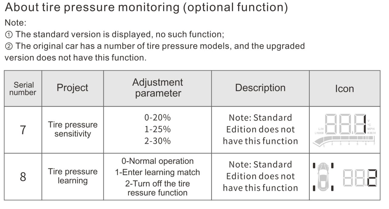

    Trying to figure that one out myself. Really don't know if our HUD has it. I can get them to show up in RED and be solid.
    Tire pressure learning
    The tire pressure learning needs to be studied under the condition that the vehicle tire pressure is
    normal and there is a 1KM straight road.
    (1) Entering the tire pressure learning state:
    When you first loading, the product is turned off by default when you first use it. If need to use
    this function, you can enter 8 of the parameter setting mode, select 1, and then exit.
    (2) Tire pressure learning:
    In the learning state, the continuous straight line travels about 1KM to complete the learning,
    the device will automatically return to the normal working state, and the buzzer will have an
    audible prompt;
    A) The tires of the model are not displayed under normal conditions.
    B) The four tires of the car model in the learning state are displayed in red and are closed
    in urn according to the learning progress.
    C) The abnormal tire in the abnormal tire pressure state is red and blinks.
    (3) Sensitivity setting:
    Select the tire pressure sensitivity by entering 7 items of the parameter setting mode
    How to deal with the tire pressure alarm
    When the tire pressure is abnormal, the corresponding tire symbol flashes with the car and
    emits a "Bi~Bi~" sound. At this time, press any key to turn off the alarm sound, but the symbol
    is always flashing, and the tire pressure is normal, stop the alarm.
