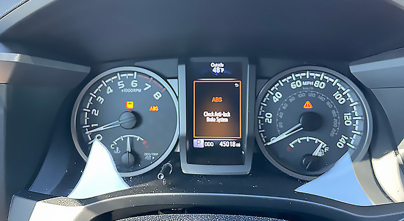

    Sad day, my HUD brothers...
    I drove over the same train track I do nearly every day, but today I got the gift of an early Christmas tree display (with sound!) and the HUD was blank. I pulled over, turned off the truck and back on... then Christmas tree w/ beeping returned. So I took off the steering covers and checked the wiring harness, it all looked intact. Nothing loose, nothing hanging or exposed wires. But to be safe, I unplugged the harness and restored the original plug into position. Drove home. No issues. Drove around more, no issues. I believe the culprit was the HUD. I've now removed it and am moving on with my life.
    Good luck, hope this doesn't happen to you.

    Smart move binning that POS.
    Giving KTJO 4X4 :puke: direct access to an OBDII in your truck is like giving Putin or "The Panda" the passcode to our nuclear launch codes. Here I am binning an MB ECU and an Overhead Console for sparking a frikkin dome light and blowing a 7.5A fuse totaling well over $2k in dealer costs and to think that HUD has direct connectivity to damned near every onboard ECU in the truck. Thanks....no thanks!
    EDIT FOR RANDOM THOUGHT: Anybody here wondering if she's covered for bricking someone's electrical system due to poor design or QC issues? o_O

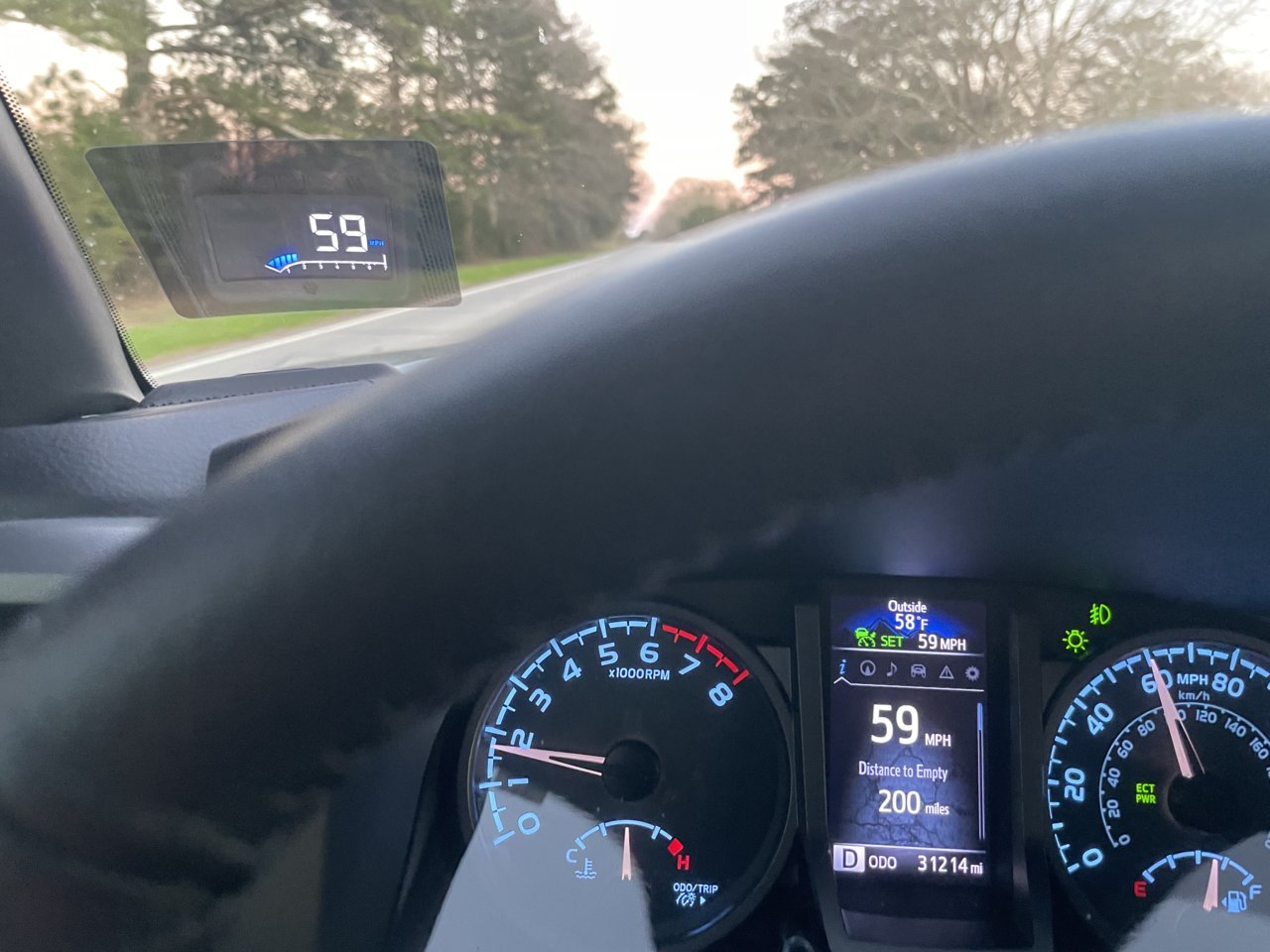

    No issues at all. All functions working. Set the cruise on and checked between all 3 display’s 38AA5C34-3B02-4F79-94FB-9924D74024A6.jpg

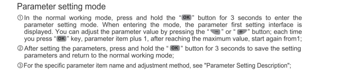

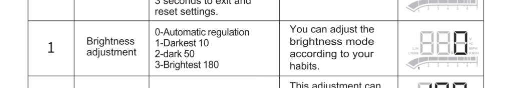

    Is there a way to adjust the brightness of the HUD? I was driving home last week during a heavy rain storm at night, and I run the dash lights at like half brightness. Wasnt sure if there is a way to dim the HUD?

    Thank you!
