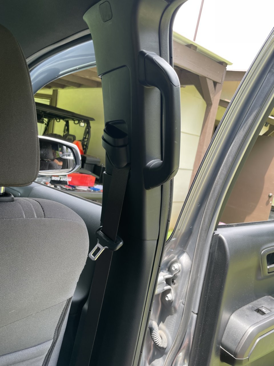

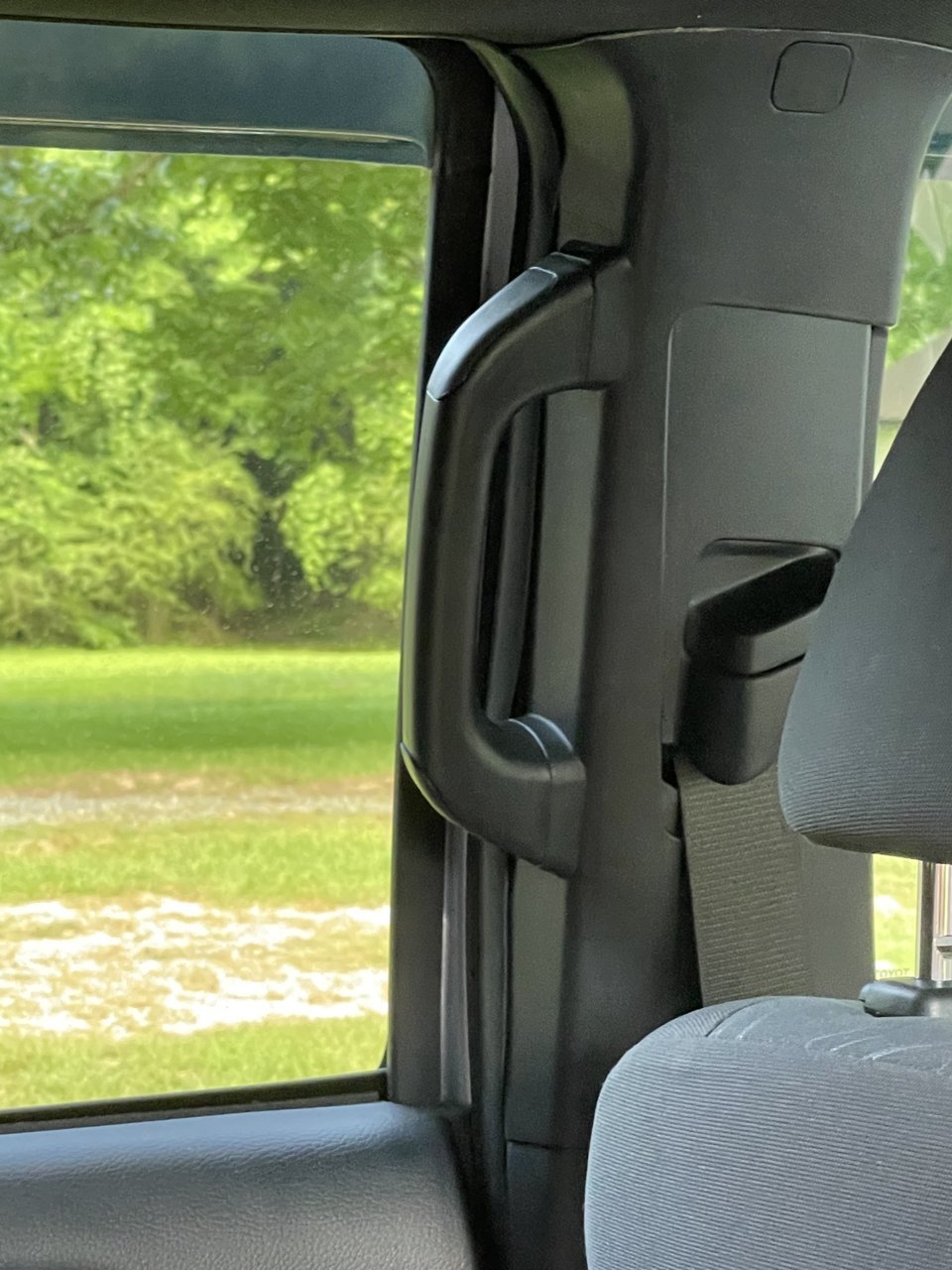

    They fit just like factory. Color matched pretty well to me. Could not tell any difference at all. The quality seems fine for the set I received.

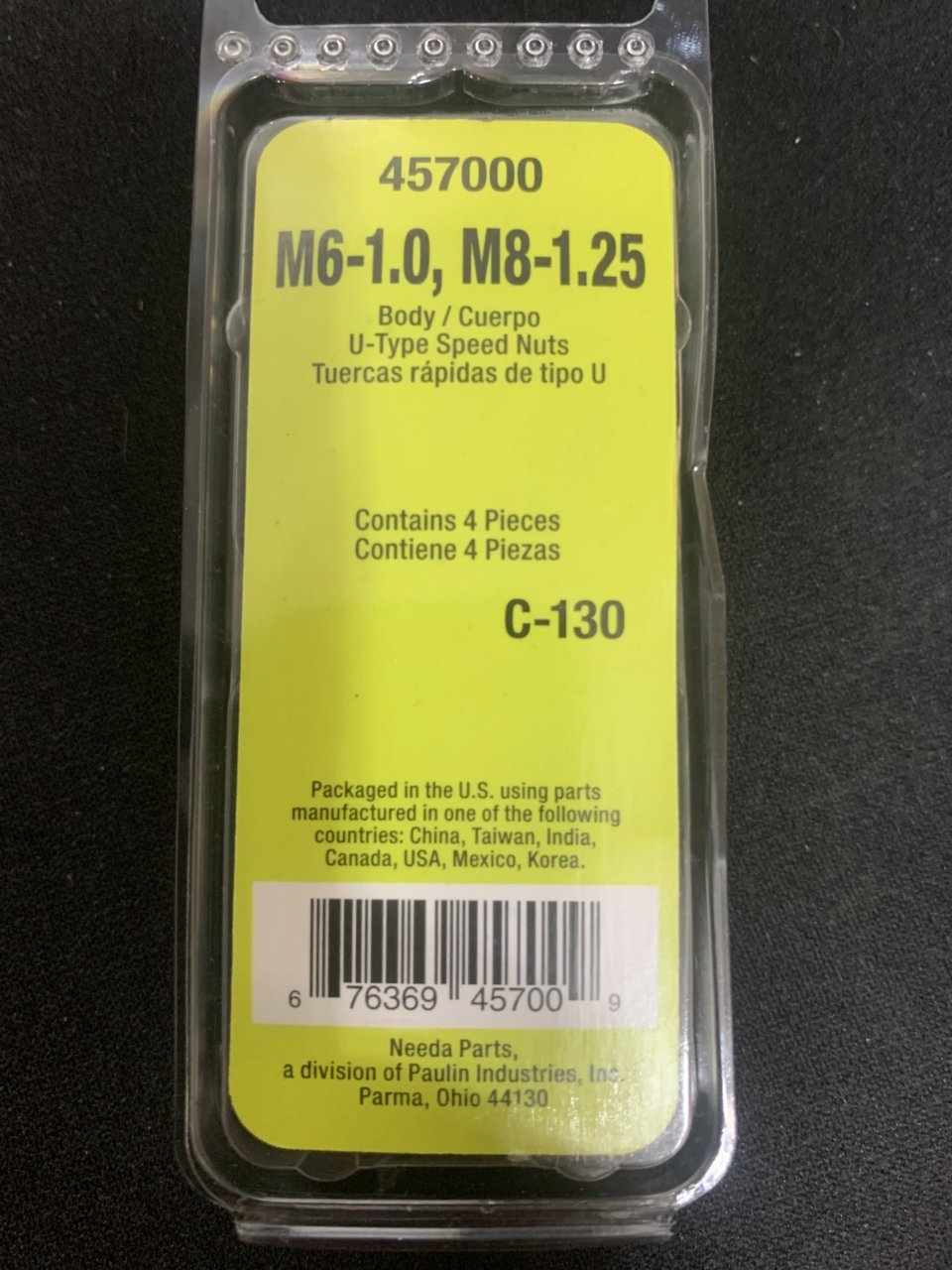

    I did buy a replacement clip nut from Autozone ($4, M6x1.0) that has a protrusion that fits into the bracket hole and doesn't allow it to move when trying to line up the bolt. Others have had issues with the provided clip nut failing and/or moving.

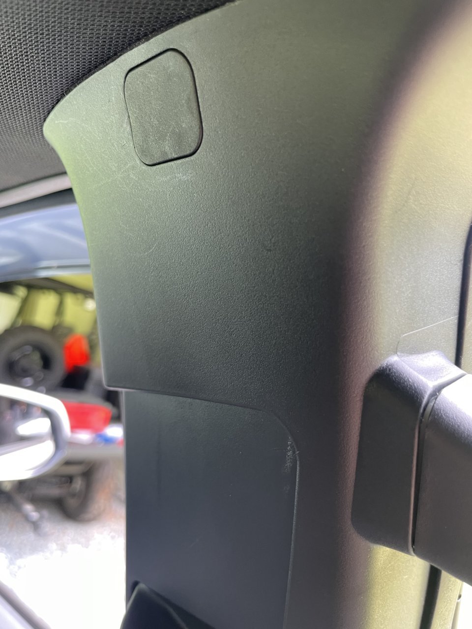

    Does anyone know the Toyota part number for the lower bolt hole snap-on cover?

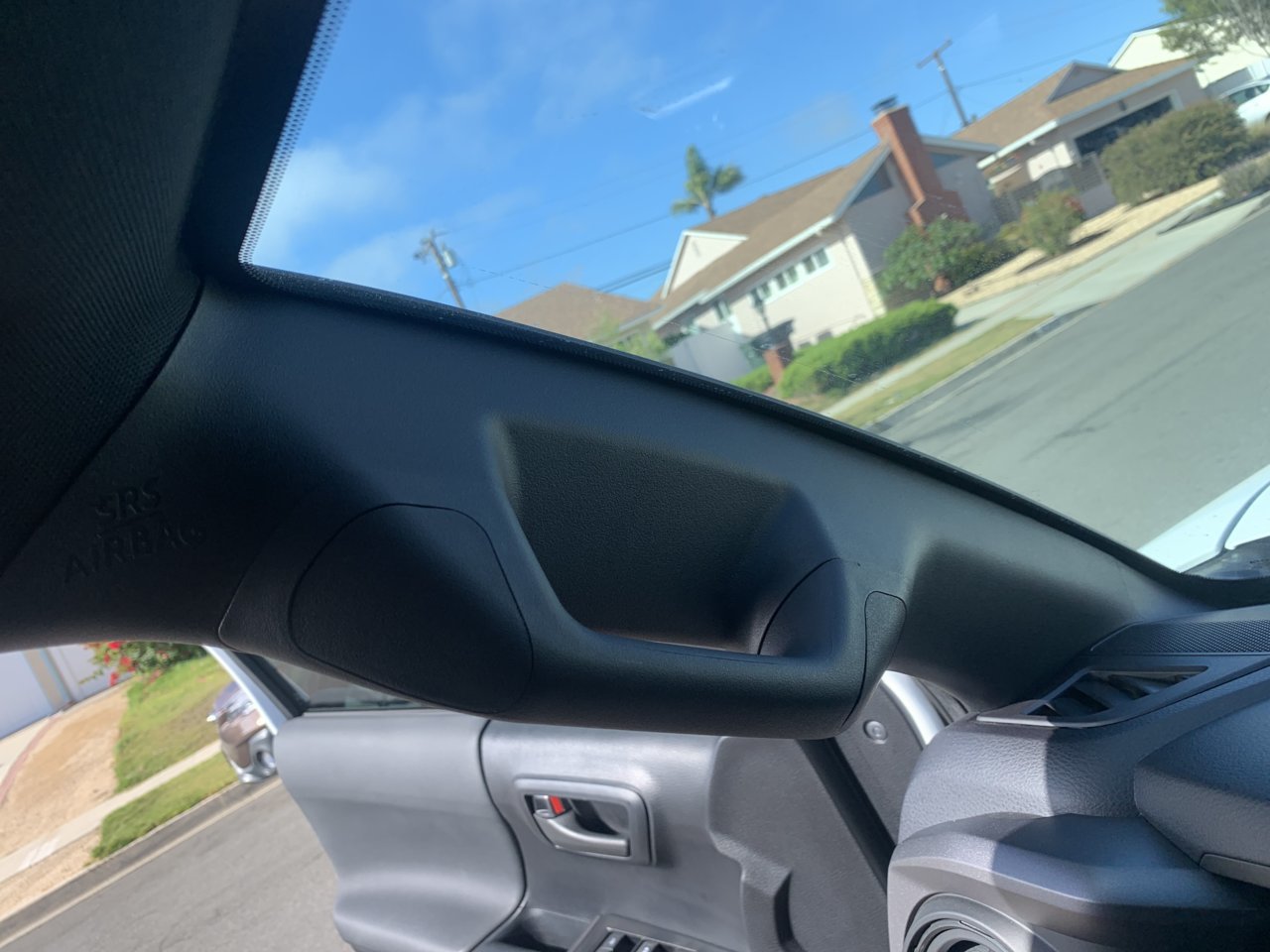

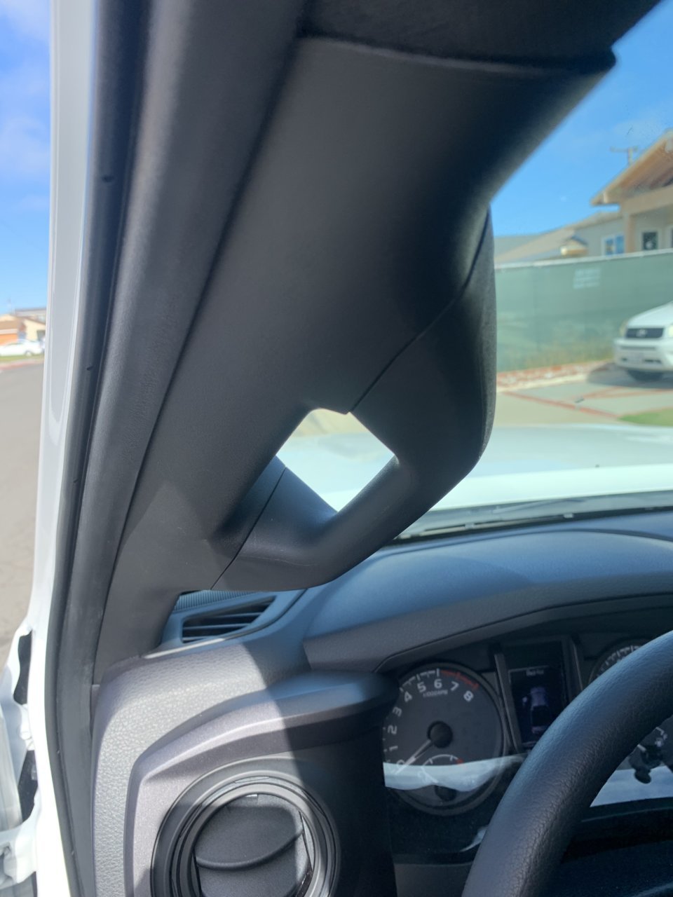

    I thought the passenger side handle covers will work. No?

    Pics please.

    No, sorry. If you take a look while inside your truck you will see that they are not even close to the same.
    Ok, thanks.

    So I bought the m6-1.0 Clip ( came with 2pcs.) from AutoZone and followed the video on YouTube...I had it installed in about 30 mins...the bottom bolt went in easily after a few trys ...DO NOT TIGHTEN IT JUST GET IT STARTED THEN MOVE TO THE TOP BOLT THAT ONE WAS TRICKY...I HAD TO TWIST THE ENTIRE PIECE AND VISUALLY SEE THE SCREW GO IN...Big screw in the bottom,small at top!!!!
    Then I tightened that Mo***r***ker down!!!!
    No way I would try that flimsy piece of crap clip that was provided..GET THE ((---≥≥≥ M6-1.0 ≤≤≤-)) piece and it will be a quicker install!!!!

    IMG-2369.jpg Yes, get the replacement clip. Pictured is the version I bought at Autozone.
    I also did the lower bolt first then the upper bolt.
    To get the upper bolt started I had to twist the handle up and forward.

    No. But if it's a loose fit, put a small piece of dum-dum (tacky rope caulk that never hardens) to hold it in place. I put a piece on my top cover. It works great and will still be removable in the future if necessary.

    I used some super thin double sided tape to help my cover
