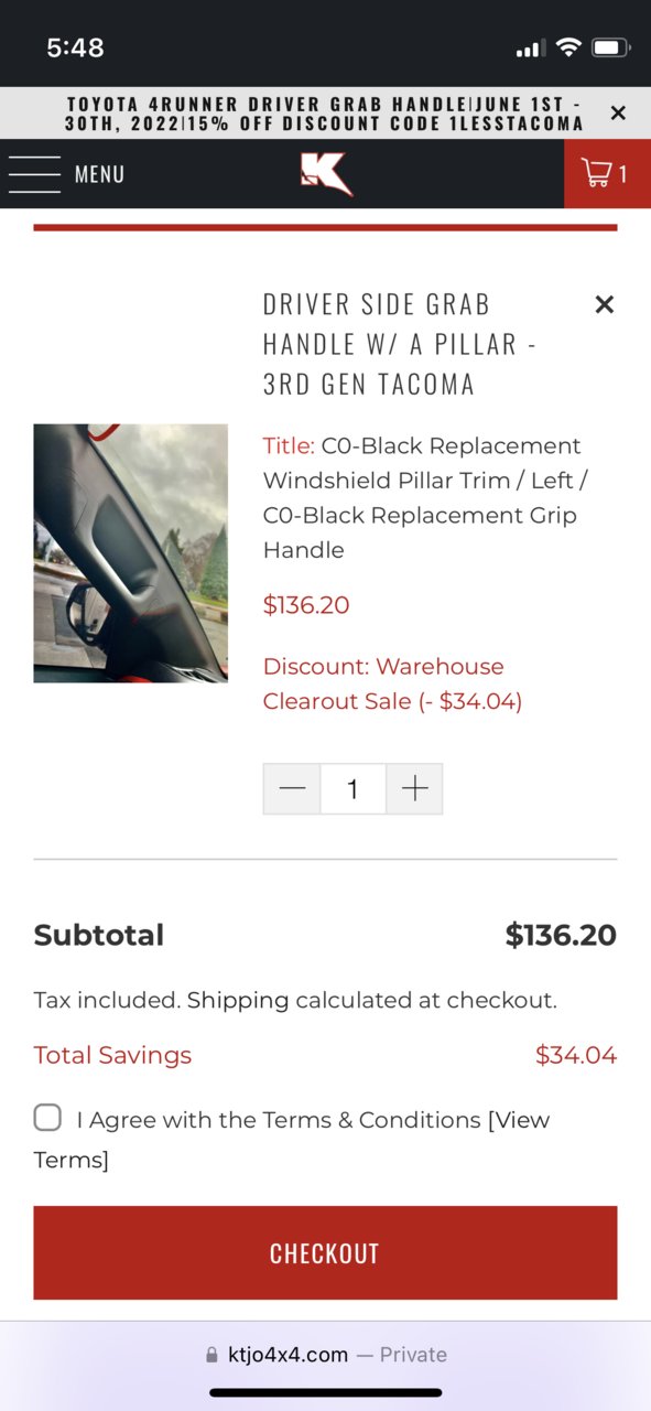

    It doesnt show discounted on the main product page, but after you add it to the cart (this is the “non-clearance sale” one)…

    Thank you. I wonder what the warehouse clearout sale is for. Newer model, perhaps?

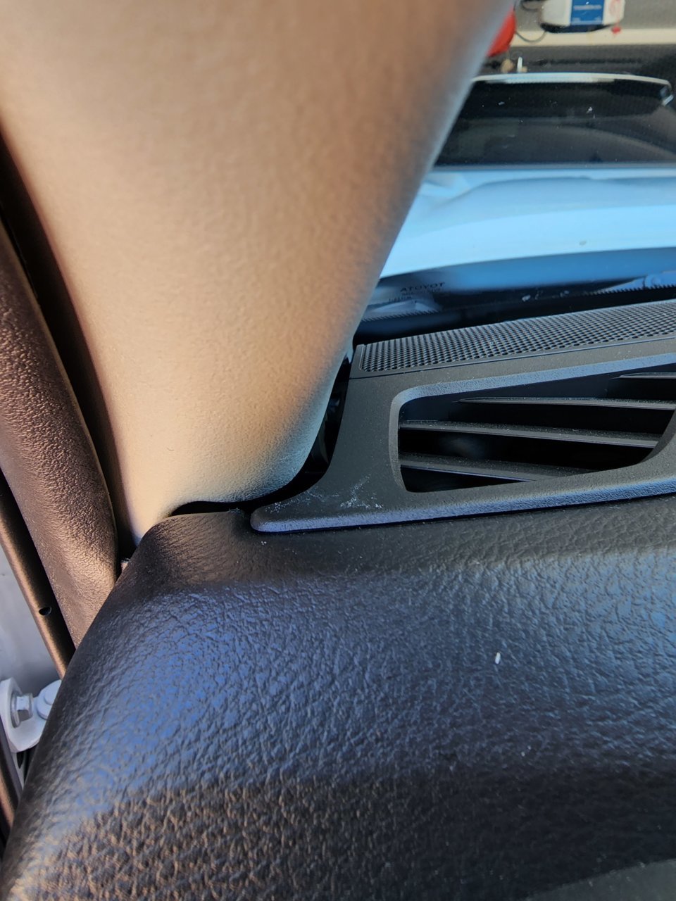

    got the infamous grab handle. fast shipping aswell installed in <20 minutes.
    followed tips of buying autozone speed nut and bending the top clip to fit.
    everything is an exact match except the gap by the dash now + rough edges on the screw covers.

    I had the gap, too. I put a spacer behind the boss in the pillar cover and it looks pretty good now. It really is a great idea by the supplier, but it is really poor execution in so many ways.

    You don't have the tangs on the bottom in the slots.

    are you saying i installed it wrong and there should be no gap? like the bottom feet/pin didn't go into the slots on the bottom?

    Exactly, Tab A needs to go in Slot A

    Yep. You gotta angle the pillar trim outboard past the door seal to get those tangs to go where they need to.

    wow thanks just redid it and no gap now.

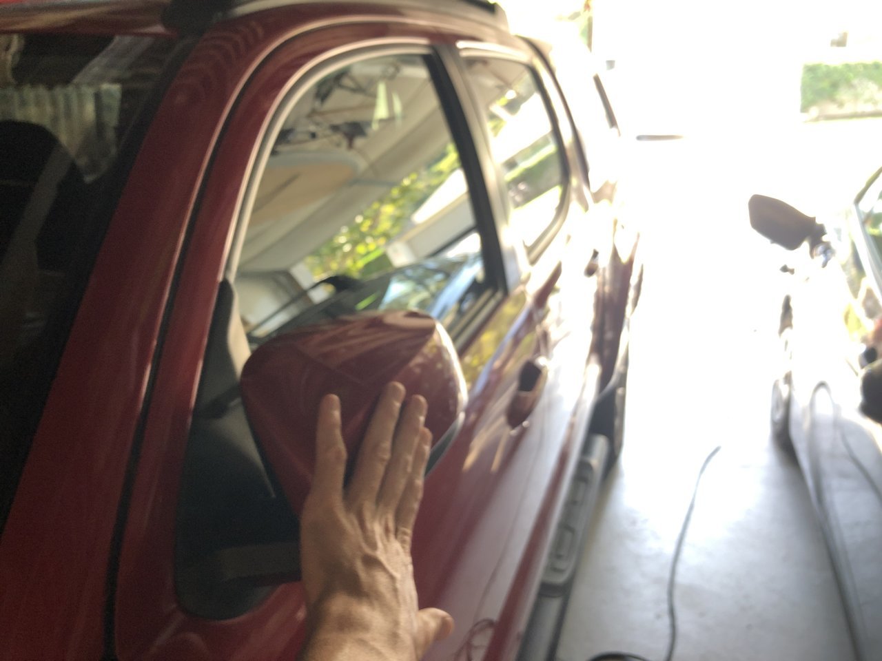

    Anyone install the folding mirror kit?

    I use the OEM one. Works better. Ask me how I know.
