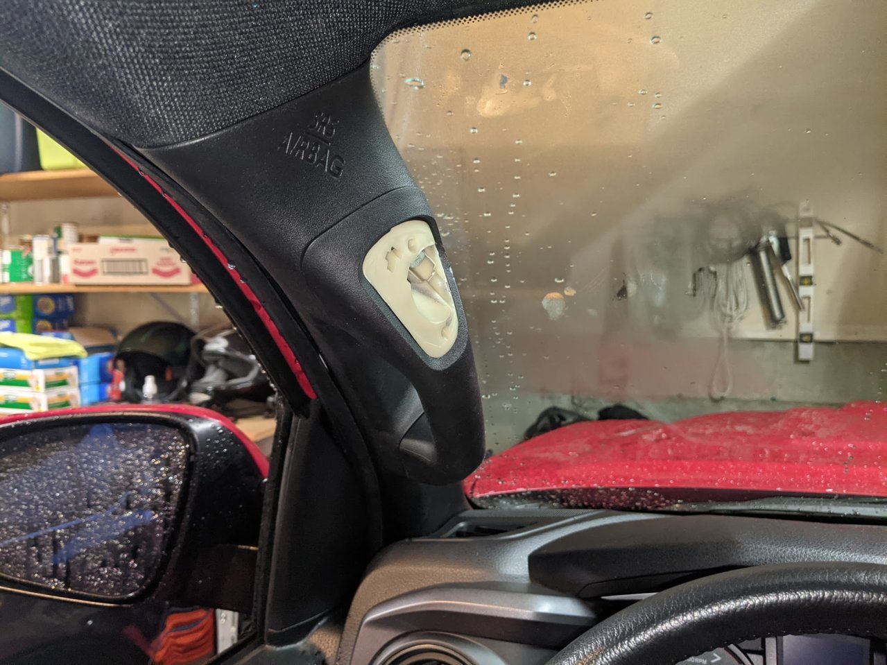

    I received mine yesterday and went straight into the install. I didn't use the clip nut and opted instead of an M6 riv-nut, as I think that's a stronger option. If I assemble it loose, with nothing actually seated in place, I can get the top bolt in. There is nothing I can do to get the lower bolt even started. The angle is way off. I can't even start the bolt with the handle not in place. The riv-nut sits flush against the sheetmetal, just like the clip nut would have, so I don't see why it should be different.
    I also note that the edge of the pillar isn't completely straight. It bows in in one section and I can see the edge of the airbag between the pillar and seal (visible in my photo next to the bottom of the handle).
    The part seems well made enough, there just seems to be a problem with the fit. With the top bolt in place, it feels quite solid, but it seems sketchy to leave half the fasteners out.
    https://imgur.com/a/df2qExt

    Same as mine before I bent the upper clip. I had no issues with the lower clip, but there is something off on the design. No one ever posts issues when doing all the tweeter upgrades and such. So, the OE parts took into account the proper interfaces. This kit was based on some far end of the spectrum and most likely not verified across several other Tacos, if it was reverse engineered.
    Yeah, bending the clip(s) sucks and leaves a bad feeling behind.
    Also with that gap, you'll also probably notice a tapering gap where the trim meets that headliner in sunlight. It is subtle, but was annoying. Not seen when I used the flash for the pic.

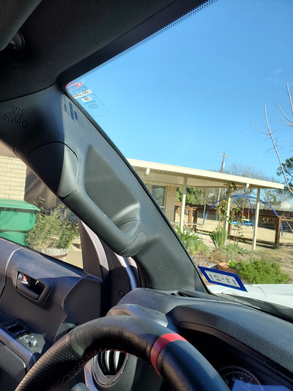

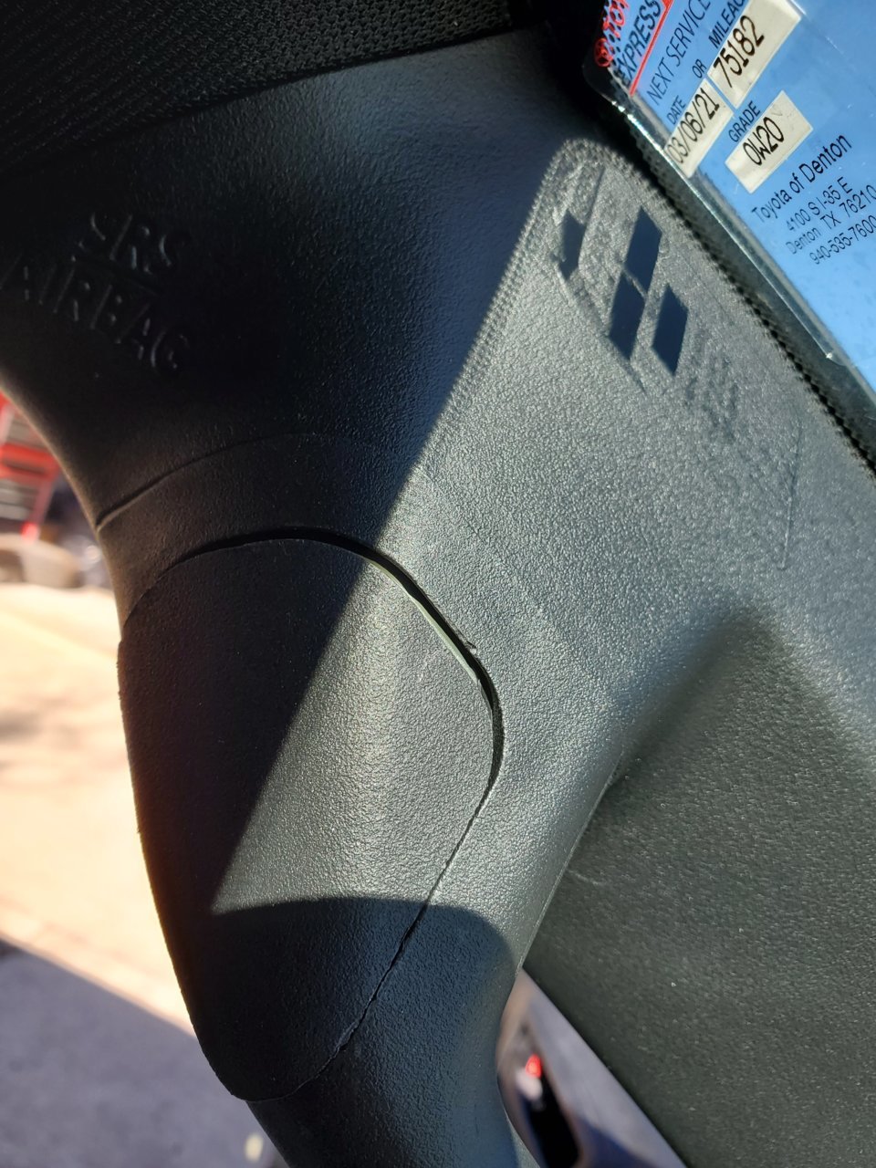

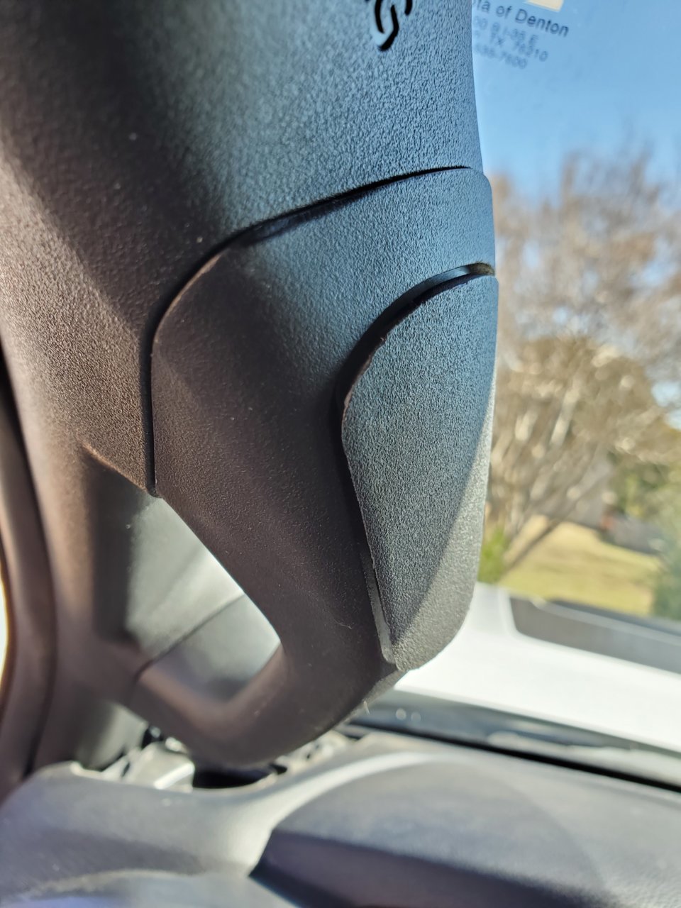

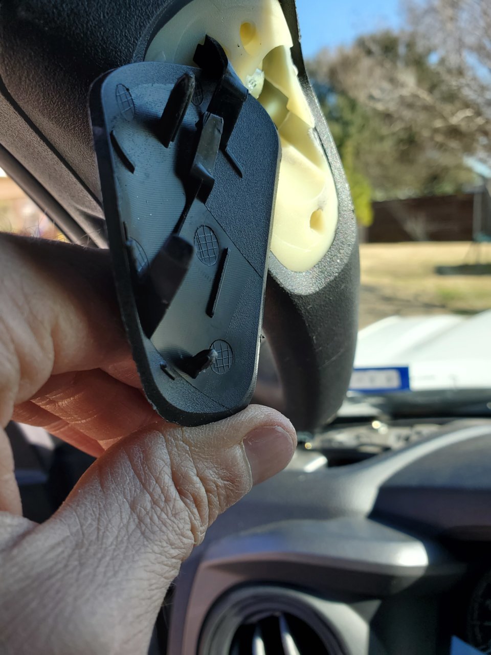

    all done, went ok more or less, about 15 minutes and it's in nice and solid.
    anyone have a suggestion for the upper flap not fitting well. any suggested solutions aside from a drop of adhesive?
    agree with @tonered that it's not OEM quality. i don't mind so much but I'm not used to having that deficiency right in my face every day.

    I wonder if a little heat would make it more pliable and maybe mold to the handle better...

    Exactly, You can heat it up and bend it to shape to fit the handle better. I pressed those tabs out, so they were more secure. I also dropped a dab of superglue on the small alignment pin, and pressed it for 10+ seconds while it set-up. Anyway, that's how I got the lip of the cap to sit flush. :notsure: GL!

    Be sure that you have the three pins / clips going into the right spots. One goes in the guide hole, and the two others go down the bolt hole.
    Is that scratch on the pillar trim on the part out of the box?
