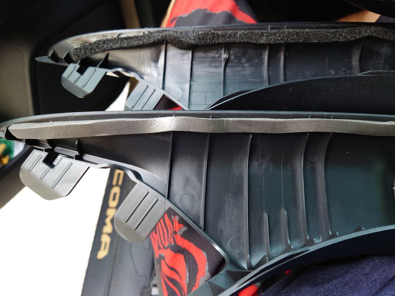

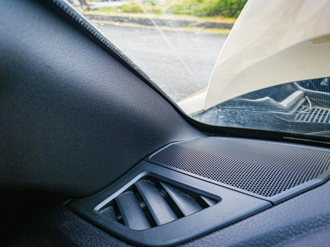

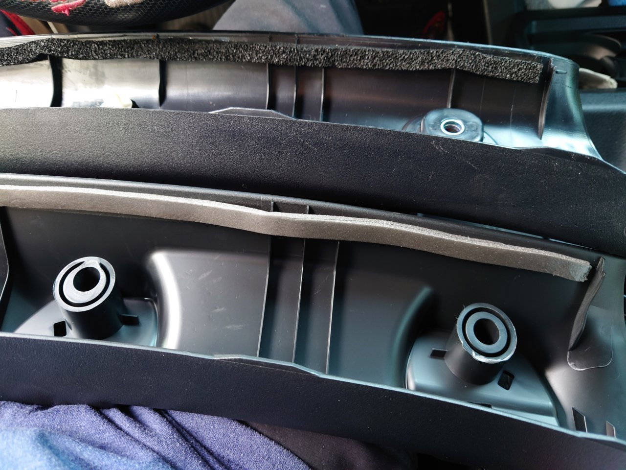

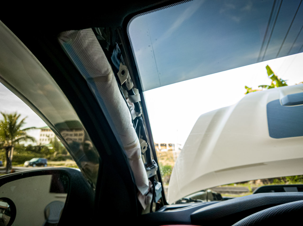

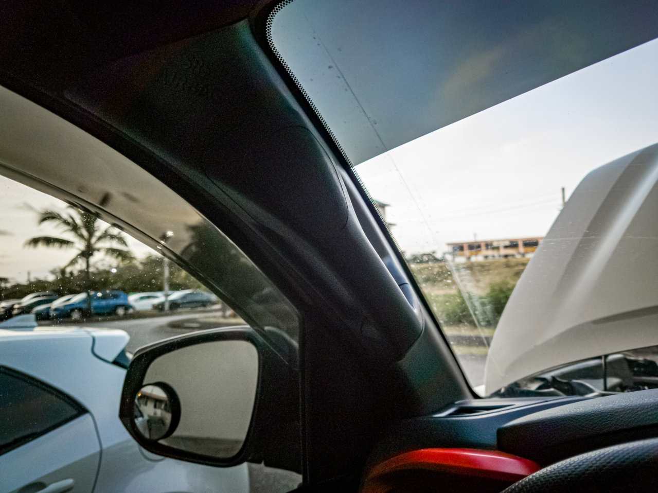

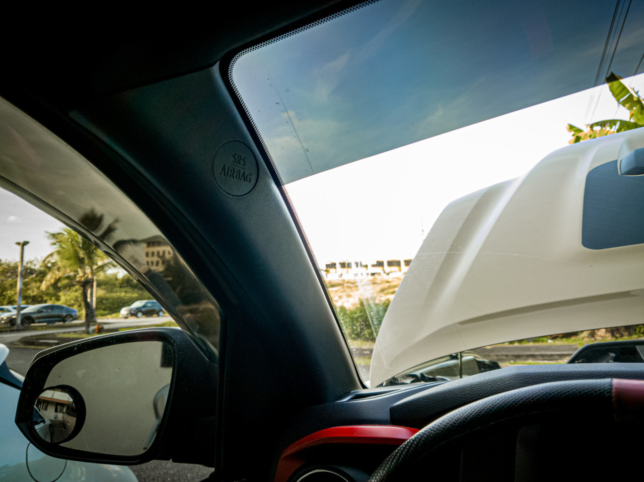

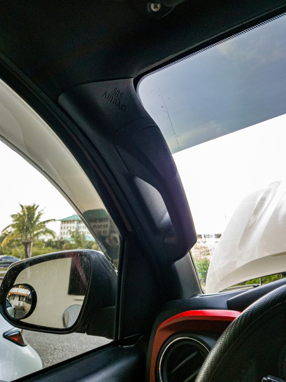

    So I got around to installing mine. Had to go to a local hardware store to get the clip nut, heavy duty compared to the cheap one in the package.
    I have taken apart that A-pillar so many times, that the Install took no longer than 15 mins.
    Added some weather stripping to mimic OEM. Sadly i don't have the exact same type Toyota uses.

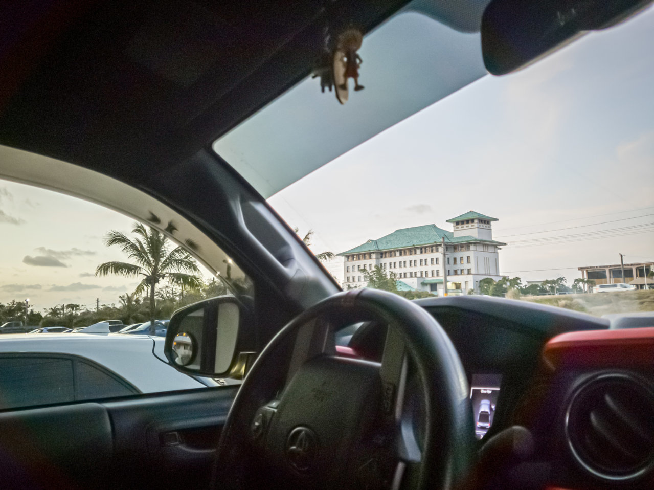

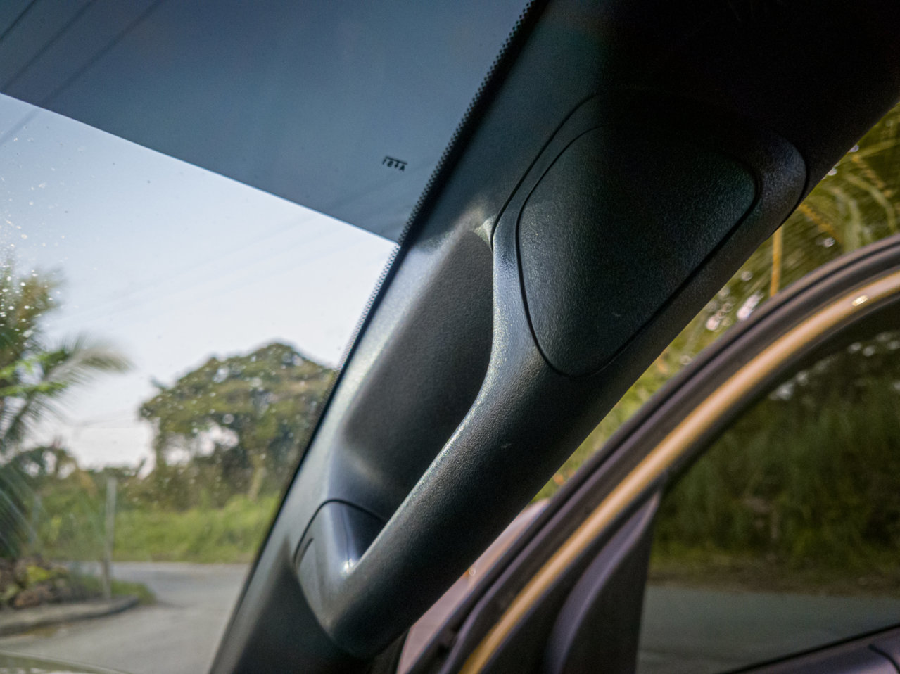

    Finished!
    Now I know everyone had their torches and pitchforks at the ready, but... I am actually very happy with it.
    Honestly, other than the clip nut, I think the fit and finish is on par if not better than the OEM grab handle on the passenger side. I also have MESO's puddle lights, and it would bulge with the OEM A-pillar, but doesn't bulge with the Grab handle's trim piece.
    My OEM handle isn't exactly the same texture, finish or even shade of black/darkgrey as the A-pillar trim panel. It also isn't really flush either, since the handle joints are slightly smaller than the area it attaches to on the A-pillar.
    Also had zero issues with the install itself. Getting the bolts through was easy. Then getting it to sit flush up at the tweeter speaker is the same as you would for the OEM A-pillar trim piece, aim the trim piece at a 45°angle then pivot in.
