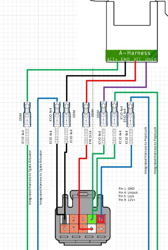

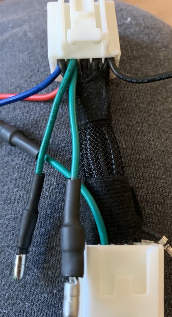

    UPDATE:
    1. Order has been placed for the Tailgate Opener Integrated Harnesses - 200 QTY
    2. Ran into a little hiccup with the Dual Socket Butt Connectors and having to purchase them from two different places but in two entirely different quantity amounts that didn’t make any sense. Therefore, I have made some adjustments and I ordered some Green Dual “V” Wires to replace the Single “V” Wires - 100 QTY and some Black Dual “V” Wires to replace the Single “V” Wires - 100 QTY. (I’ll order more later)
    Here’s a look at mine during one of my modification phases showing the Green Dual “V” Wires on the one side.
    Here is an updated Wiring Diagram
