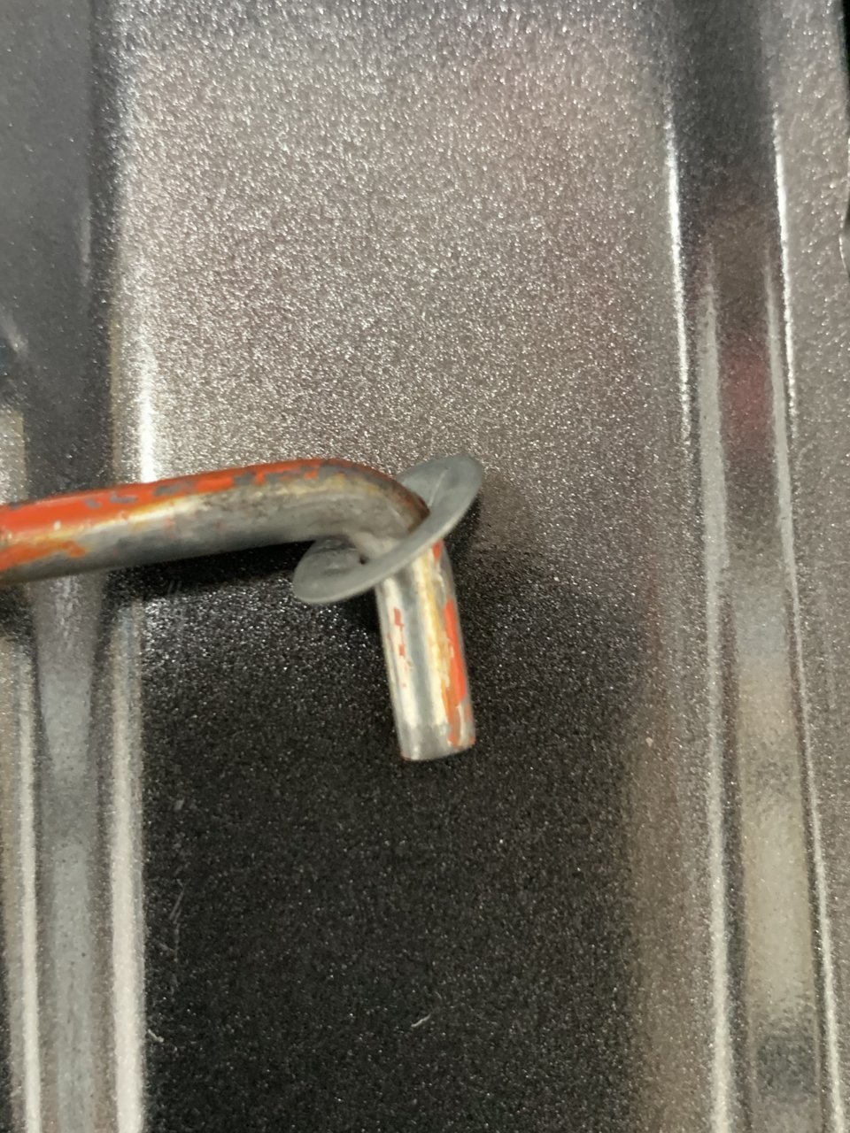

    I’ve had some questions lately on how to install this on the Rod and that it is simply too big.
    If you take a look at this picture here
    You will see how it is not flat. You need to make it flat by using some Needle Nose Pliers or whatever you want to use that will do the trick. If you don’t get it 100% flat that is fine. You really only need it to a point where it will grab onto your Rod and be snug. When you get it to that point, make sure you are ready to not take it off because it will be on there. Trust me!!!! That little thing grips on there and it stays.

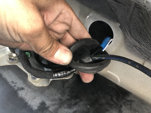

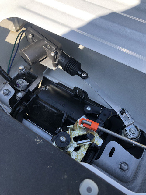

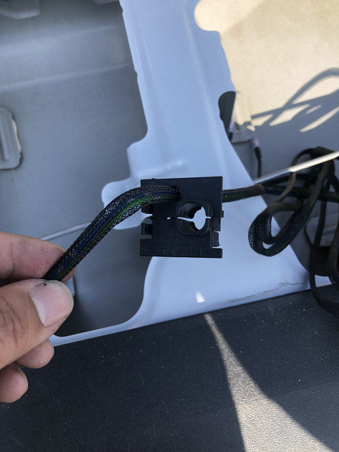

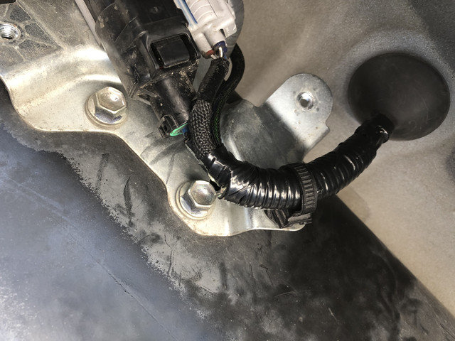

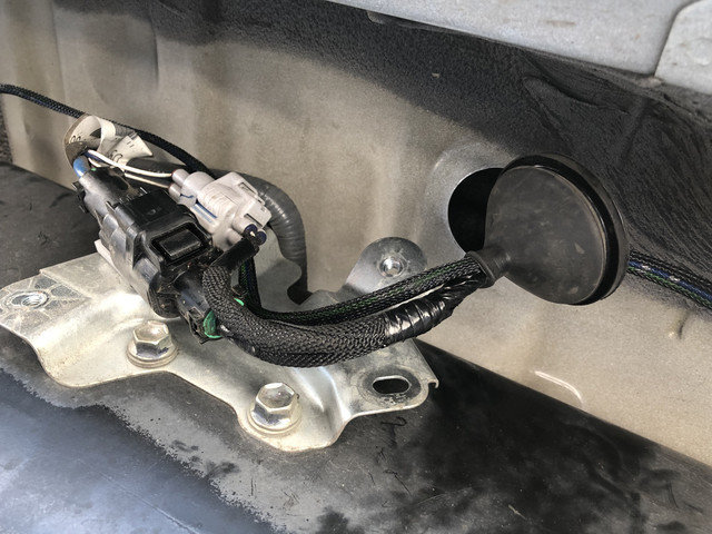

    super quick shipping. i did the install today and it was very simple. ran into no issues at all. took about 45 minutes, mostly because on the grommet for the cab i decided to take apart the oem wire loom (basically un-did the electrical tape, then ran the wire loom through with the oem wiring, re attached wireloom and taped back with electrical tape) so i can have a even cleaner install and not poke a hole into the grommet. i could have done the same for the tailgate loom but it didnt look so bad the way i did it, maybe in the future. i took some photos for reference:

    Great Install Photos!! Wow! Once I come out with the dual Harness protector this will be an absolute perfect install! Textbook :thumbsup:
