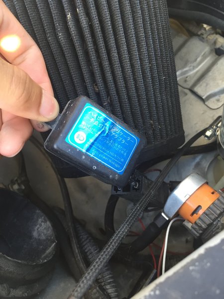

    Ever have issues after install with the high beam indicator in the gauge cluster not lighting up?
  5. Oct 22, 2015 at 8:27 PM
    #465
    bellassaiw10
    bellassaiw10 Formally afroman5015
    Jun 16, 2010
    #39032
    5,531
    Currituck NC
    09 LMM 2500HD Duramax
    Yeah it won't work unless you have a piece plugged in your unused socket. I got some eBay ones for really cheap and mine works.

    Mine doesn't light up.
    bellassaiw10, I'm assuming it just acts as a jumper? Can you describe which of the three connections are jumpers together, please? Thanks.

    Wanna post a pic of what it is you found

    Yes not sure how the little box works and of course can't find it now but I'll get a picture of it in the morning along with a link for you guys.

    It doesn't act as a jumper but as a resistor to simulate a headlight load. I got a cheap ebay one and it burned up. I'm glad it didn't start a fire. The terminals were kinda thin and I'm not sure they made good contact. Also I used dilectic grease in the connection which was probably a bad idea. Here is the pic:
    Here is another cheap ebay one I have seen if you want to try it.
    I'll probably save up for the VLED one which has a heat sink for safety.
    Actually I don't see the resistor for H4 or 9003 on the VLED website so I might have to look around a bit.

    So basically a 50w 6ohm resistor just like the ones I used on my blinkers due to LEDs that came with my cbi DIY front

    I've got the black and blue box one, have had it for about 2 years now no problems

    You'd think you could get by with one that only connects to the high beam so the resistor is only activated when highs on and not the whole time truck is being driven to help prevent burning it out

    Probably, not sure how it works but mine hasn't had any issues and it's been through just about everything. I think an old bulb will do the same thing

    I meant an old bulb in the unused socket haha. You'll be fine with a cheap eBay one just don't get one that's some wires heat shrunk together... At least get some that are in a box lol

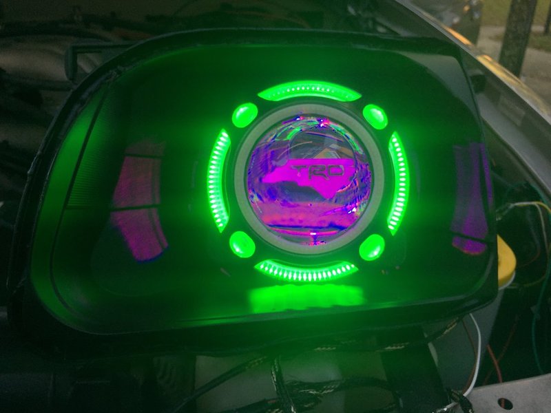

    Another 12-15 set finished
    JDB02 likes this.

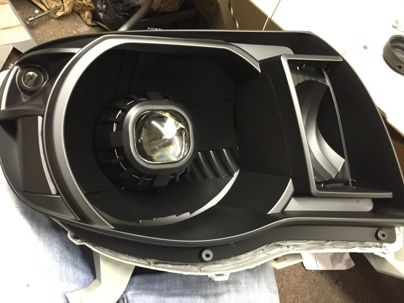

    Here are a few pics of some of the recently finished builds. Still have lots of pictures to come as I am very busy building these for my fellow Tacoma owners. Hope you enjoy the pics
