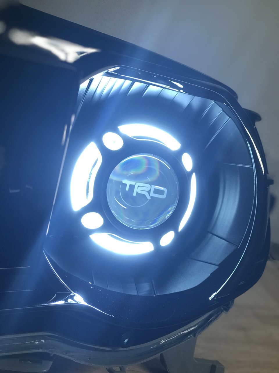

    What shrouds and size ring is that behind it? I love how simplistic this is. I did a retrofit years ago and now I want to do another one with something like this. Is it possible to make that ring a DTRL and then an amber blinker as well?
    Would this shroud and ring fit in a 2nd gen?

    The answer to last two questions is yes. It’s an Apollo 3.0 with 100mm rear halo

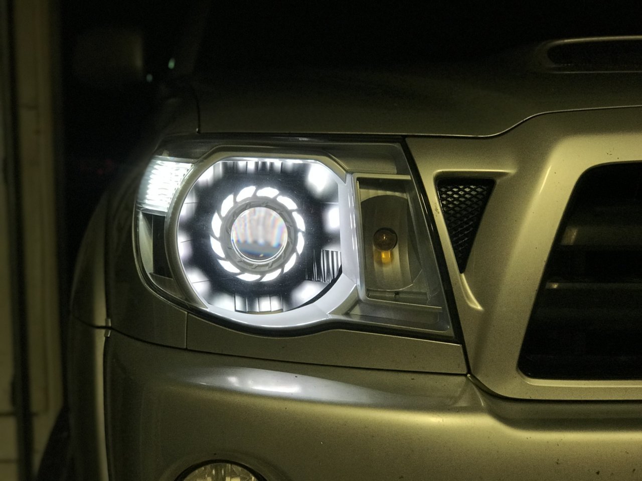

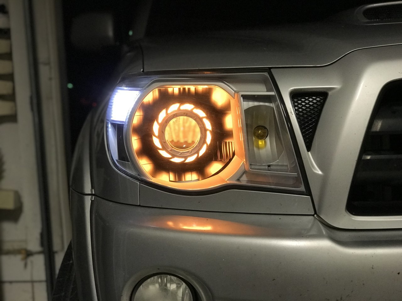

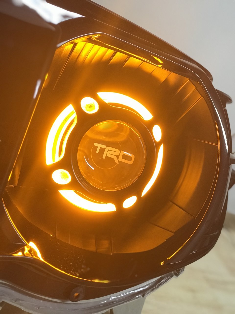

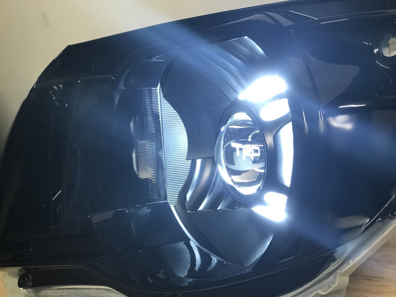

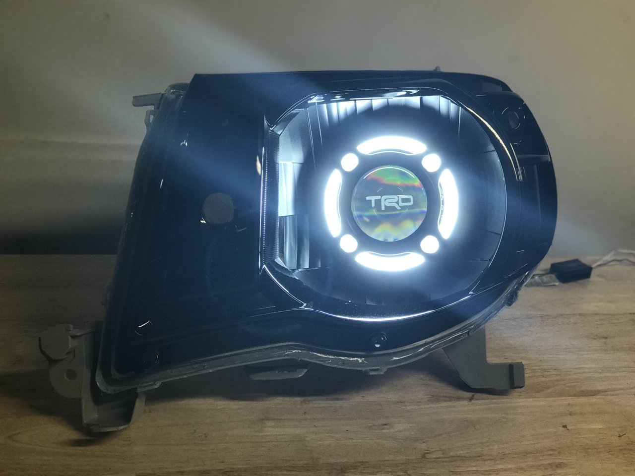

    If you have a stock DRL then yes you can tap into that for halo power. I am not saying anything to get people to buy. You can always wire them to be DRLs. You can wire them to ignition wire or some other power source that is always on like that. I would appreciate if you refrain from making accusations on my page

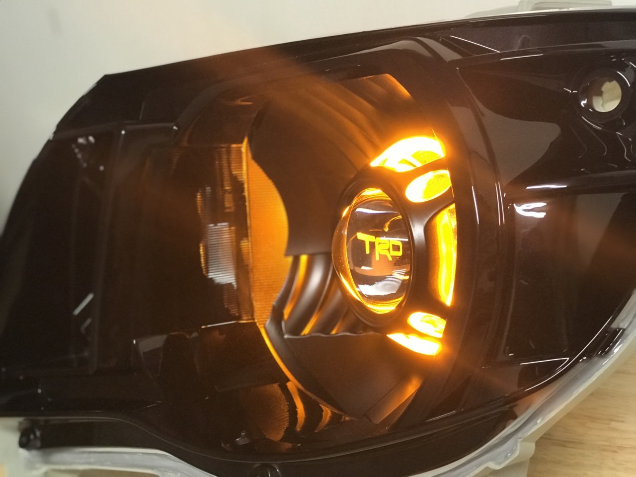

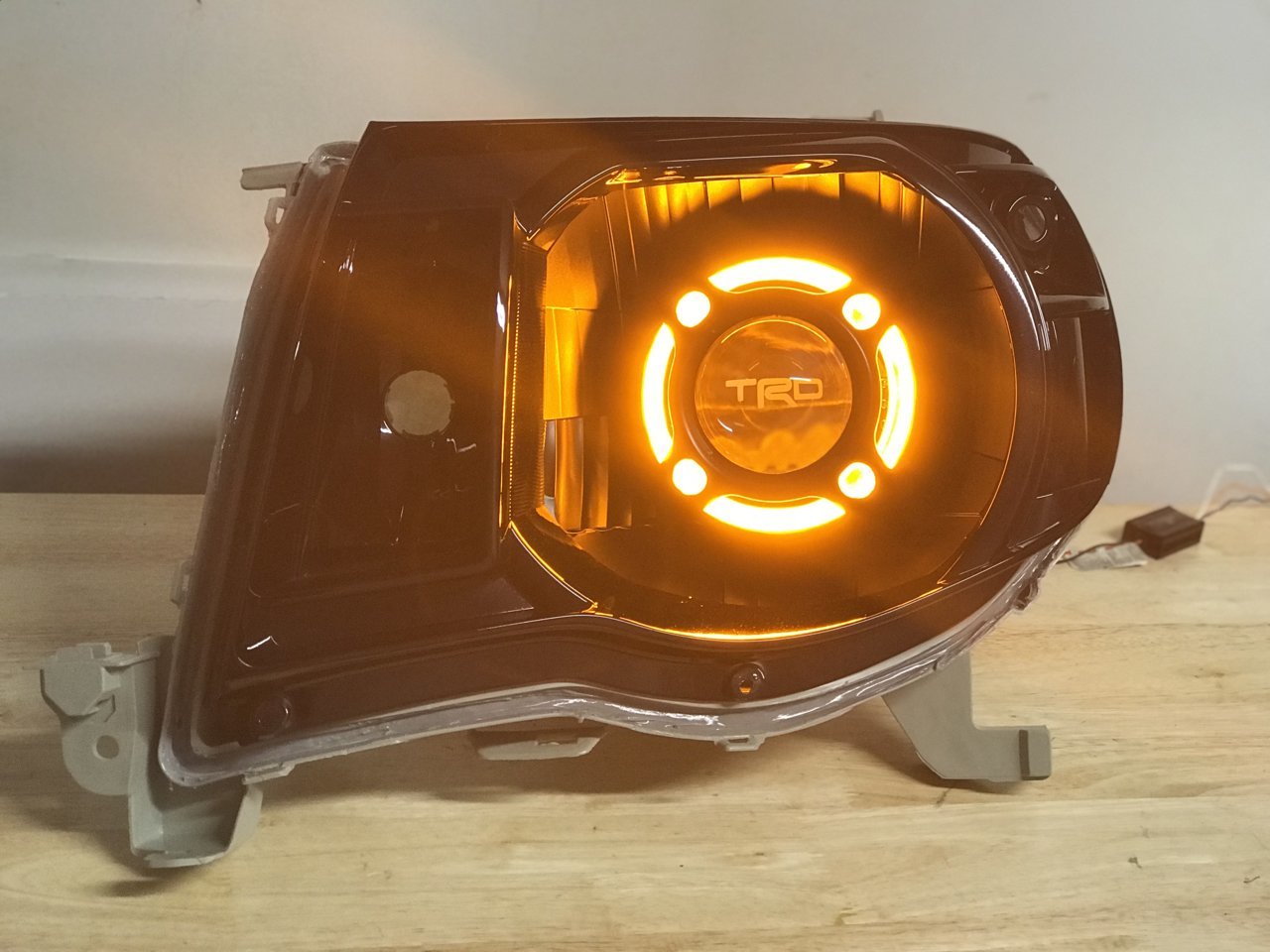

    You can also wire the white to parking light and have power with that and halo still blink amber with turn signal. Very simple wiring

    This is an 05 model and the halo is on like a DRL and look at that it blinks amber too

    That is pretty cool!

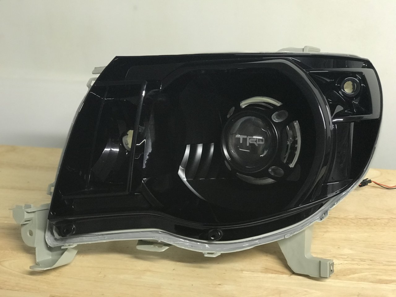

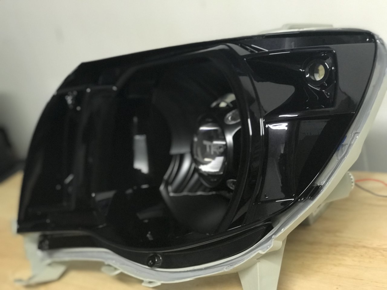

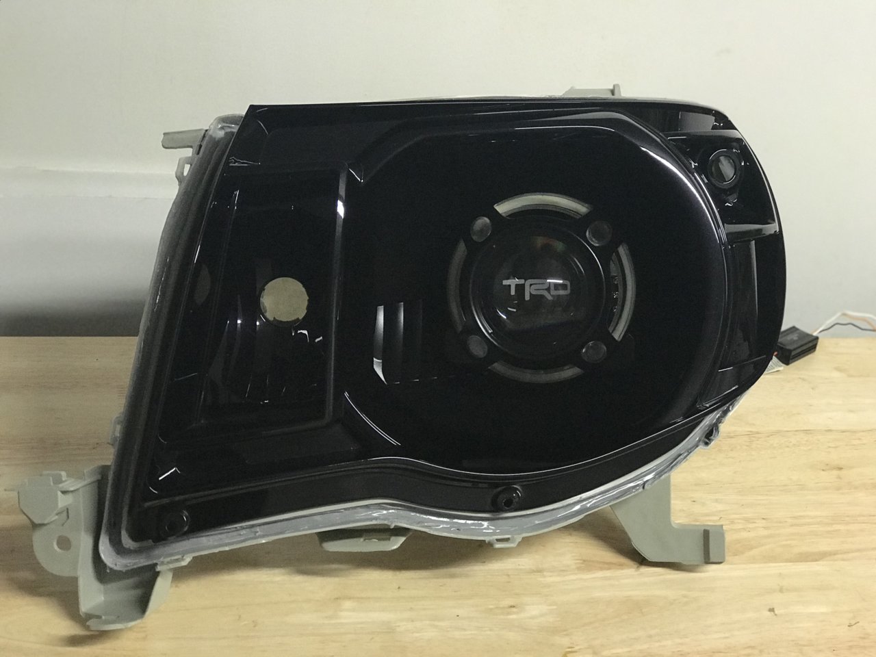

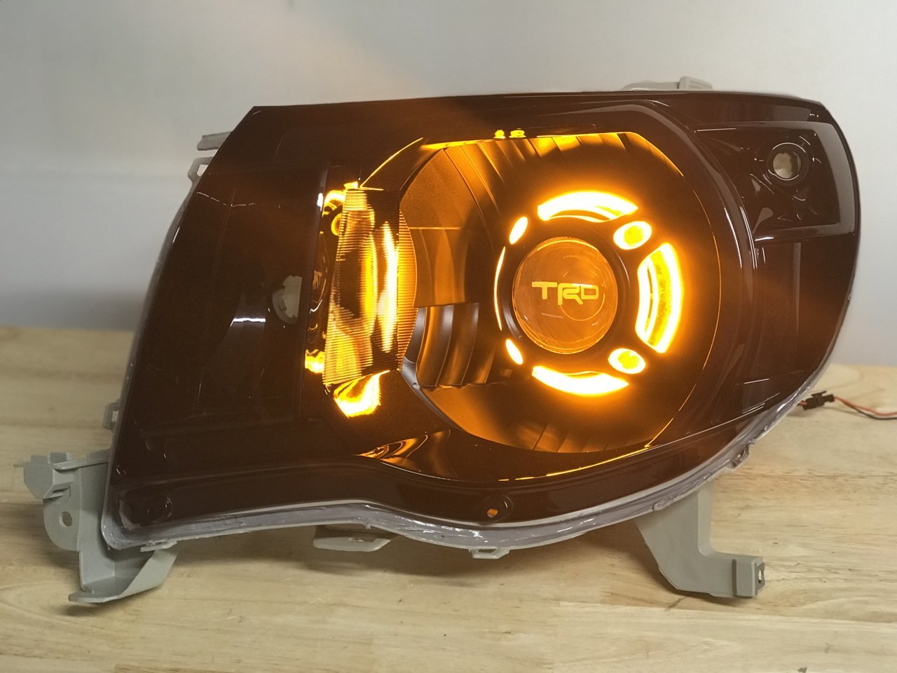

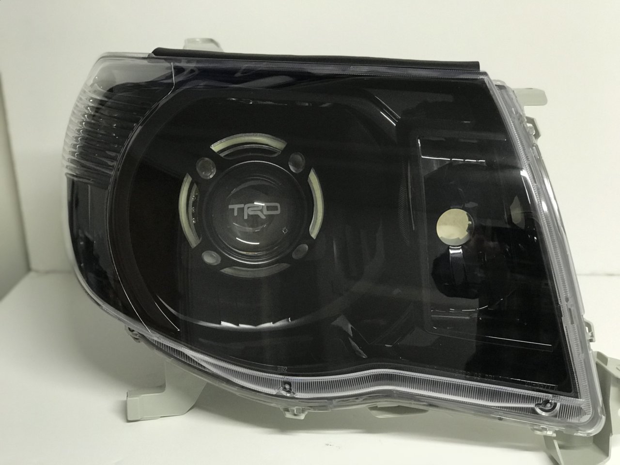

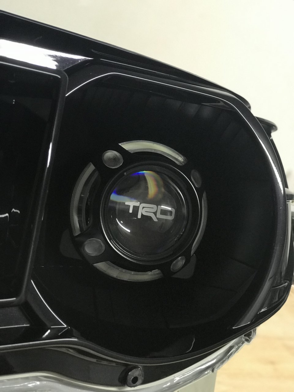

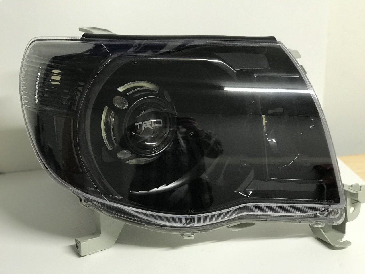

    Got @deflon new setup finished and off to Hawaii

    Wow!!!! That is literally exactly how I want mine done!!!! Damn those are slick!!

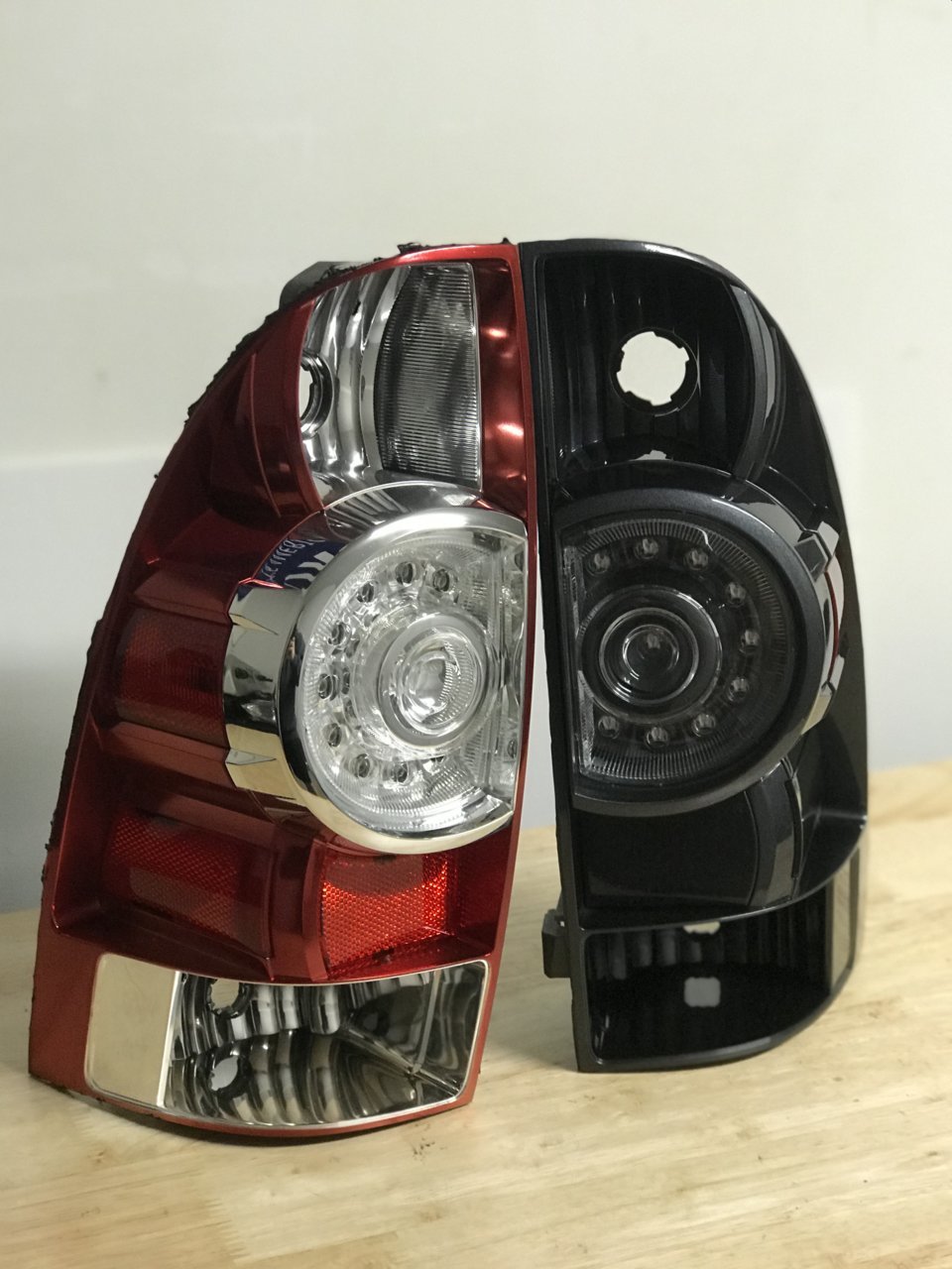

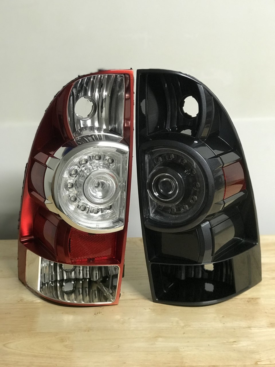

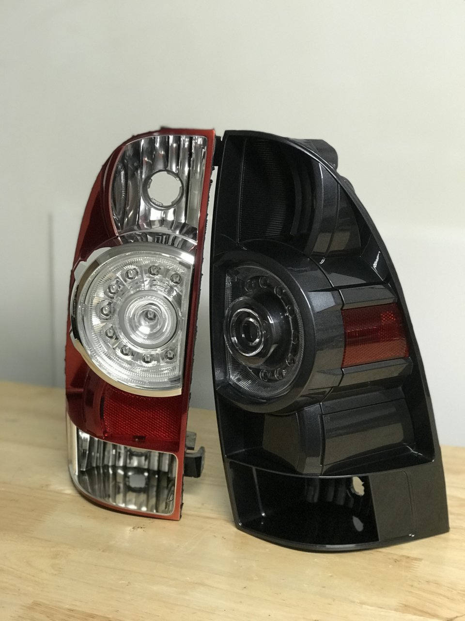

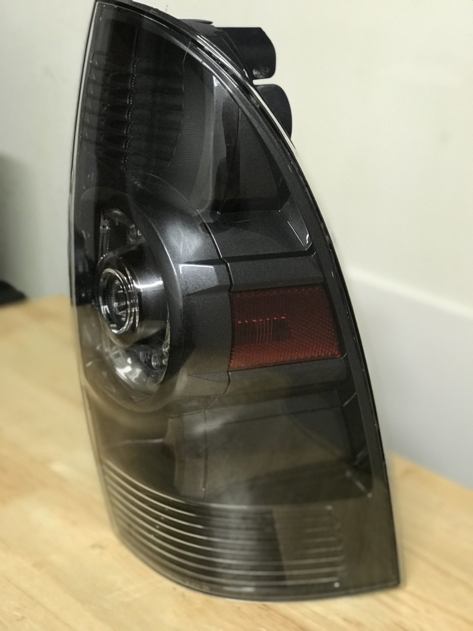

    Can’t get much cleaner when it comes to the tails I just finished for @s1t808

    What do you use to paint the chrome black and not let it gas up the inside of the headlight? @LSC15

    I use professional paint and clear coat. It won’t gas up lens with paint if you let it cure before putting lenses on
