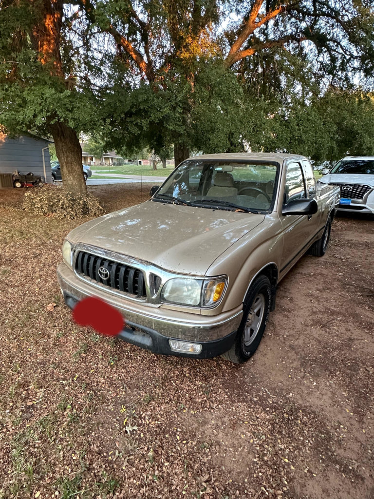

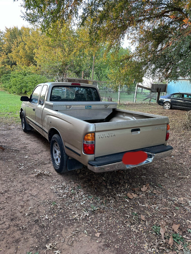

    New to the Tacoma family, and not someone who has ever been super interested in vehicles in general. I am excited about this one, though. My next-door neighbor was an elderly woman who passed away recently. I am in the process of buying her 2002 Tacoma from her daughter.
    It is a 2002 Tacoma Xtracab with the 2.4L 4-cylinder engine. Automatic transmission. Does not have 4WD, but I plan on staying on the roads. Currently has 98,500 miles on it. Buying it for $3,000.
    Needs a few things. A good detailing once it is in my hands. Air conditioner needs a new blower control module. A new front windshield. Other small things like a new tailgate handle, power steering reservoir cap, and general maintenance. I also have plans to upgrade the stereo system.

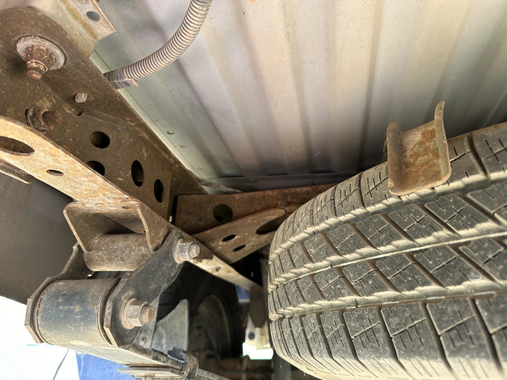

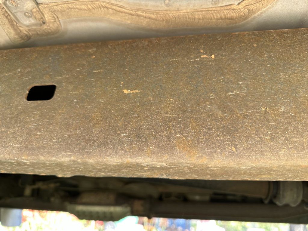

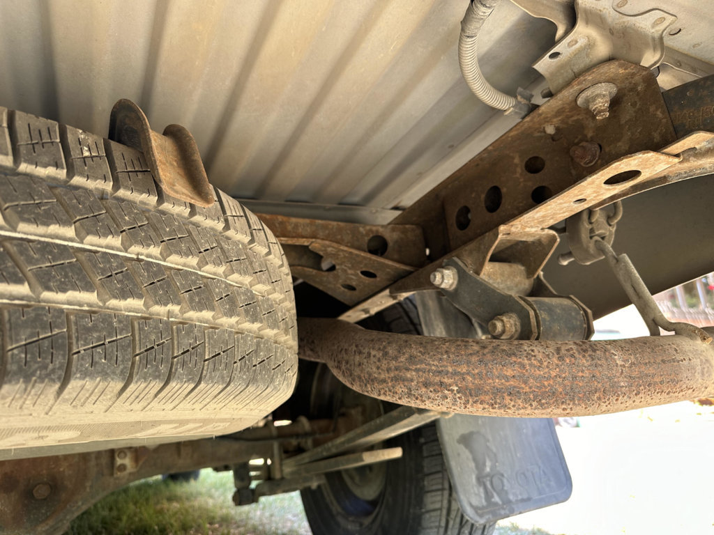

    After reading many threads, I made sure to check for extensive rust damage to the frame. I am only seeing some surface rust, but I have already read many recommendations to ensure that won't become a problem down the road. I am also in Oklahoma, so salted roads in the winter aren't a concern.

    I’d say that’s a great buy for the mileage and condition, but the frame looks a bit rusty for Oklahoma. Has it always been an Oklahoma truck? Did you closely inspect the frame before handing over the cash and signing the paperwork?

    Have you knocked around on the frame with a hammer? I thought it was unnecessary and kinda weird until I found some painted over rust on a truck I was looking at. Worth 10 minutes.

    As far as I can tell, it all looks sound. Any particular spots I should look closer at? I have read where near the catalytic converters is one common area of concern.

    I haven’t tried that yet, but I can. I haven’t seen any spots with bubbling or flaking rust.

    Yes that's definitely an area to check around, other areas to check would be around the rear shock mounts and between the cab and the frame.

    Double check the frame , which just looks like surface rust , and buy it
    The frame can be cleaned up to look new again if not damaged

    Looks like a bargain. If that spare is the original, it will be a good idea to replace.

    Appreciate the heads up on that. Once I have it, I'll drop it and inspect the date.
