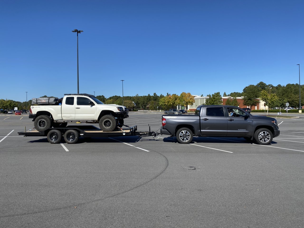

    I have a curt trutrack for my tundra and towing my tacoma around. It takes some time and measurements to get it properly set up but it's well worth it. Once I got mine dialed in it ended up squatting the front and rear of the truck 1/2". As mentioned, you want appropriate bars for your tongue weight.

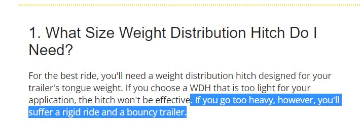

    Thanks, Nobody can seem to answer my question about having a weight distribution hitch that is rated higher than I need.
    Some have said they need to be matched but I cant seem to find out if going over will hurt anything and if so.....why?
    I found a deal locally on a WDH that is rated for a tongue weight of 1200 lbs. I really only need 6-800 tops but Its a torsion style hitch and I cant imagine having something over engineered wont work just fine.

    I didn't answer because I don't actually know why, but google is at your fingertips.

    That's not the case at all because you can simply just buy new appropriately sized load bars and keep the rest of the hitch.

    But the hauler controls the tension on the bars (aka me) and if I have it setup right, I dont understand why it would be an issue....
    Im gonna buy this setup I found and I will report back if I have any issues to the next guy that may have this question.
    If I have an issue, or its too bouncy...... haha.....
    I can always buy the right load bars for the application.
