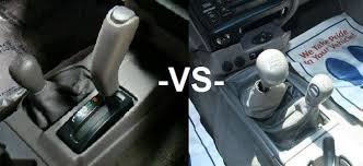

    The 4wd lever IS NOT on the dashboard. It is a physical lever right next to the transmition lever. If you decide to get a TRD Off-road, then there will be a small button to the left of the steering wheel.
    4wd will be an open differential in the front.
    The year of first generation Tacoma doesn't really matter. All years have a crappy frame that will rust if neglected. 01-04 doesn't change the frame. HOWEVER, 01-04s definitely have the comfiest interior. I've had a 98 and the sears were stiff with no real lumbar support at all. My 01 is much comfier. Also years 95.5-97 have smaller leaf springs in the rear, so it may be a slight bumpier ride compared to other years.
    The locker is the little button with orange writing on it.
    And here is the 4wd stick. Its the smaller lever to the side. On the left is an automatic transmission and the right is a manual transmission.
