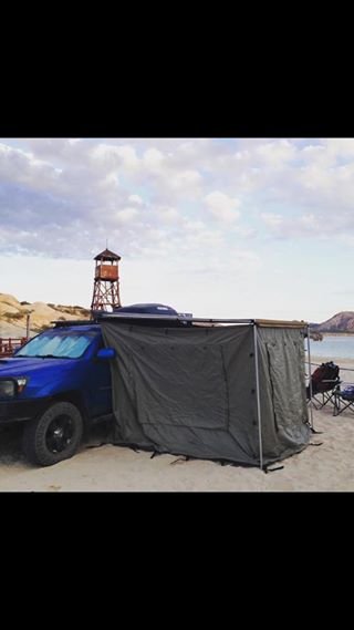

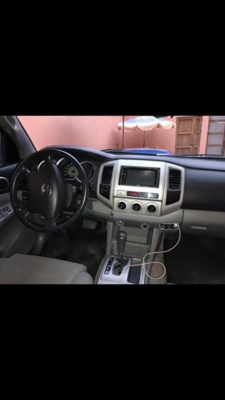

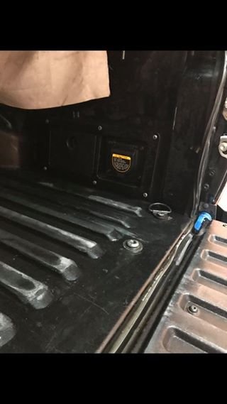

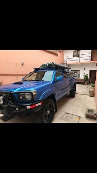

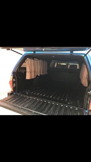

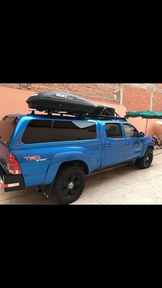

    Hi guys,
    I think we have a bit of a strange question. But after searching a bit here on the forum I think you guys will like it.
    But first of all let me introduce myself. Our names are Bram and Evi from the Netherlands. The last 2 years we have been full time traveling with a VW Vanagon Syncro (with Dutch license plate) thru the USA, Mexico and Belize. We had a amazing time. Our small Van was our house, office, kitchen and much more. Over a month ago we decided to sell our Vanagon. After 2 years fulltime living in it, we wanted more space, more comfort and less maintenance. Specially since parts where harder to find in the south. So within 4 days the Van was sold in the USA. I drove the Van from Cancun to San Diego and it was done...we are officially homeless ;-).
    So we decided to start the next chapter of our adventure. We jumped into a plane to Santiago de Chile. This is where we are right now. The plan is to travel for the next 4 to 5 years in South America. "Why Chile?" I hear you guys thinking. Well this is the spot where a lot of travellers buy and sell there cars. So now we are getting to the core of this story/question.
    We found a 2007 Tacoma with a lot of extra's on it (winch, awning, fridge, etc). So we are in doubt of buying this vehicle. The idea is to take the rear off and put a light weight camper in it (they make them light weighted of here). When we do that we will reinforce the suspension of course, add airbags and sway bars.
    Some details about the car:
    2007 TRD Sport
    4x4 double cab with canopy
    4.0L V6 gasoline engine
    250,000kms (155,000 miles)
    extra load leaf springs
    Ironman shocks
    replaced back brakes
    quality E rated tyres (don't know the exact brand)
    Seller indicated that there is no rust.
    My questions for you:
    1: what's the general opinion about this car?
    2: if I go to check out this car, what should I double check (weaknesses)
    3: any other tips what we have to think about when we put a camper on it? (we are also playing with the thought to make a flatbed out of it)
    4: As far as I know the Tacoma has been sold in Chile and Bolivia so we should be able to find parts or fly them in from there. Does anyone have any knowledge about parts available in South America (I know it's a long shot)? Or are some parts the same as in the Hilux (sold everywhere here)?
    I hope you guys can give me some help here. In return we will upload some stories, pictures and movies on our Facebook page about the trip (and hopefully soon the Tacoma). You can visit it here: Thank you so much!
    Greetings,
    Bram and Evi

    Nice looking rig. It would be nice if you had access to the service history on the truck, is that possible? Also do a thorough check of the condition of the frame underneath, check for rust

    First of all Welcome to TW. Second, I hope you are not an internet troll and this is for real. Third, I would say check for:
    Chasis rust and Maintenance history. Other than that the truck looks great.
