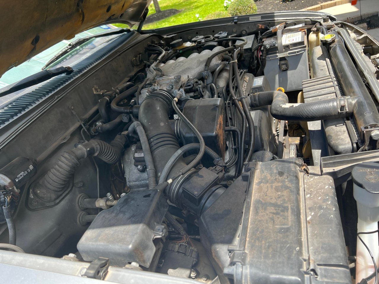

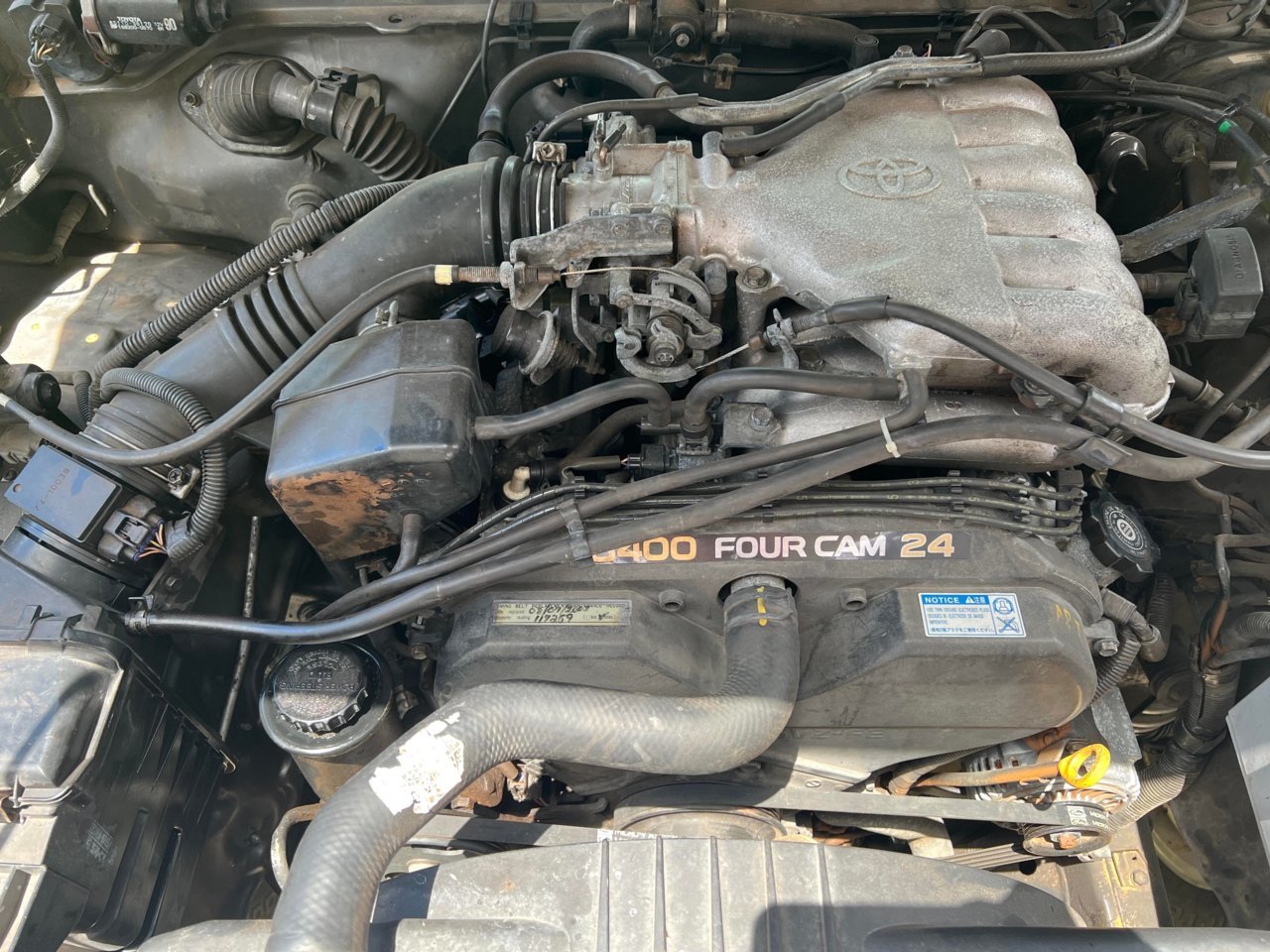

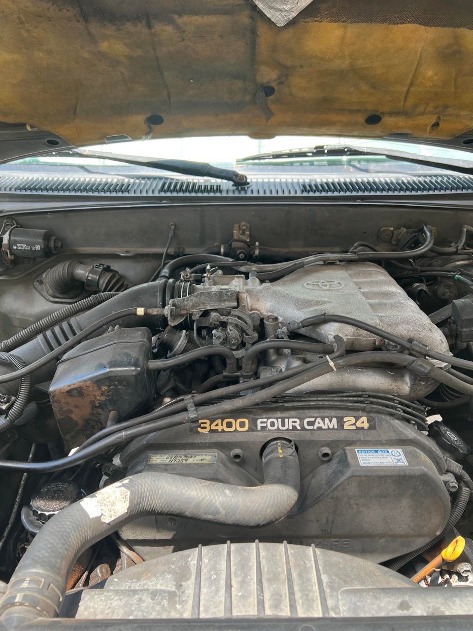

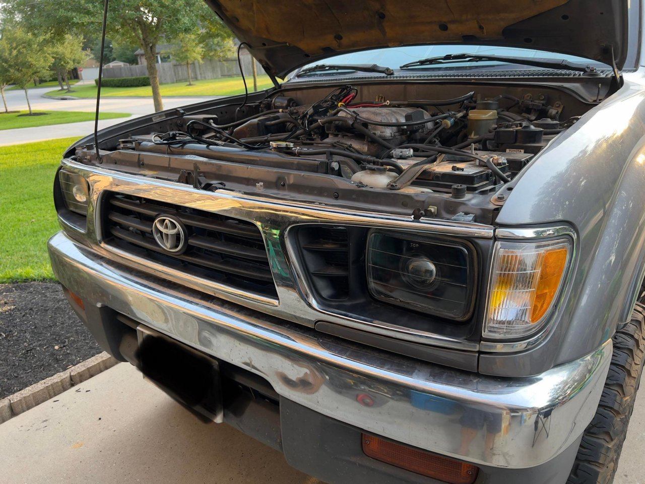

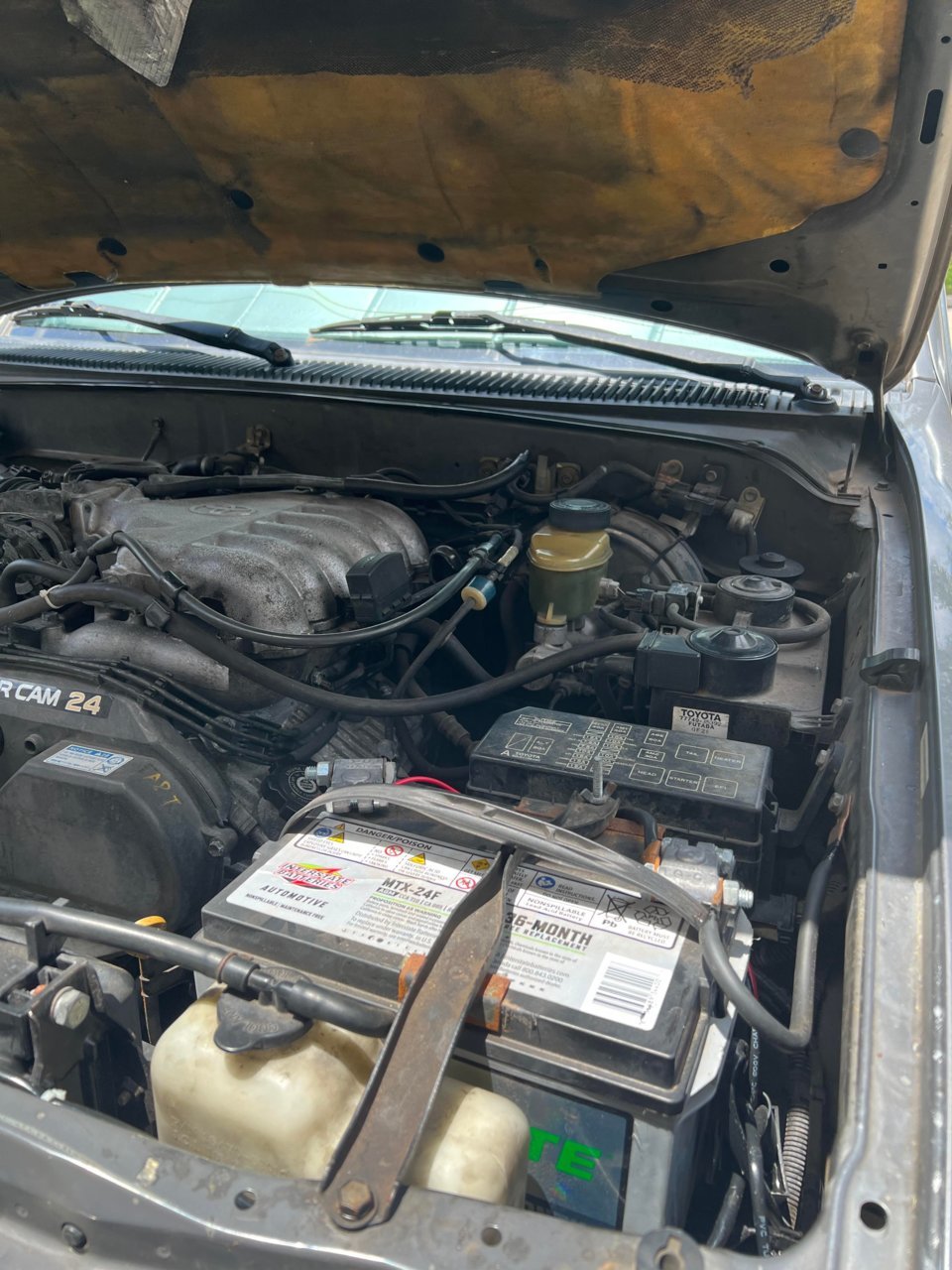

    Anyway, here's some pics of the engine bay area. Couldn't see any evidence of shoddy installation or anything like that. At this point it's a go from me barring any unforeseen circumstances.

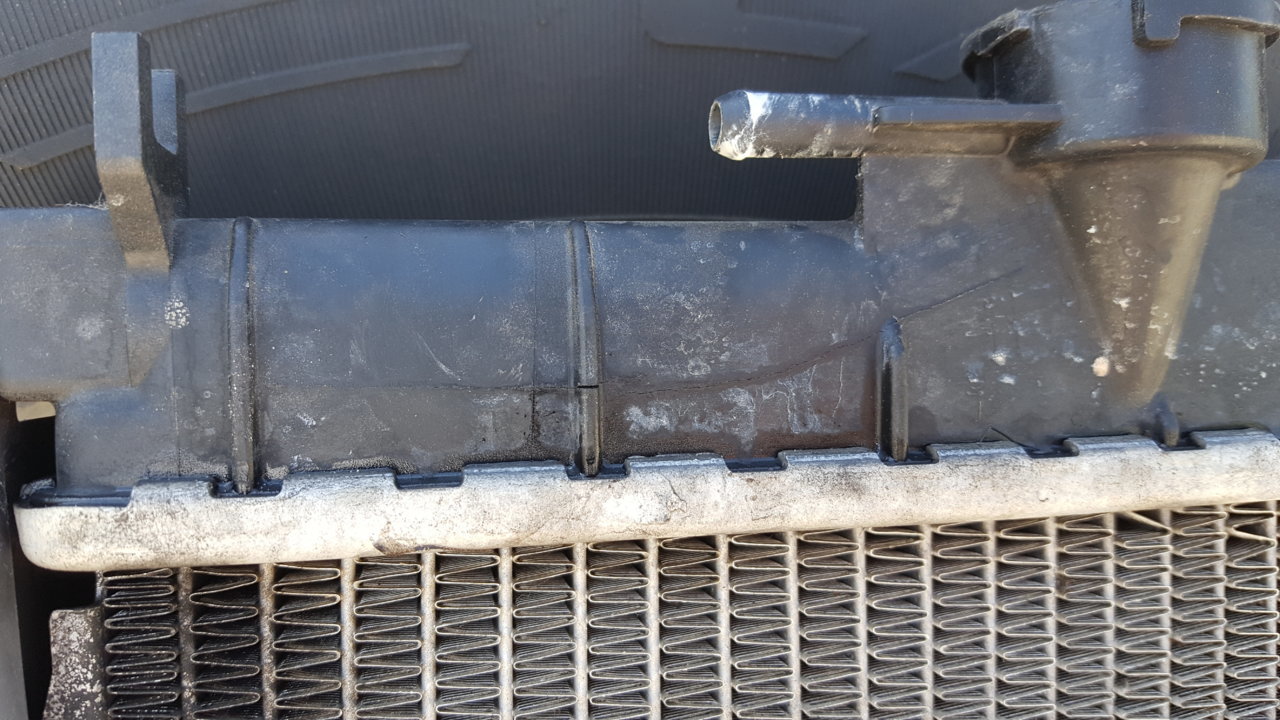

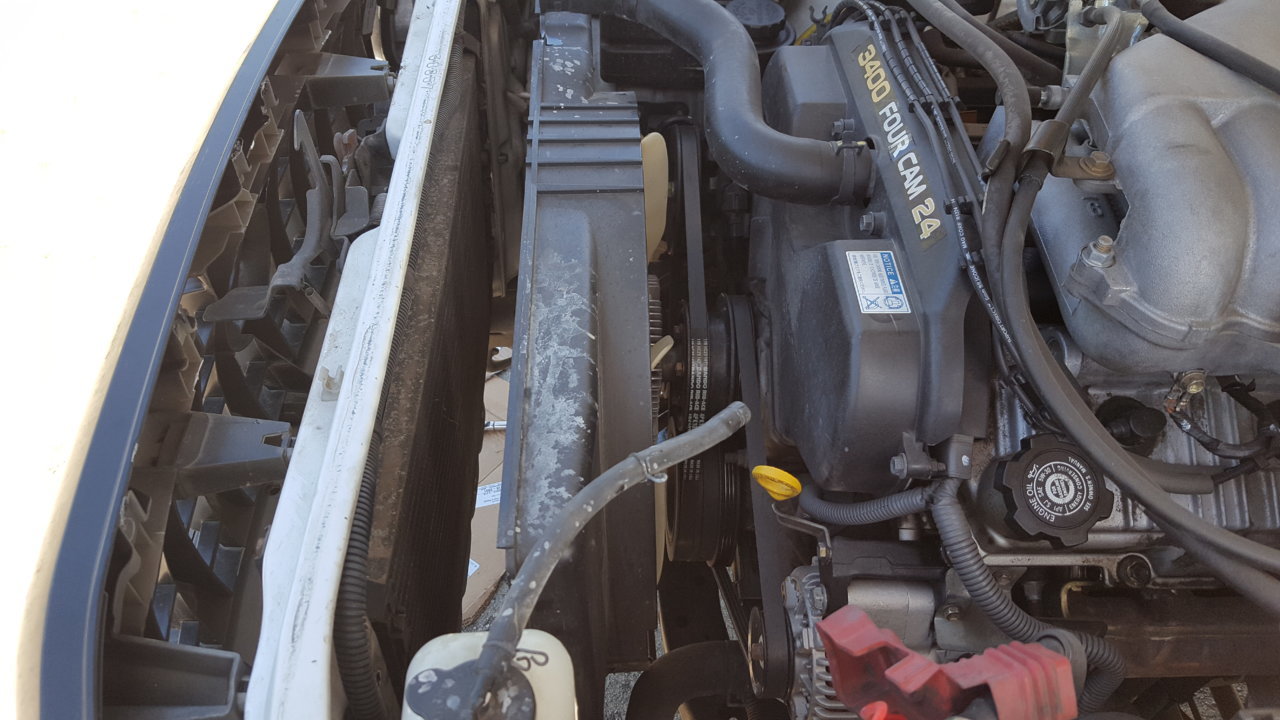

    I did notice the top reservoir of the radiator might be getting a little brittle if I'm not mistaken. And it looks like the engine might have 120k miles or so going from the timing belt stamp. The current owner said the timing belt and water pump were changed when the motor was installed a couple years ago.

    The radiator shroud looks like it has 'dried coolant' which is pretty common.
    The plastic ends on top and below the radiator get brittle and crack, only to minimally spew coolant under pressure and mist throughout as the fan spins.
    My Tacoma did that but it didn't leak enough to ever cause me to run low on coolant; simple radiator replacement which is super easy and cheap to do. Fair to say it's been done based on how old those drip stains look.

    Man, if the frame is rust-free, fluids look good with no/minimal leaks, and it runs and drives fine, other stuff can be fixed. That engine bay looks pretty good for its age. Just make sure that anything that seems funny has a realistic explanation.

    Look good to me.
