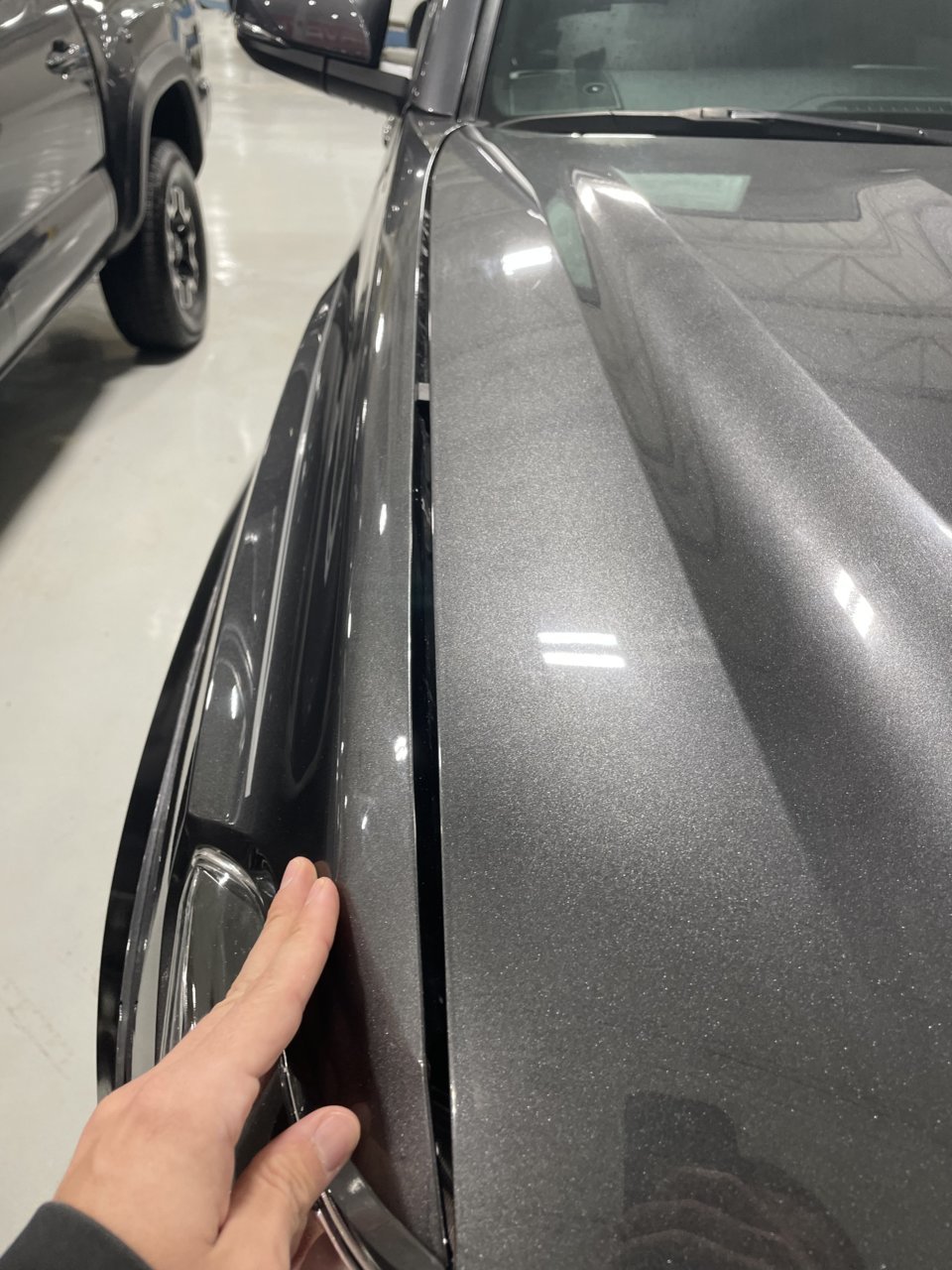

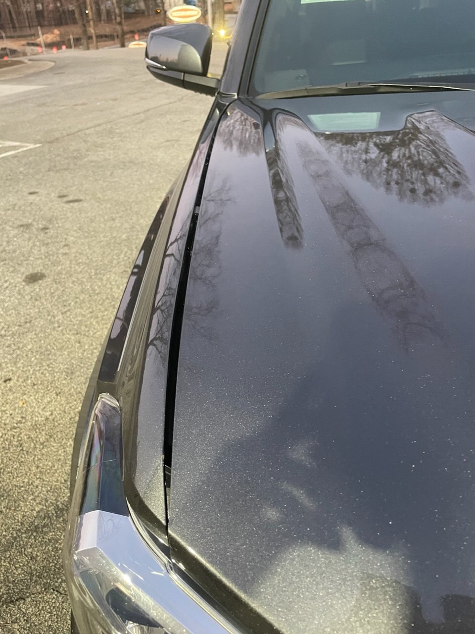

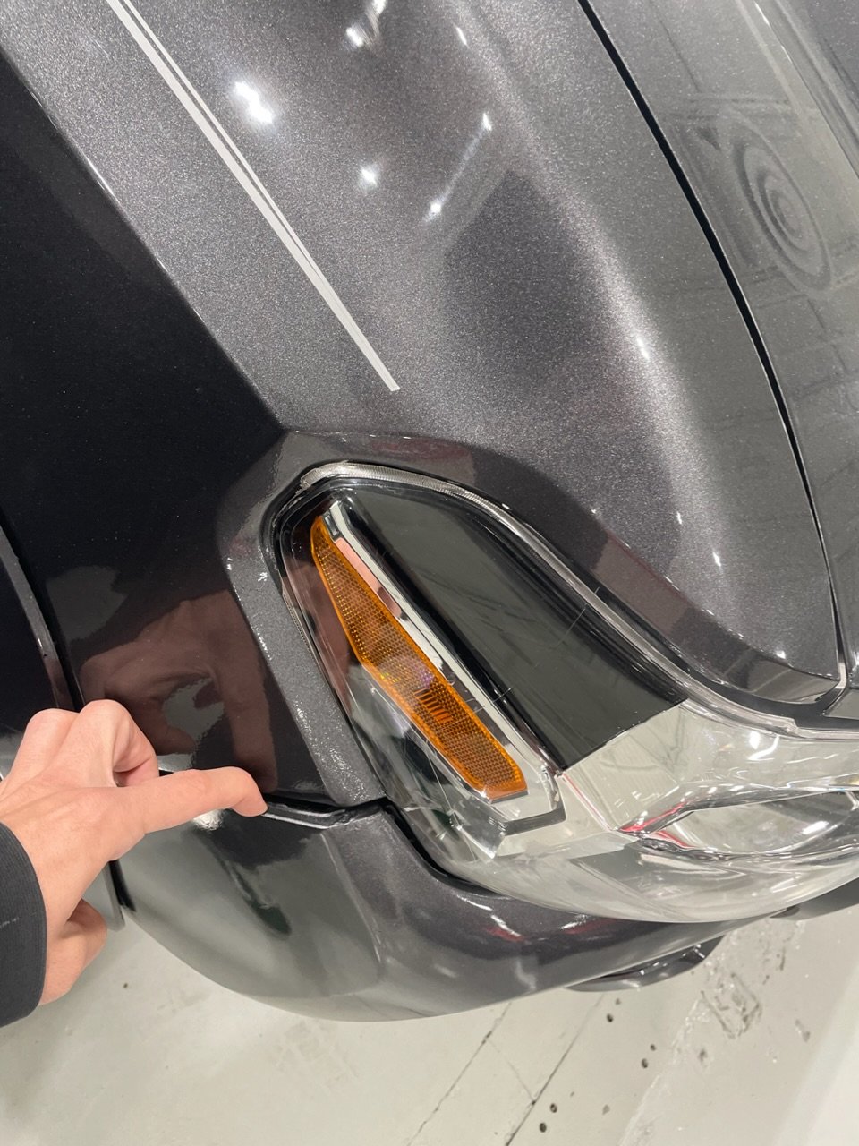

    First time Tacoma buyer (love Toyotas). I’m really interested in this trd sport 21’ which is in immaculate condition besides this little bit of body damage on the front right headlight and side panel. I am attaching images of what’s wrong. I knew the truck had been in an accident but i figured it was back to “mint looking” condition. You can’t tell in the images sadly because it’s so minor. You can literally “push” the panel back under the light and it looks fine, maybe the clips are just broken?
    What would it cost to get this fixed?
    The truck is priced lower than market because of this already, and I’m assuming it’s been on the lot for 4 months for the same reason. The guy at the dealership told me it would be less than a grand to fix it, but I’m thinking if that was the case why wouldn’t they do it?

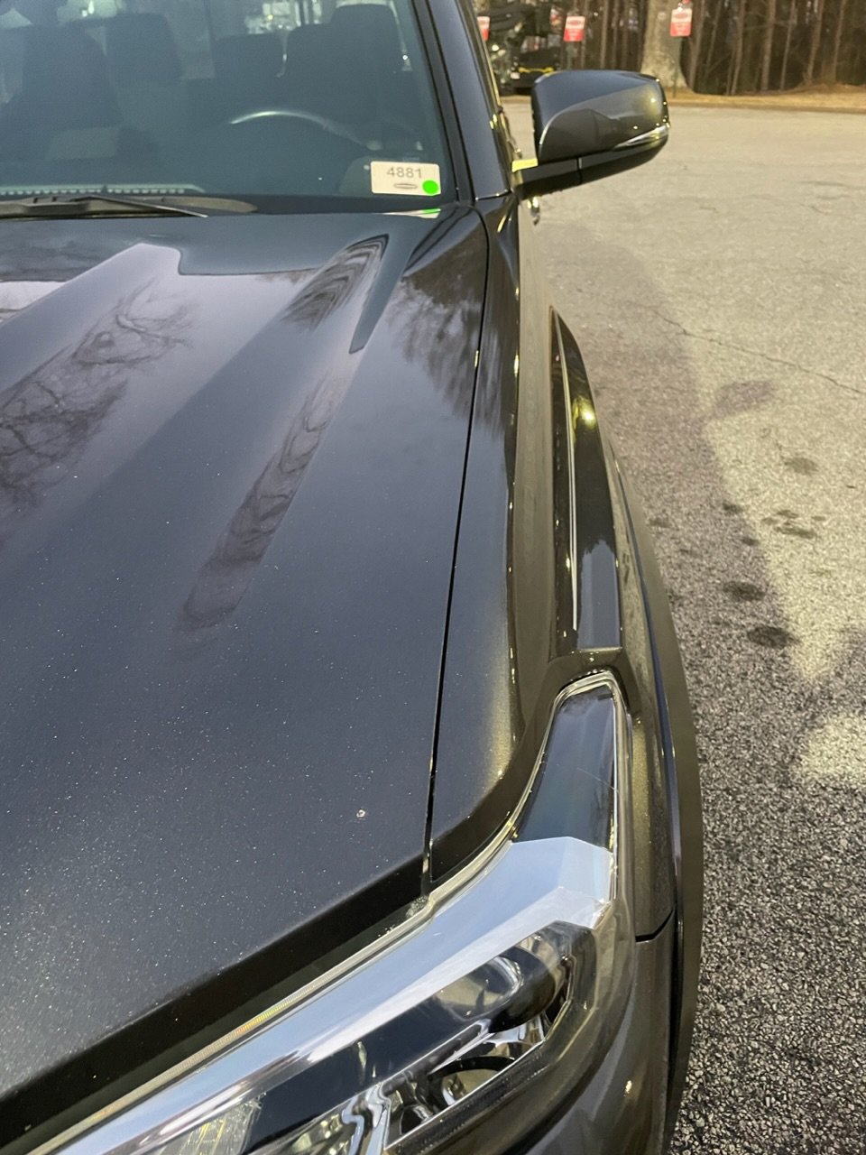

    I also attached an image of the other side of the hood. The spacing on the messed up side is too big, which is my biggest concern. If purchasing, I would want to get it fixed immediately so any help would be appreciated.

    Hood gap if definitely an issue. Bumper clips may be broken. Any scratches on the bumper ? Or did it just pop out ? The hood can most likely be adjusted from the back two hinges. Doesn’t look like anything is severely broken… just misaligned

    It looks like the bump on the bumper pushed the fender back a bit. Depends on how picky you are it could be fixed back yard style for cheap or the perfect fix could cost $2500. You pick.

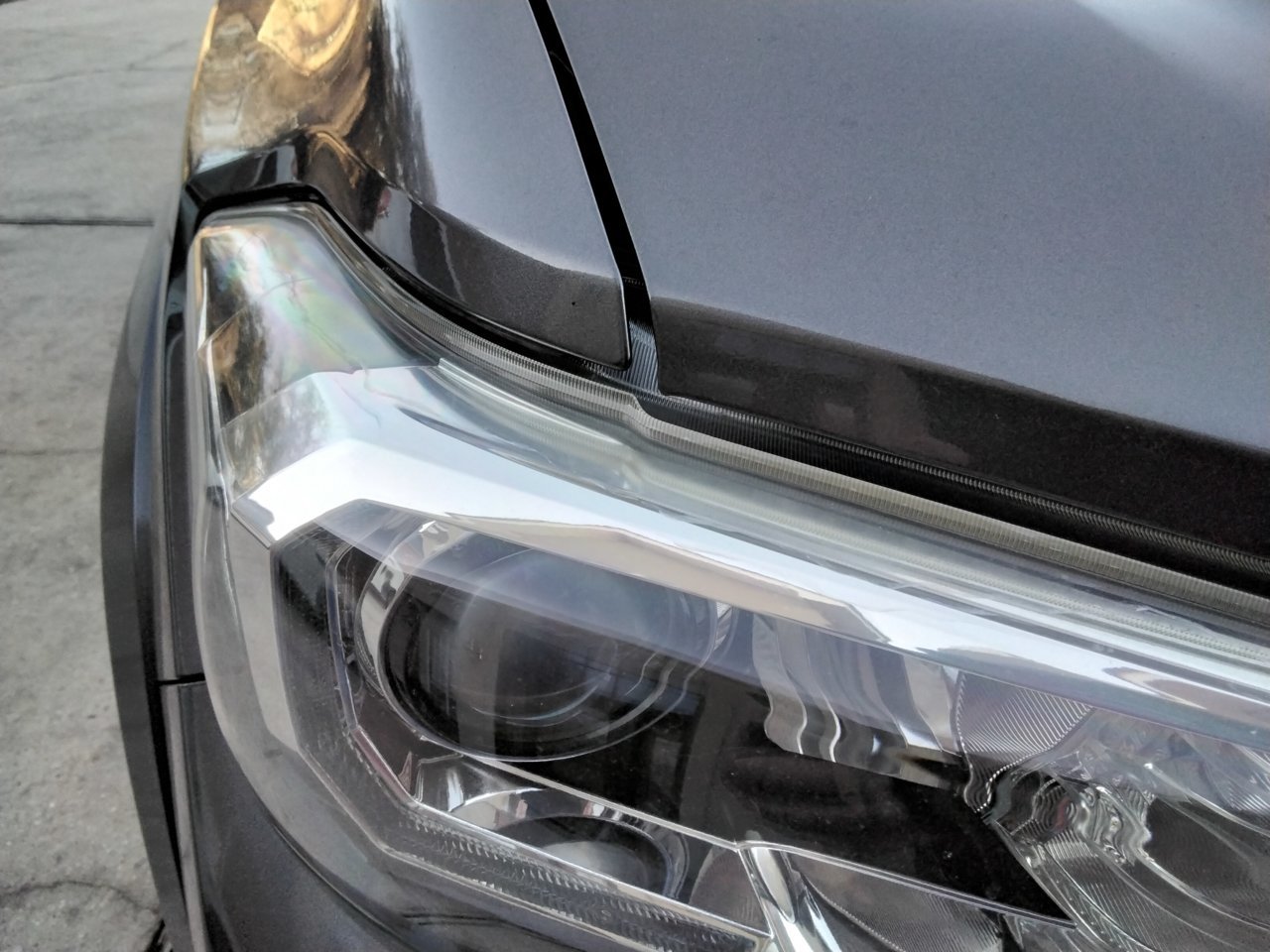

    Pic of my fender/hood that I took yesterday for a different thread.
    Pic from the OP's first post
    It looks to me like the front tip of the fender above the headlight kinda "veers in" towards the hood in the OP's pic. That front tip needs to be repaired properly and then the whole fender can be repositioned to line up correctly with the hood and the bumper.
