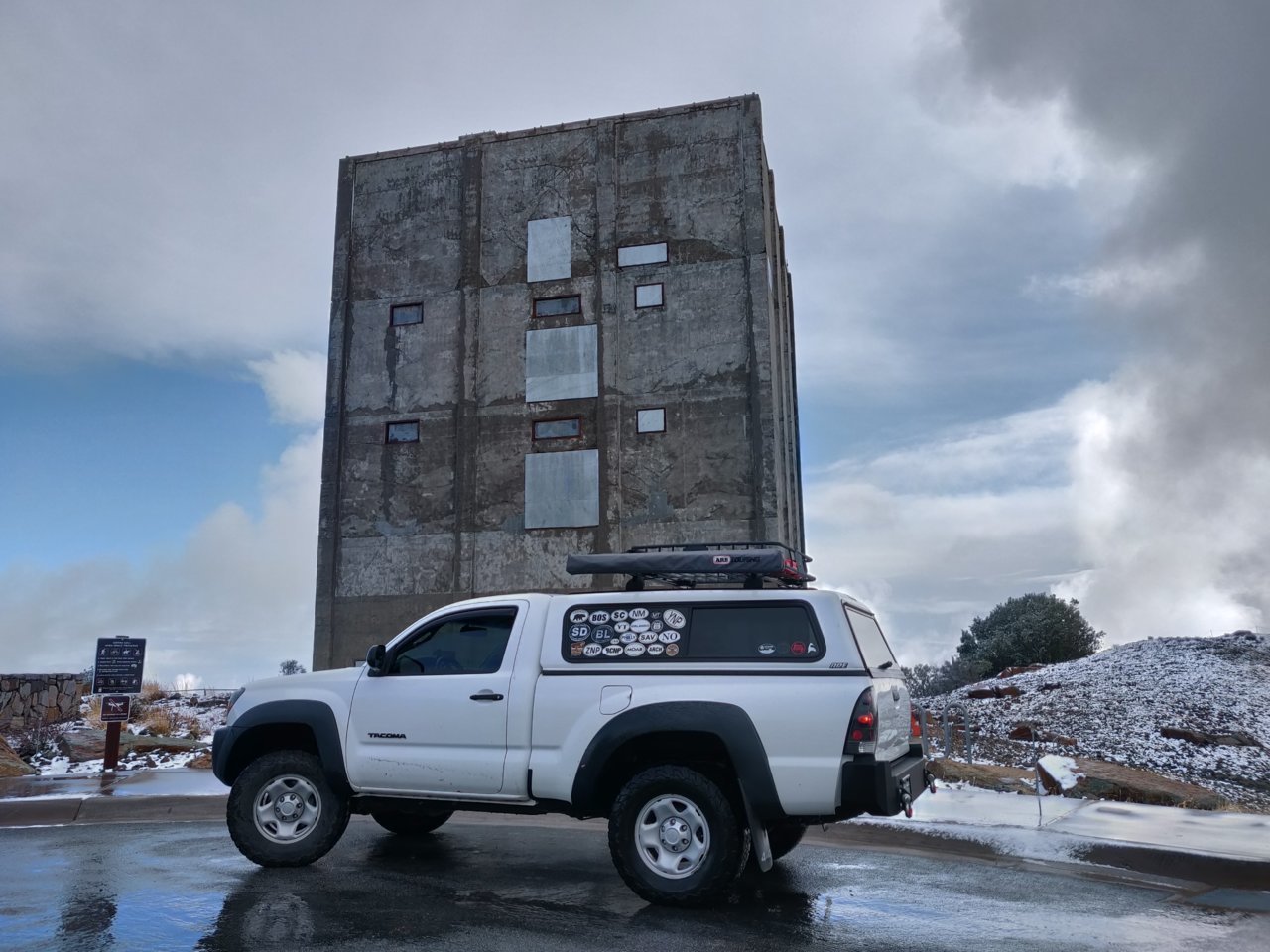

    Okay, i believe i am qualified to chime in. Im running a 4 banger 5 speed 4x4 SC with full load (sleep platform,gear bins,foam pad,recovery gear,rack,5 gal fuel cell empty,steel armor plates etc) and my wife and i did a multi month run around the U.S. later landing Colorado for a few years and having a commute into the Rockies every day. You can get buy without the 4.0 but you will have moments when dropping gears and smashing the peddle wont cut it. When the engine is o2 starved say good buy any get up. I would not change a thing with my rig but running the revs so high all the time made me feel bad lol. The price of these things will only go up and if you can find one without frame issues and lowish miles your good to go with wherever you get. P.S. I paid 20k for it a few yrs ago. Its an 08 with 6k on the odometer...60k now at 18mpg.
