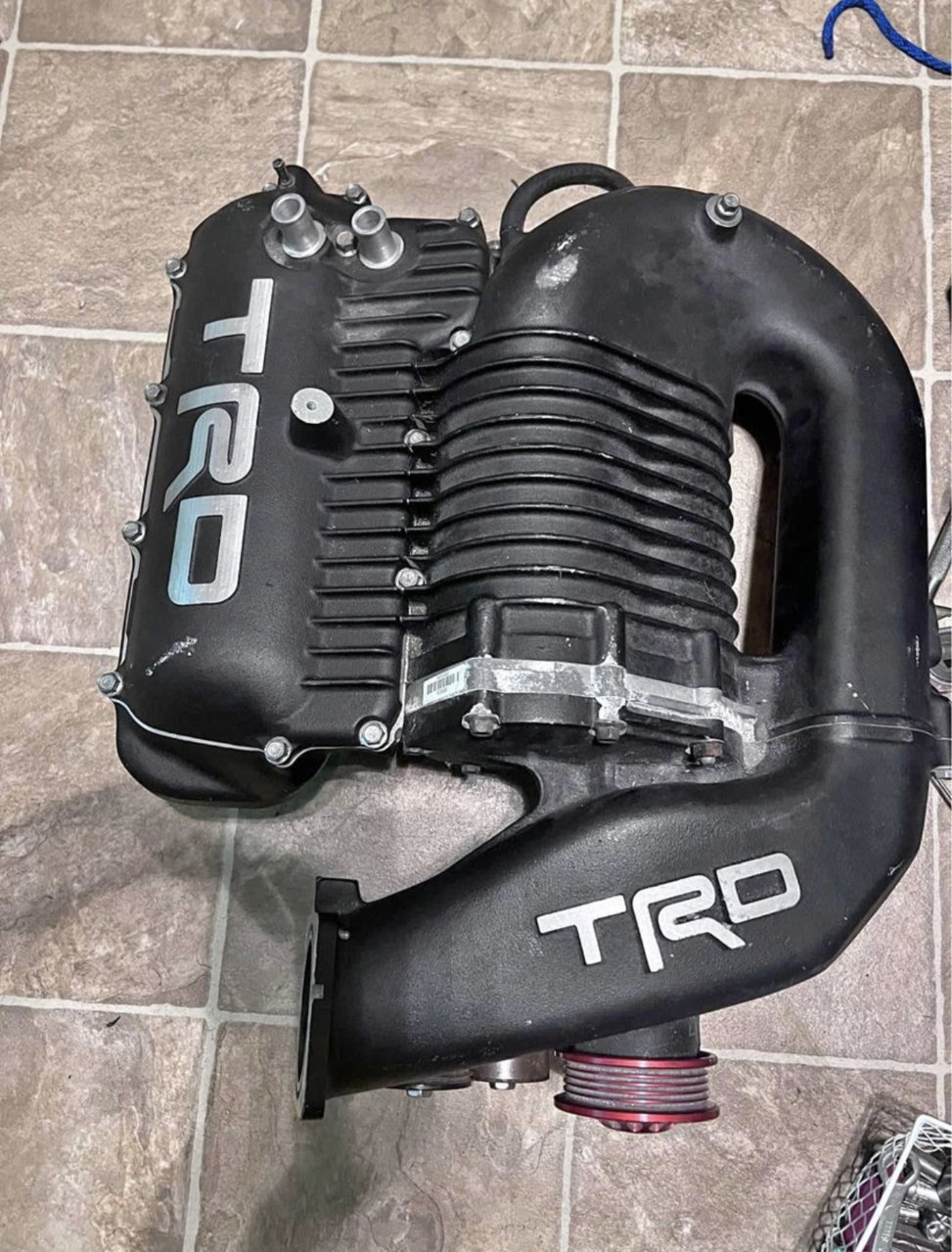

    Good afternoon everyone,
    I came a cross a supercharger that seems to be priced fairly near me. My question is, my truck has 180k miles and all maintenance has been done on time (motor, diffs, transfer case: oil changes, transmission drain fill and any other maintenance you can think of even if I didn’t think it was needed), can my truck handle a supercharger with the miles it has? If so, what are some things to look at when buying a used supercharger?
    Thanks for the suggestions

    They're pretty low boost right? Less than 5-6 lbs?

    It can handle it just depends how long. You’re putting it on a motor that’s higher mileage

    wouldnt hesitate to throw it on a well maintained motor with under 200k.

    Okay, what happens after 200k because hes almost there.....

    thanks for the feedback everyone, I will be picking it up tomorrow and it comes with a 2.825 URD pulley

    200k is just an arbitrary number tbh. If the motor is well maintained, has good compression and doesnt use oil I wouldnt care if it had 500k on it.

    Good call! Now hit up OTT for a proper tune.... down the rabbit hole you go.

    My taco has 120k and I’m going to supercharger it soon hopefully. I would not think twice about it if you have a good idea of past maintenance. The supercharged thread had some upgrades to do while you’re installing, I would suggest giving it a read (at least page 1), if you haven’t already. Good luck!

    Mine's got almost 180k on it, well maintained. I'd supercharge it in a heartbeat if I had the option to. No worries if you're well maintained.
