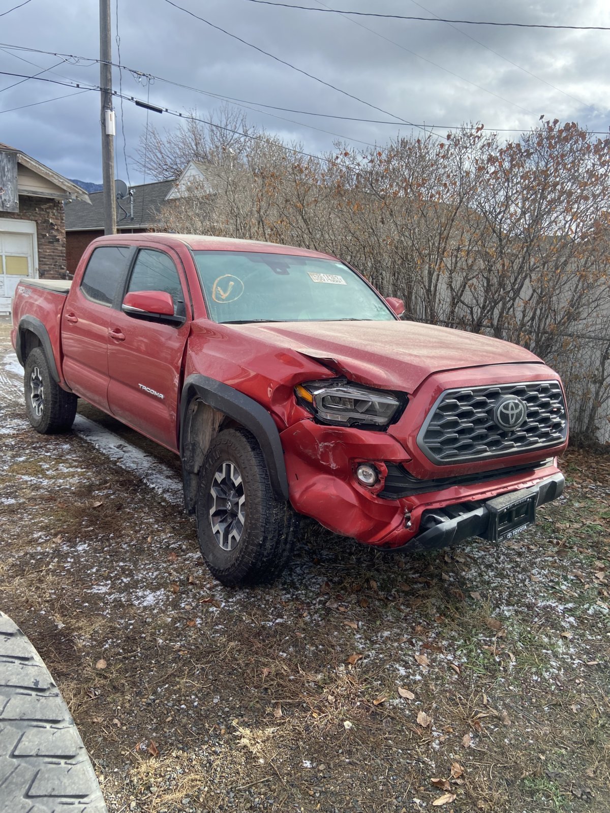

    I bought my first Tacoma a couple of months ago. I had been looking for a while, and wanted a 3rd gen 6MT, I did not want an automatic. Considering I didn't have 30k+ to drop on one, and 6MTs are hard to find, I decided to go the route of buying a wrecked one from Copart. It was the first time I'd bought anything on Copart. So in case anyone else is considering doing it, I figured I'd write up a somewhat detailed account on how everything penciled out. Obviously repairing a wrecked vehicle can vary widely, but in my experience, I found it to be worth it.
    First off, I do every single bit of work on my own vehicles. It probably seems obvious, but if you don't do your own work, don't buy a wrecked Tacoma lol. Anyway, I ended up buying a 2022 TRD OR 4x4 with 7,000 miles, red, 6MT, tech package, leather heated seats and such. The first photo shows the damage. No airbags were blown, and it started right up when I went to Copart to check it out. So I decided to bid on it.
    The big thing to be aware of with Copart is the fees! I ended up winning the auction at $17,800. However, by the time I paid the fees and got it hauled to my house, i had $19,700 into the truck. Still, I was very happy with that. Then the work began!
    I spent roughly $2500 on parts that I needed to get it fixed. Hood, fender, control arms, spindle, headlight, core support section, and then a coastal Offroad front bumper kit.
    When I first looked over the truck, I didn't see any frame damage. But when I tore down the front end to replace the bent control arms, I discovered a slightly (1/2") bent LCA bracket. Which brings me to a big discovery of mine: a wrecked truck will always have more damage than you think. I also discovered the bed was slightly tweaked in reference to the cab (it must've shifted when the accident happened. It was an easy fix, loosen bolts and adjust the bed). Anyway, the LCA bracket was easily fixed by a bit of welding and a hammer.
    Once I got the suspension rebuilt, I had to get the core support straight. I pulled as much as I could out with a chain hoist, then cut two sections out and welded new sections in of the most bent up parts. Toyota sells those pieces individually, which is handy. It's still a pain to get everything straight. It took me several hours of mocking up body panels, tweaking things, and mocking it up again to get things straight. It's still not perfect, if you are within 5 feet of the truck you could tell it's not factory body gaps. But its more than good enough for me.
    Then I bought some other mods to make it how I want. 10k winch, LEDs, Bilstein 5100s and Eibach leveling springs, and I am currently wiring in an aux fuse block and dual battery setup and getting the lights and winch put in. All that stuff was about $1500.
    Fortunately I live in a state where a) people without a dealer's license can buy salvage auction vehicles and b) getting a rebuilt title is pretty simple, just needed a brief 15 minute inspection and receipts for parts.
    I still need to paint the replacement panels, I have the paint here, just haven't gotten time yet. But all in all, I ended up with a 2022 TRD OR with 7,000 miles for less than $24,000 set up with a steel bumper, winch, 5100s, and dual battery. I probably have in the neighborhood of 100 hours into the rebuild. The body panels aren't perfect, I had to hammer and weld a bit on my frame, and it has a rebuilt title. But it drives like a brand new truck and its got a full life left ahead of it. If I was to buy a clean title Tacoma for $24,000, it would either be 10 years old or have 120k miles. Or be a base model. None of which I really wanted.

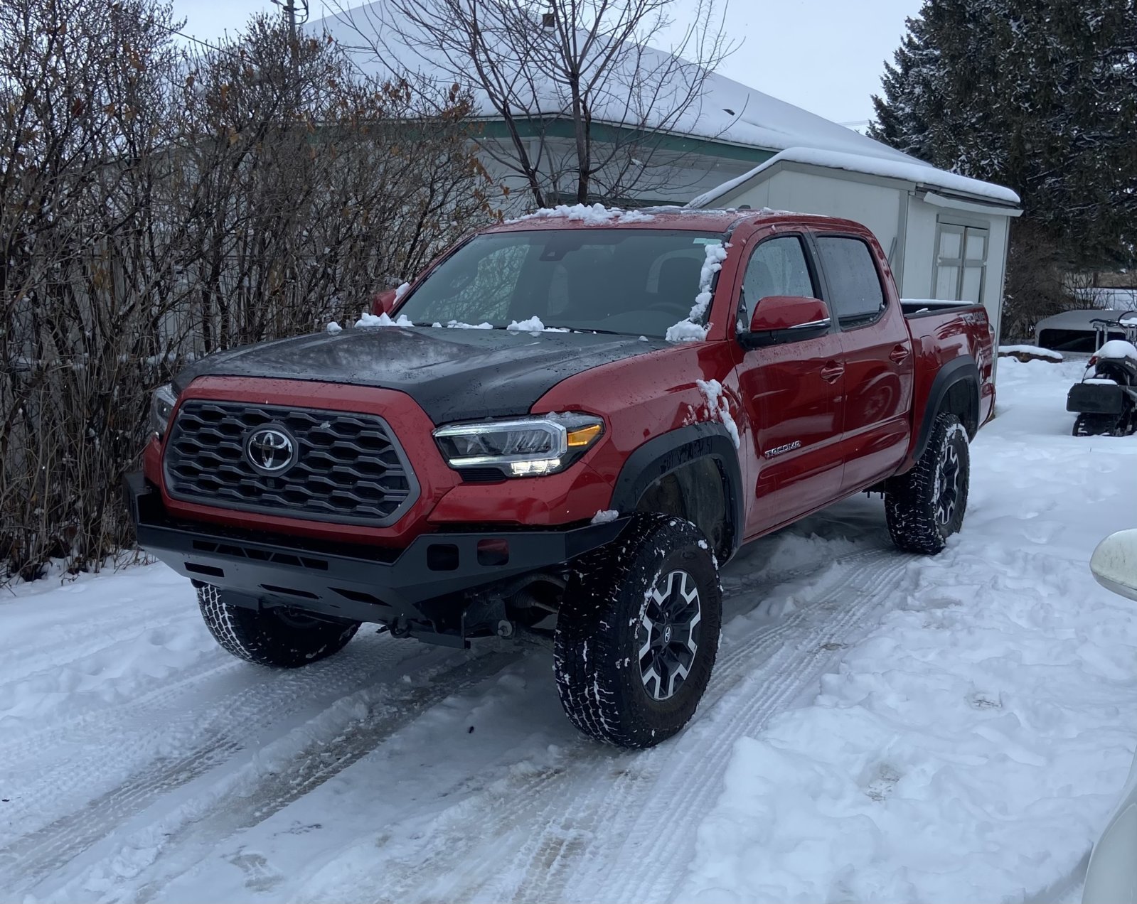

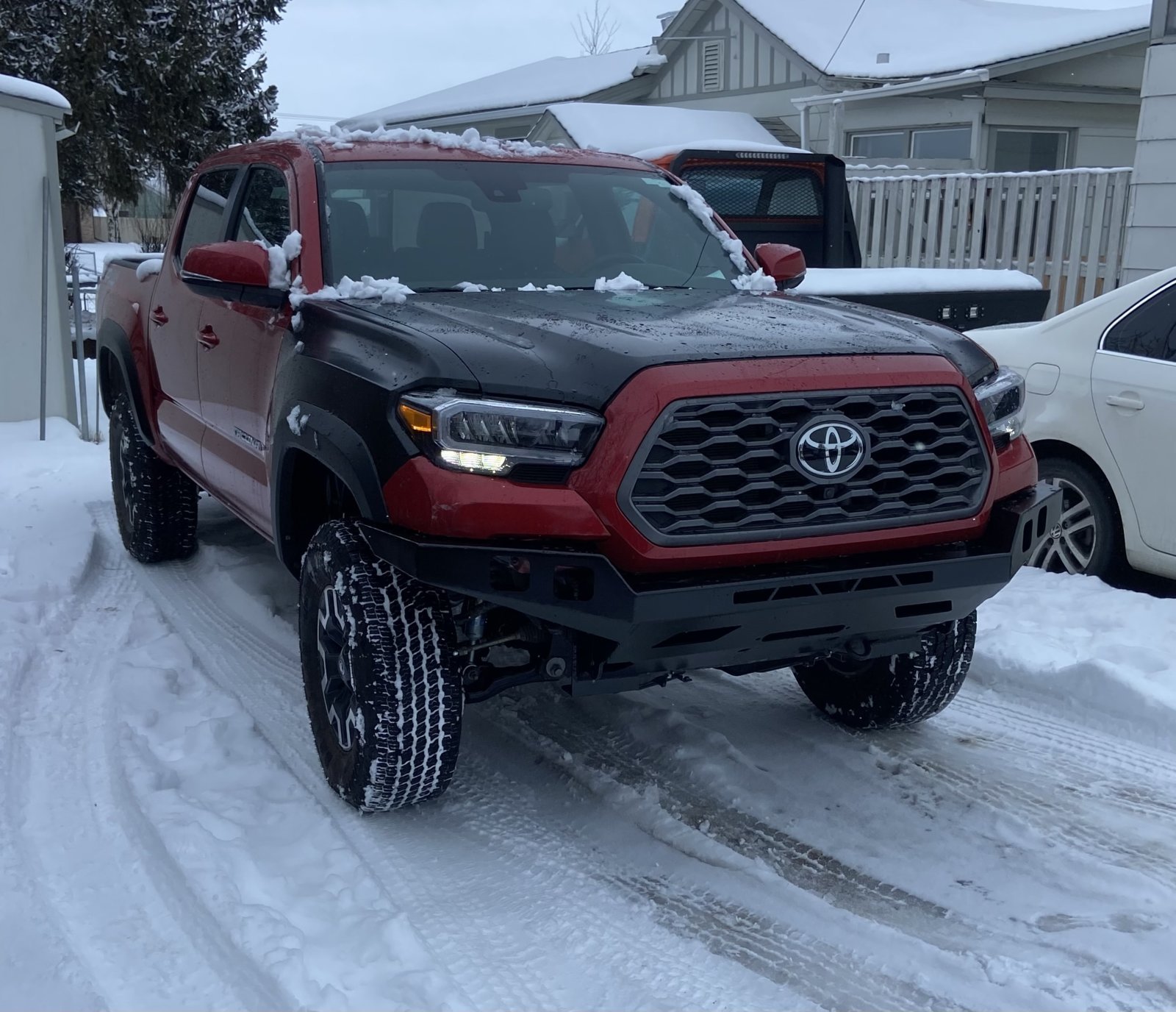

    here's how it sits now. Like I mentioned, I haven't painted the replacement panels yet but that is coming soon. I really like how the coastal offroad bumper went together, highly recommend it for anyone who wants a weld together bumper kit.
