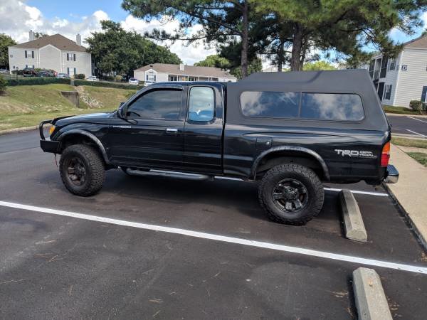

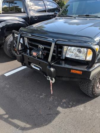

    Hey guys, I'm considering a 98 Tacoma for sale in my area and wondering what you think. I haven't gone to see it yet and am still waiting for the seller to respond to my question about rust as I've read that frame rust can be an issue with this generation. It's a manual transmission with V6.
    I attached a few pics and here's the title and body of the ad:
    1998 Toyota Tacoma 4x4 winch arb bumper - $8500
    179 k miles. This truck runs great no leaks . I had to get a bigger one due to my dogs.
    Old man emu 3" lift
    Cold air intake
    Arb bumper
    Kryptec Dipped fender flares rims rain visors
    Comes with camper

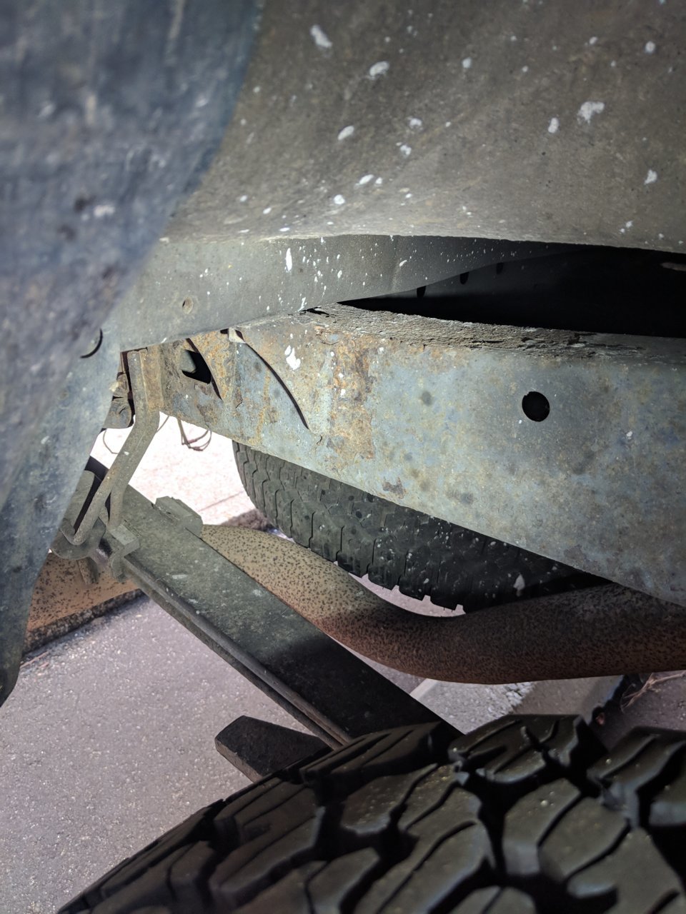

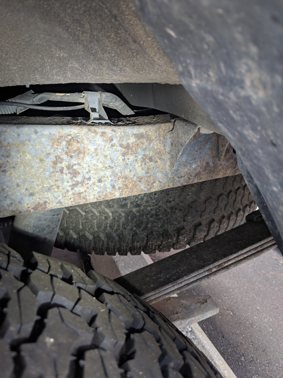

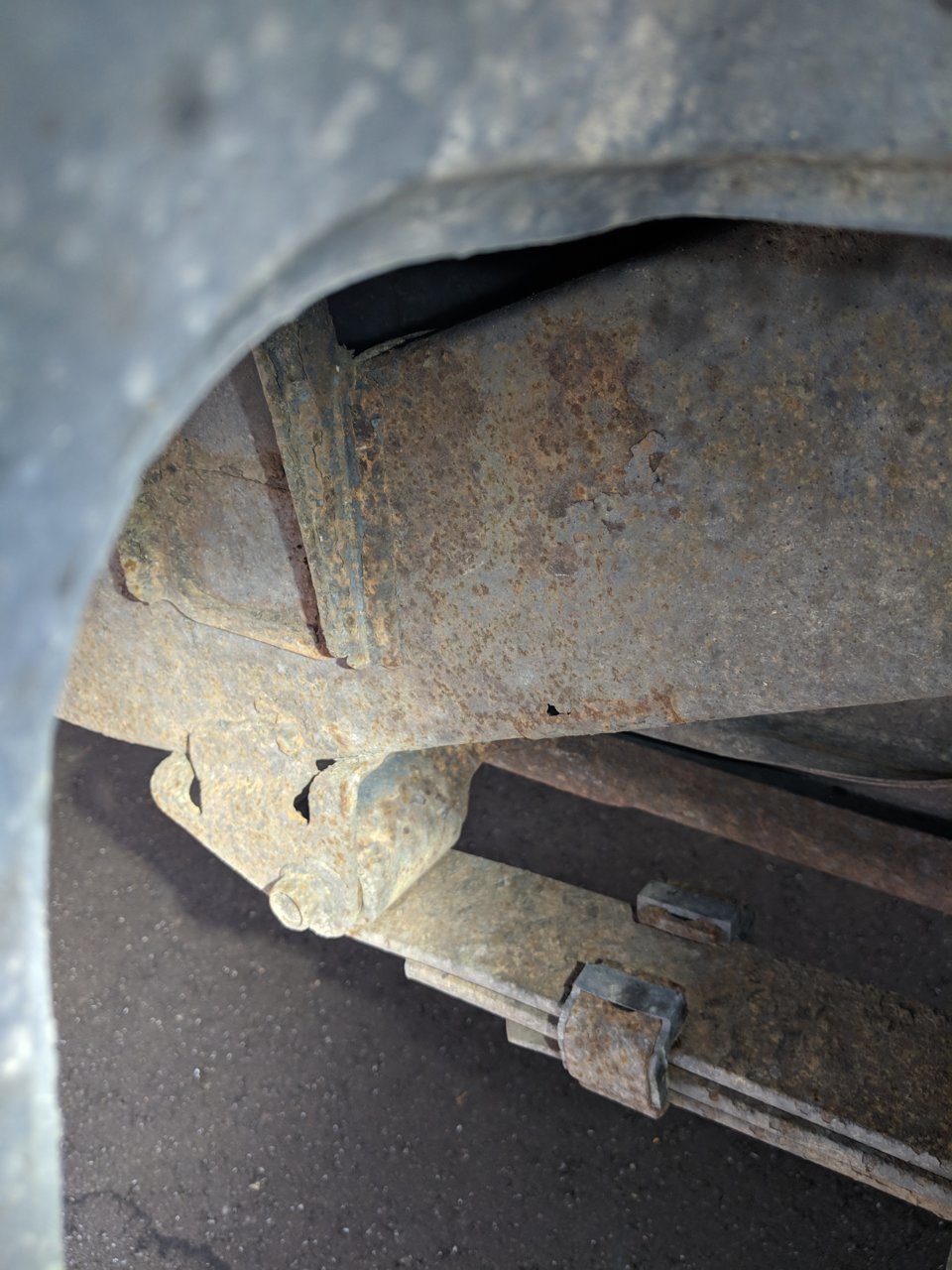

    Seller sent some photos of rust under the vehicle. What do you think? I'm most concerned about what appears to be a small hole in the 3rd pic.

    Ah yeah, I see that hole now. Nice catch.

    Yep, the frame is gone. 1998 - at this stage it is only a project truck.

    She's burnt
    Get one that's all stock with a nice frame

    Run. ruuuuuuun dude that frame is shot

    If you put your finger inside the rails where it’s boxed, it’s almost guaranteed to be flaking off big chunks of rust from the inside

    An those were the photos the seller was actually willing to send you, I can't image what the rest of the frame actually looks like in person!
