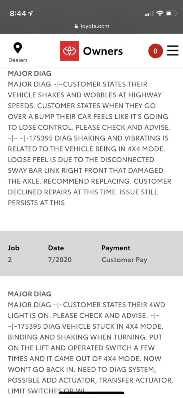

    I’m looking at a 2005 regular cab, 4 cyl, 4wd, manual with 180,000 miles on it. Frame was replaced 5 years/50,000 miles ago and appears to be in decent shape. Dealer is asking $9k, any opinions on whether or not this is a reasonable asking price?
    Also, it had an issue where it was stuck/put in 4wd and driven on pavement which caused damage to the front axle (according to service records). It seems to drive fine now aside from some drifting/misalignment in steering. Is there anything to look for to see if this has been properly repaired?

    Sorry, after rereading my posts, I’m not being clear enough.
    I looked at the service records on the Toyota owners website. There it was recorded that there were problems with the front axle and 4wd system. According to the records the previous owner declined repairs and presumably sold or traded in the vehicle to the Toyota dealer that performed the diagnostic service.
    It was then sold to a third party used car dealership that is listing it for sale. I am unsure if they were previously aware of this issue or not. They claim to have listed it shortly after receiving it and that all necessary repairs would be made prior to sale. However I contacted them about the issues noted in the service records and they said they would look in to it and later said they would be replacing the transfer case actuator.

    I honestly don’t know enough as to what the problem with 4wd is/was just that there is/was one. Personal mechanic is who said it would not shift out of 4lo until being turned of and back on. I’m confident he knows that the vehicle should be in neutral and stationary while shifting in/out of 4lo.
    What might the wandering steering potentially point to and why would it be a bigger issue?
    Service record pics:

    OP, buddy.
    The more I read, the more I would NOT buy this truck.
    The diagnosis was “Vibration due to being in 4WD and the axle was damaged by a disconnected Sway Bar link”
    Was the sway bar disconnected or broken?
    davidstacoma and Wattapunk like this.

    Ahhh. It sounds like the right sway bar link somehow came loose, at which point it probably dug into the CV. Likely tore a boot and lost all the grease inside.
    If the dealer you are buying from will replace the t-case actuator then that should be good to go. Have your personal mechanic go over it again real good. Make sure he sees the above notes and can confirm a new actuator, the sway bay is in working order, and that none of the CV boots are messed up.
