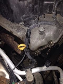

    Hi so i went and looked at an 06 tacoma tonight sr5 6 speed manual transmission but noticed it had some sweating going on from the valves not sure what to think of it? drove great and the guy said he just had an oil change and oil levels were not low at all but who knows right.. il post a pic with it here that i took i really like the truck but any feed back would be great things too look out for etc truck has 153,000 KM upload_2017-3-13_20-45-39.jpgupload_2017-3-13_20-45-39.jpg

    it's most likely the timing chain cover that is leaking it a known problem and pretty simple repair.

    Gasket leaks are NOT a big deal. Even SEAL leaks are fairly simple to deal with. The main oil loss situation that you really want to avoid, is hidden oil consumption. Oil consumption that hides inside the engine means that you need SERIOUS work, like valve stem seals (if you're lucky), or RINGS, or something horrible to that effect.

    Best way to tell if an engine is consuming oil internally is to examine the BODY near/behind the exhaust pipe and back of the vehicle. If it is dumping excess oil, it will have a film in those areas. IMO, highly unlikely on these engines, and nothing I'd be worried about, especially at just 153,000 km, while "old" chronologically, its still pretty new. Heck, my '11 is at 145,000.
    The one thing I can say, is that the 4.0 is known for having a few leaks, like that other guy suggested, probably just the timing cover.

    Yes probably timing cover leak but be aware unless you do this yourself it's not a cheap repair. Search this forum for that leak and you'll see some estimates at 1,000 + so keep that in mind. Good luck

    It's likely what others have mentioned, timing cover leaking. Your photos show the problem area, just above the power steering pump. My 2007 had the leak when I purchased it in 2010 with 60+K miles. It was a weep until July of this year, then turned into a hemorrhage with about 1qt/week (truck now has 145k. This was right after a frame swap. Took it back to the dealer (my independent mechanic didn't want anything to do with it) and they quoted me over $2500 to fix it as the whole front of the truck needs to be disassembled. There's a TSB for the know issue and I showed that to the service manager and shamed him into cutting me a break, but it still cost me over $1700. Unfortunately, the leak reappeared after only three months and it's now back at the dealer. The service advisor I'm working with just called me about an hour ago and gave me a song and dance about how they were investigating the source of the leak with colored dye and the technician feels it may be coming from some area other than the timing cover (sure, sure).
    My 2-cents; don't necessarily let it scare you away from buying the truck, just keep in mind that you may be staring at an expensive repair down the road.
