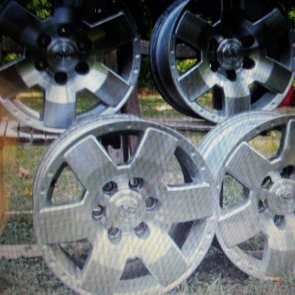

    I gotta 05 Tacoma ext. cab w/16x7 stock steel wheels w/ 285/75/16 tires that rub inside a lil when turned all the way.Truck has 3" lift. I'm buying 17" FJ rims. When I order new 17" tire do I need to get a lower profile tire? Or do FJ rims have enough offset to stay w/285/75/17 ? Buying all of this in morning. HELP .

    Both the stock steel wheels and the FJ alloys are the same +15mm offset, so a tire of the same width (285) will rub on both.
    You can install wheel spacers, but then the tire will start rubbing on the fender flare at full steer. You can start cutting away the plastic. The easier way out is to get 265/70-17 tires. No spacers. No rubbing. Some tires are available in 275/70-17 size, which would fit fine also.

    ^Stock 17" FJ alloys have +15 mm offset. Tacoma 16" TRD OR alloys have +32 mm offset. Tacoma 16" SR5 steel wheels have +15 mm offset. Numerically higher offset value = wheel is set further inward.
    To get a wider stance, you'd want wheels with 0 mm offset or negative offset, but then the wheel and tire will be steering over a larger scrub radius, so fender clearance becomes an issue. With larger tire sizes, even cutting away all the fender flare plastic will not be enough - a cab mount chop (CMC) becomes necessary.
